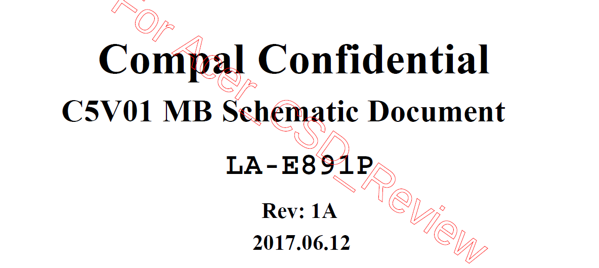

      I dont have a variable power supply. Im checking the resistance on the caps and I'm finding a bunch that appear shorted. I assume its all caused by a single short? Are there any schematics for this motherboard? I found one that was supposed to be for this but it was off by one number.

        ACER C5V01 LA-E891P schematic & boardview - Badcaps
        Bear in mind that a low voltage rail (ie. GPU / CPU) will be a low resistance to ground by design. Confirm any such parts before dismantling. The parts you are suspecting may be ok as-is.

          That link is labeled wrong. Inside is schematics for LA-E892P

            The schematics are correctly posted by the boardview files are for the LA-E892P.

              Im confused. I have a LA-E891P and the link says LA-E891P but its LA-E892P inside

                There are 2 links in post #1. First is the schematic PDF link which is accurate. See below.
                Next is the boardview file which offers the wrong boardview files.
