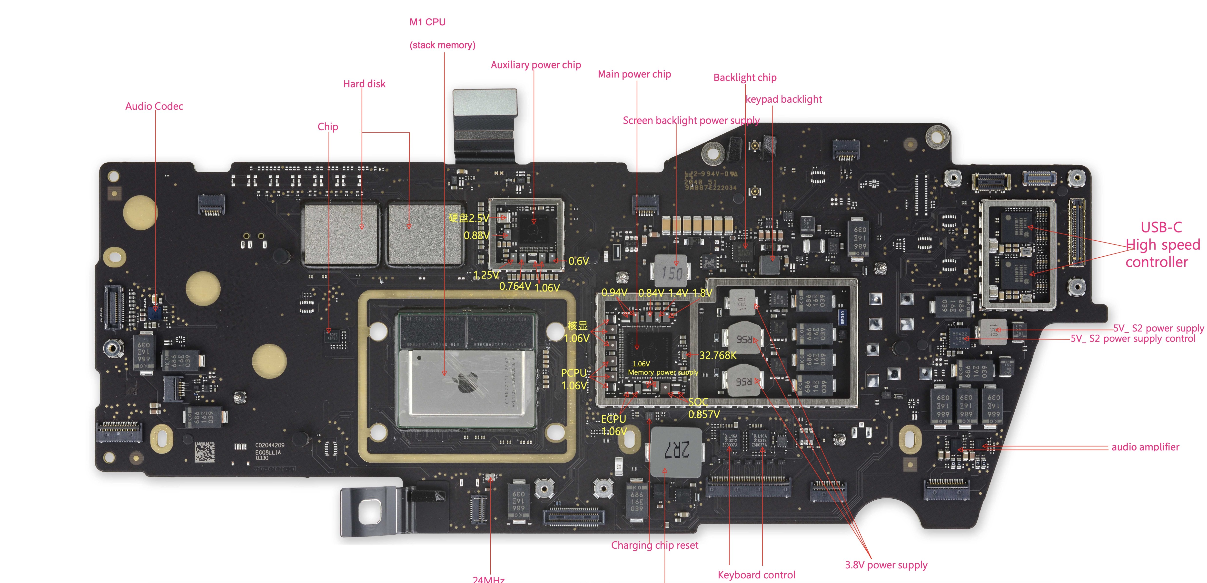

    Can you help me to do a correct diagnose of main voltage rails (AON and others),to track down the issues?
    i have tools boardview and schematics so i can do measures no problem,
    i know that i can do that and learn with your help,

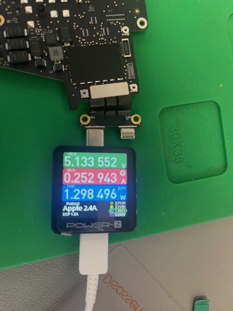

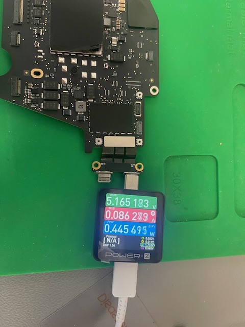

    i attach pics of the two usb-c ports that are drawing different currents at 5v(stable and not floating up and down).

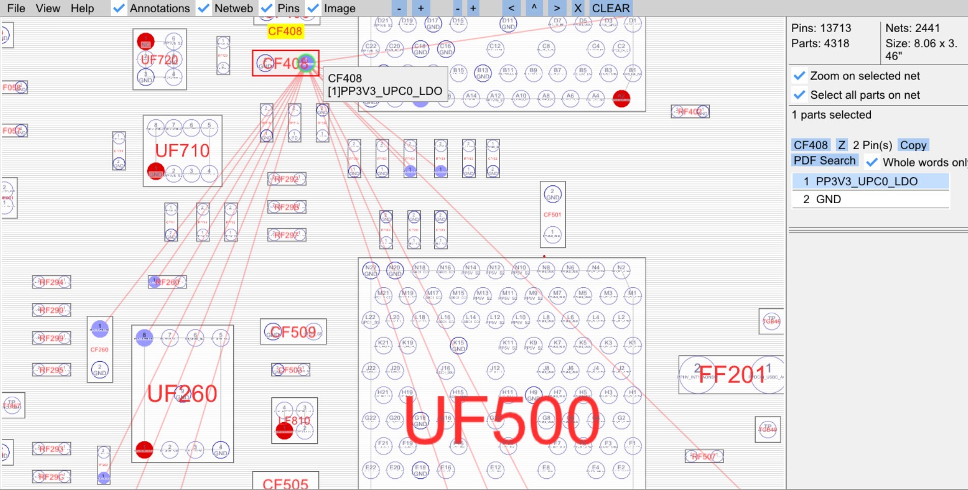

    I found this cap near UF400 that is almost short in diode mode,it reads 0,0046v(those caps nearby reads ok in diode mode CF409 CF405 CF505 CF508 CF509,they reads all about 0,500v ).

      Flux and carefully remove this cap. Then test the pcb pads without power if the short is gone. Test the logic again with your power adapter.
      • reformatt
        • Feb 2020
        • 1463
        Openboarddata for that cap lists diode mode as 0.5V. It's an internally generated 3.3V LDO rail from the CD3217 so with any luck it's a shorted cap on that rail (e.g. CF408 or CF260). Other components from this rail are resistors or the EEPROM UF260.
        From experience with the T2 machines, the T2 power sequence stops when one of the CD3217's isn't talking. M1 should be the same.

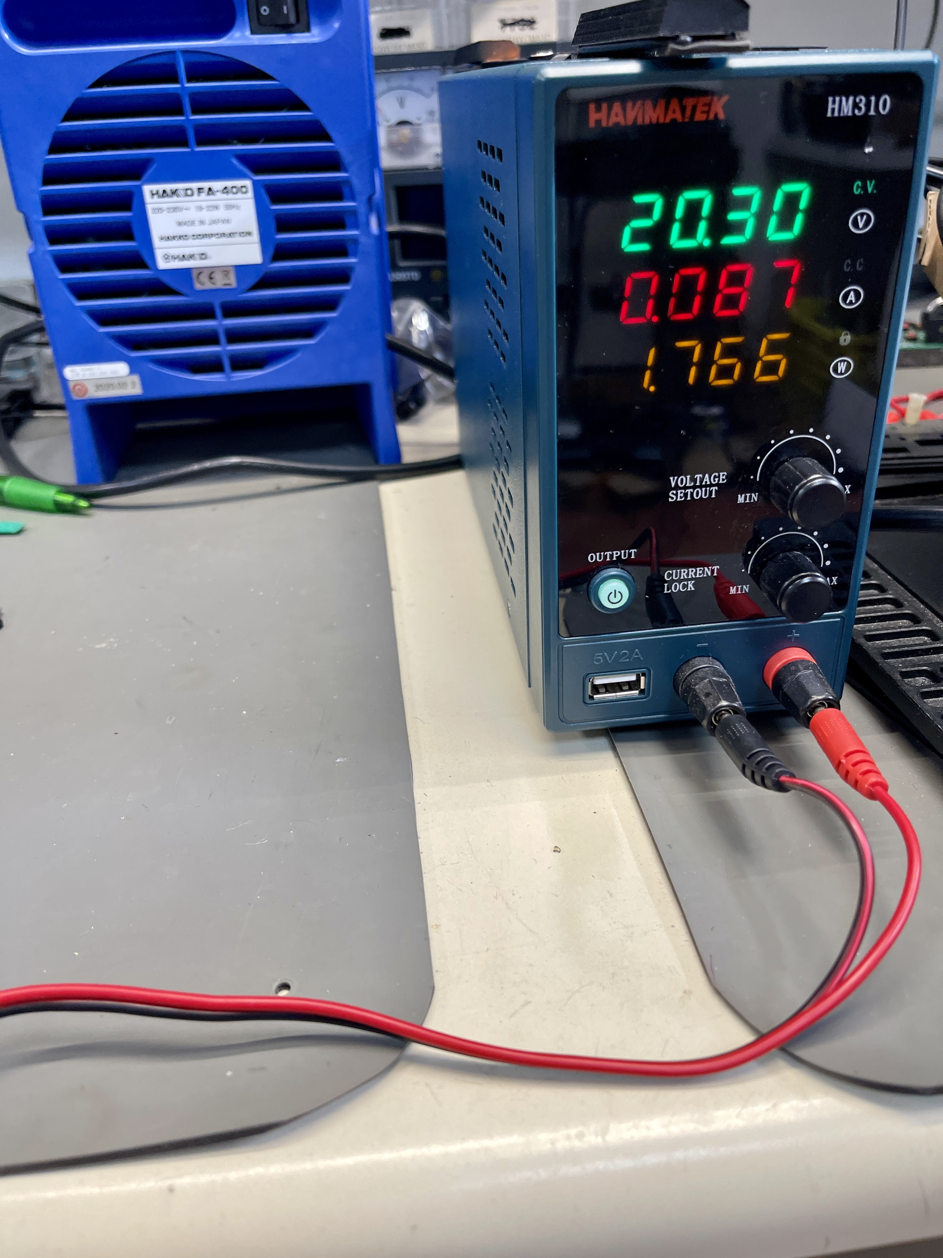

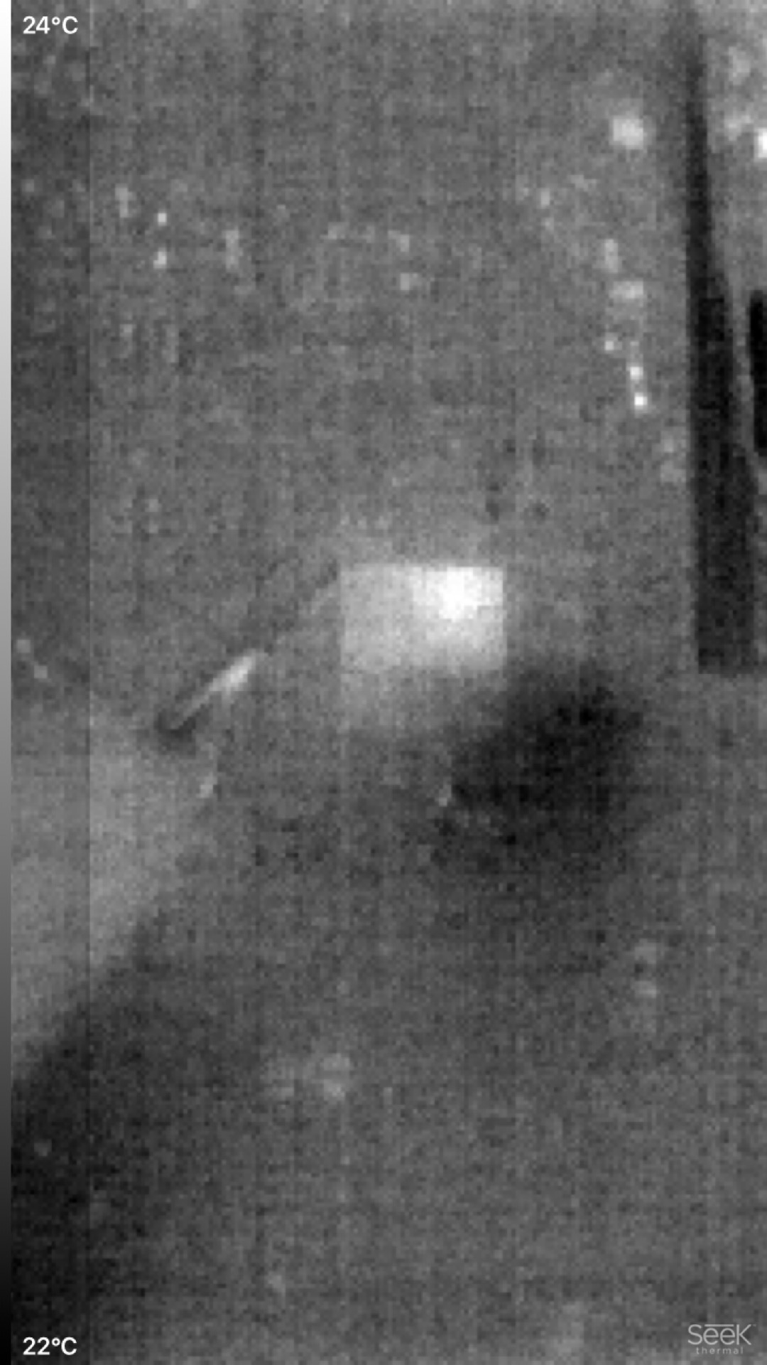

                  Ok it seems that UF400 is heat up in the left upper part of the chip,it does not draw much current,power supply set at 1V 1A,it only drops voltage from 1v to 0,8v and heats up,but i’m not 100%sure because i use a shortkiller and current is pulsating injected due to avoid short damage,but something is really going on that chip
                  • mon2
                    • Dec 2019
                    • 14631
                    The current setting for the injection tool is low. We also have the shortkiller but it can spike upto 20A / 30A varying with the purchased model. Allow this tool to support higher current then you will know for sure. The suspect is with this power delivery controller. Be sure to review how to purchase a spare of this part because being a more recent model of the logic board, there are many restrictions on which exact part can be used onboard. From my understanding, you need to be sure the part is from a donor board of the same model for starters.

                                Good day,actually i’m using this setup to power on logic board,DC power supply set on 20v 3A,and BY-3200 power cable.
