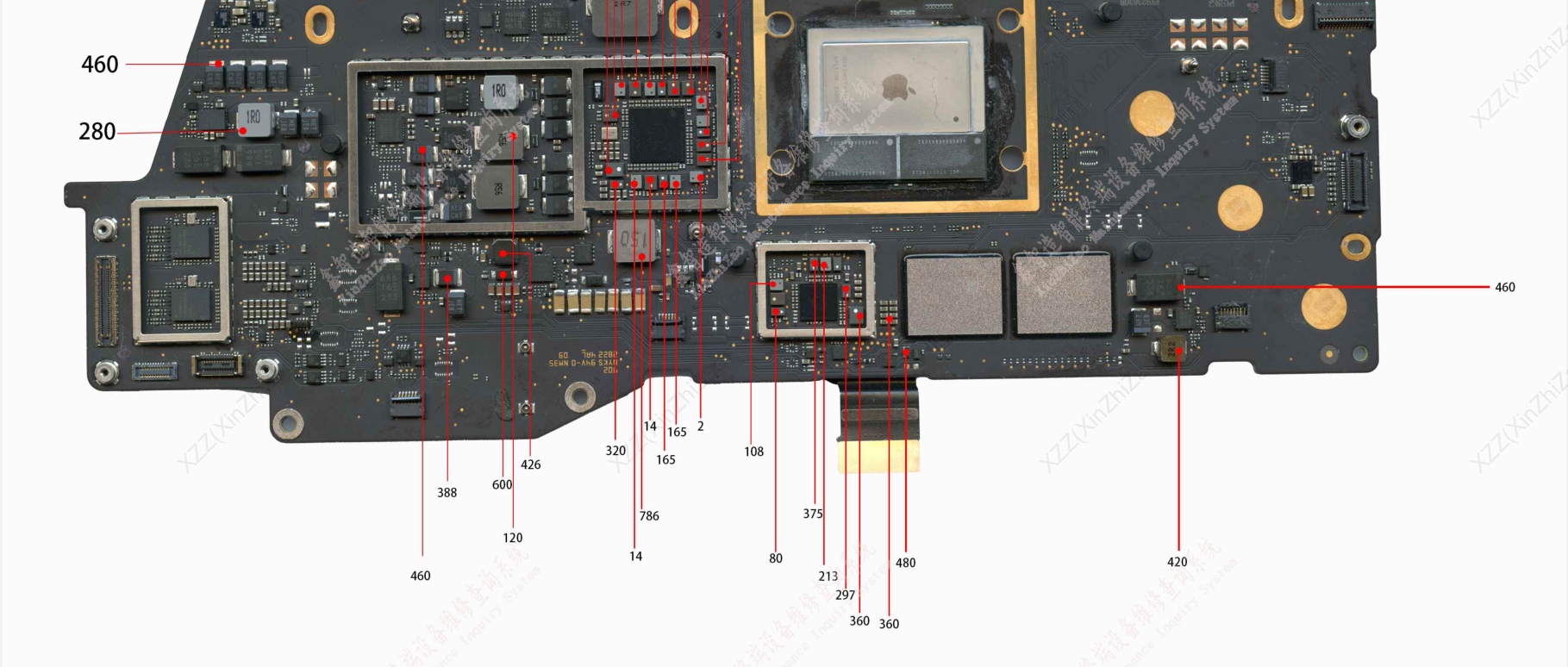

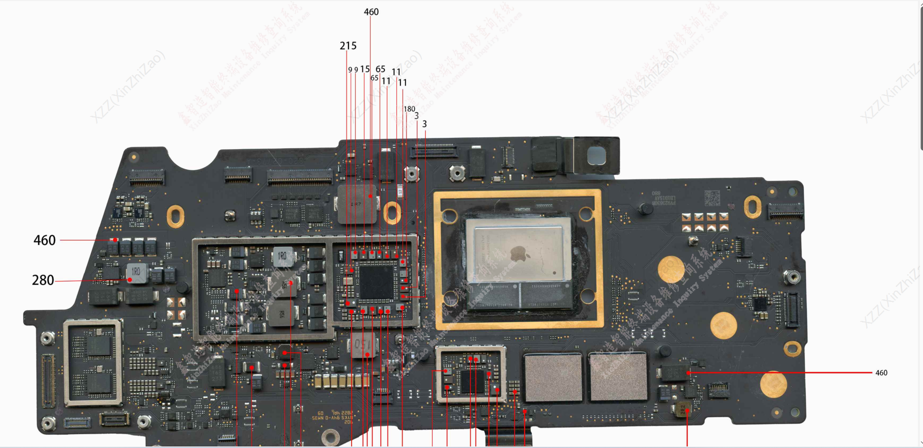

              What is the current status of this box? What is the USB Type C voltage? Current draw? Is the voltage stable or power looping?
              Compare the diode values against the following.
              • Mabot17
                • Mar 2023
                • 47
                • ITALY
                My Board has a different layout,can’t compare diode mode values,but mine seems all good,the problem could be the cd3217 that i have replaced that is a new one and not compatible,the short is gone and now i have 5v and about 190mA on both usb-c ports(stable).
