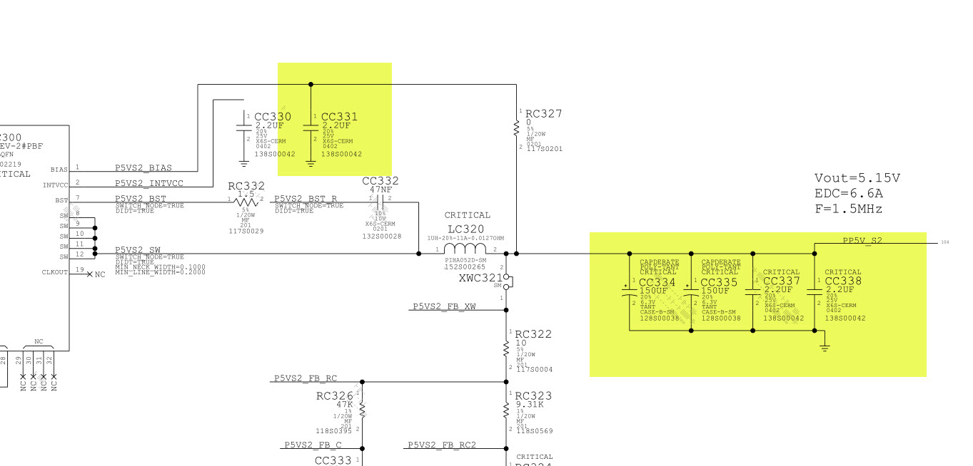

    I bought a waterdamaged macbook pro A2338 , late 2020 EMC 3578, its stuck at 5V 0,06mA.
    The 3V8 (U5700) chip is shorted out, atleast the PPBUS_VMAIN_VIN_ISNS Cap is and a bunch of resistors. It also seems that a resistor is missing. Does anyone have a boardview to tell me wich resistor goes where arround the U5700?
    And for the macbook to boot it requiers 20V am I right? Wich chip tells the charger that it is a Macbook and not a phone?
    Thank you so much!

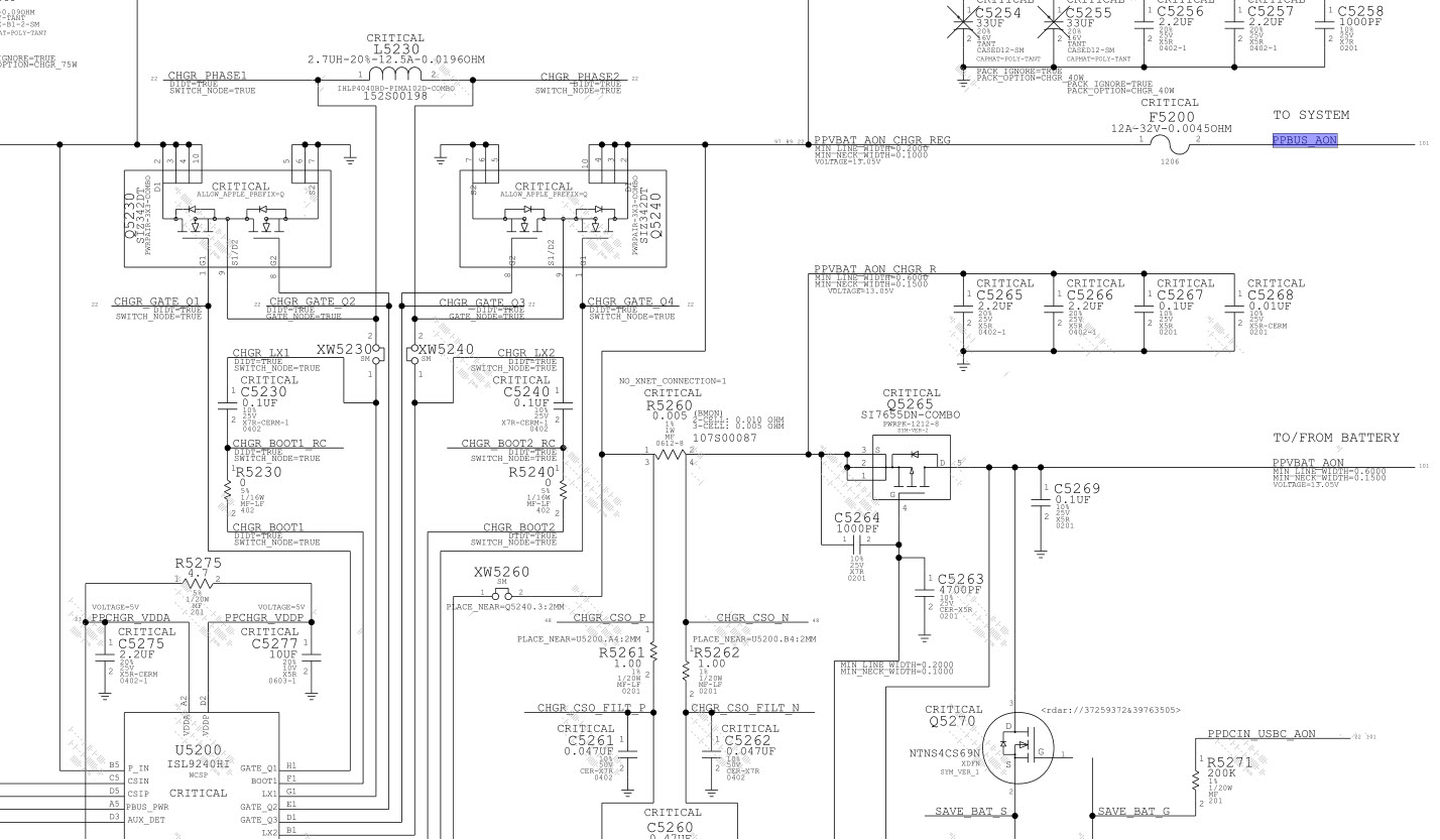

    Q: What is the voltage @ PPBUS_AON before and after F5200 (fuse) ?
    For now, U5200 will take in 5V and BOOST the voltage to create PPBUS_AON.
    Once 20V is supplied by the external power adapter, then U5200 will act like a buck regulator (high input voltage to a low output voltage) and supply again the PPBUS_AON rail.

      I measured 5V1 on F5200 both after and before the fuse.
      CC331, C7742-C7746 al measure 4 ohms to ground. I guess there are many more shorts in this circuit. Allthough the damage is nearly invisble I hope U7700 is still healthy.
      I'll try and look for a short around U7700. Same for UC300.

        Re: Macbook pro 13'' A2338 late 2020 stuck at 5V
        Start slowly to locate the source of the shorts.
        See attached.
        If you remove RC327 (0201 = tons of fun). Where is the short now ?
        Is it on CC331 or AFTER the RC327 part you just removed ?
        My bet is on the downstream bulk caps as per attached.

          It's going to be a challange. As I was measuring, CC333 just crumbled to dust. RC327 seems fine. I do have to check if the removal of RC327 clears the short on the caps. Bulkcaps CC335 and CC334 measure 4 Ohms. I reflowed UC300, didnt remove the short on CC331. I say short but I measure 4 Ohms over CC331.

          To get back to your first few questions:
          F5200 measures 12v both before and after the fuse. I confused it with FF200. UF400 and UF500 both get 5V1 and CF405 gives me a clear 1V5. CF505 however measure wierd, voltages vary between 0,300/0,155.
