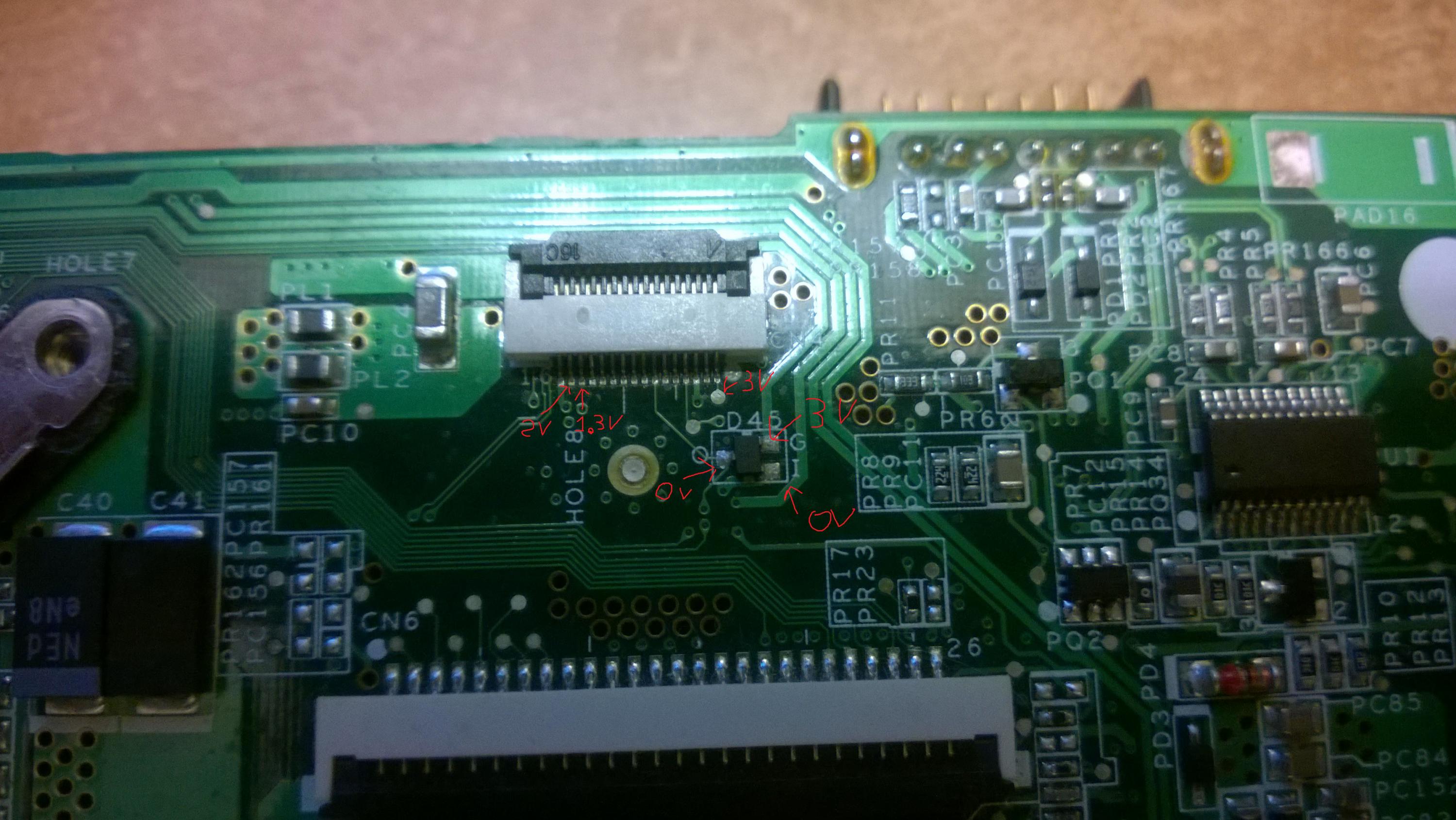

    yes, pin 95 0 volt also without power botton
    edit: make a wire connection from d45 to pin 95 ?
      #42
      Re: acer 5920g
      I think you've got the pin count wrong (D45)...doesn't make any sense...
      Could you post a pic with readings???
        Absolutely not...
        I'm not sure if you understood me...
        Measure the voltages without the power board...I mean disconnect it from mobo...actually disconect everything except charger / adapter...

          here it is
            #45
            Re: acer 5920g
            here it is
            ANd PIN95 @ U10 is 0V...Without pressing anything???
            If so..check the resistance of PIN95....
              #46
              Re: acer 5920g
              I'm not gonna do any final conclusion...But there's another signal related to South / ICH...Basically this mobo has pwr on & 2nd pwr on signal, which is basically kind of "instant boot"...The problem may lay there as well...

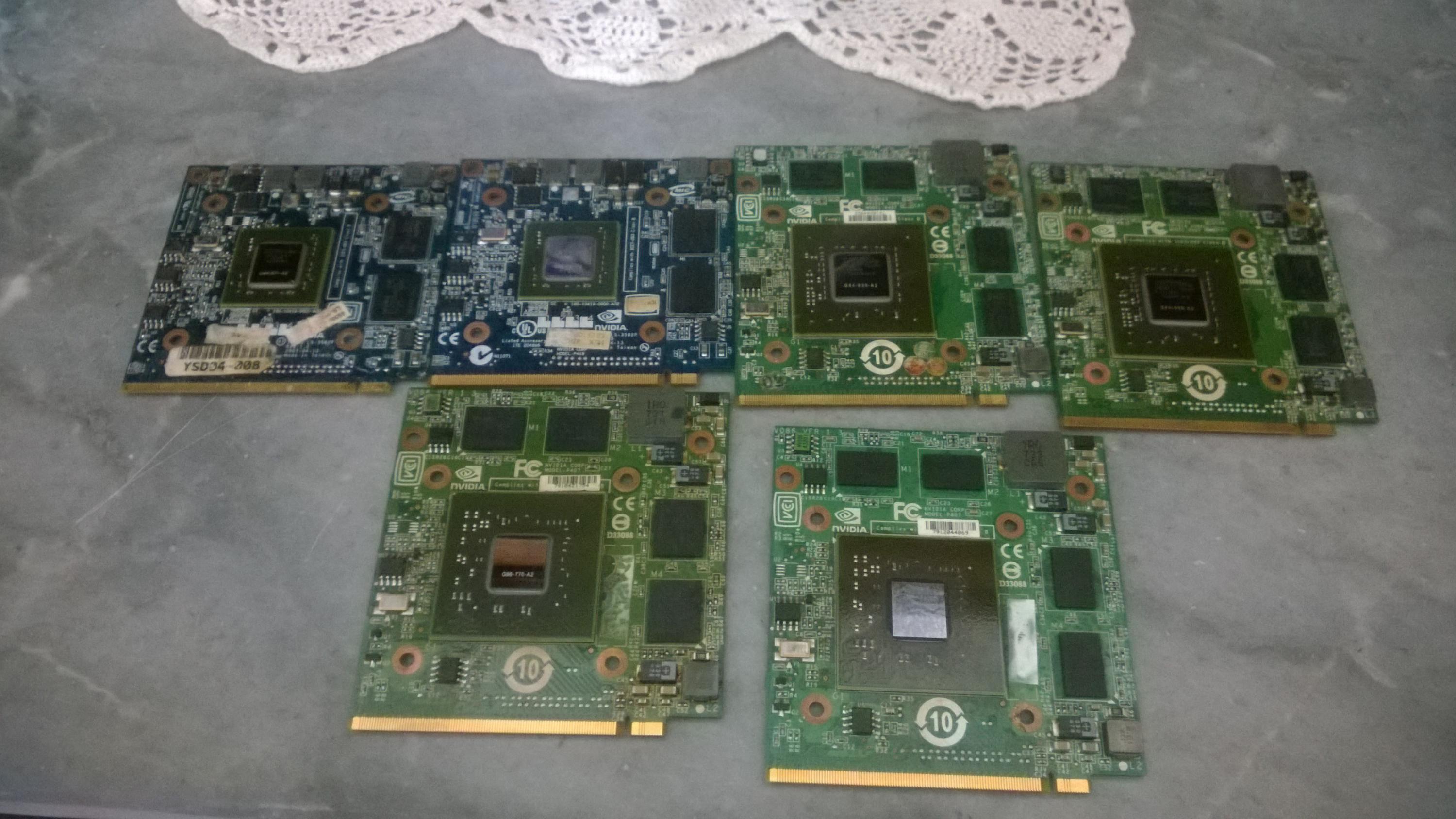

                in 2011 i had 2 notebooks like this with mxm video cards.
                one no display and one like this.
                on one was the video and the other the mobo.
                the video and the motherboard got to meet my OVEN friend
                apparently the one with mxm problem died after 6 months and we did it again and the other its still running

                  i havent put any mxm card, because first notebook should power on at least......

                        i've done some mxm and now waiting this 5920g to test all of them
