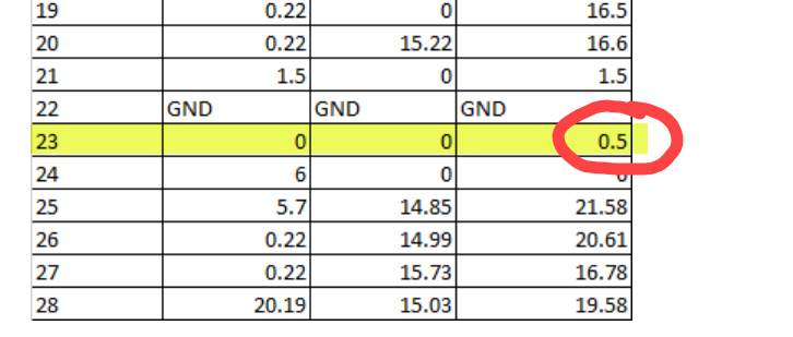

    Originally posted by mon2
    Can you confirm the gate voltage of PQ5407 WITH battery & power adapter? It does not look right.
    Click image for larger versionName:	gate_voltage.pngViews:	0Size:	50.3 KBID:	3306120
    A few other points:
    1) remove all power -> measure the resistance of the 4k resistor @ PR5405. Confirm this resistor matches the schematic value of 4k. Concern is that in your measurements, the CMSRC voltage to ground is lower than the power adapter voltage.
    2) double check the BATTERY only measurement for pins 1 & 2 on the charger IC.
    3) repeat the measurements WITH BATTERY & power adapter for pins 1 & 2 on the charger IC. Pin # 2 (ACP) should be a higher voltage than pin # 1 (ACN). In either case, the voltage measurements should be very close to each other. Note the voltage drop across ACP and ACN junction when using only the power adapter. Higher voltage difference when the battery is used or when both battery & power adapter is used.
    With no power to the board and no battery, confirm the resistance from pin # 2 (ACP) directly on the charger IC to the current sense resistor @ PR5401. Then repeat the same test with pin # 1 to the same current sense resistor. Both checks should be ~0 ohms. Touch your meter probes together and this is the same resistance measurement you should have for this current sense resistor path.
    Also, I think that for the BATTERY only, the pin # 19 measurement was missed in the above table. It should be the same voltage as pin # 20.
    Rectify the voltages on pin 23 gate of PQ5407 and it is still 0.5 with battery+charger, rectify the battery and charger alone and it is still 0V.
    Rectify measurement in PR5405 and it is 3.99Kohms
    Rectify measurement on pins 1 and 2 only with battery connected, they remain at 15.5 on both pins
    -battery+charger 20.4 on both pins 1 and 2
    measurement pin 1 and 2 with respect to PR5401 in both cases was 0.6 ohms
    I correct the measurement on pin 19 only with 15.74V battery pin 19 and 20​

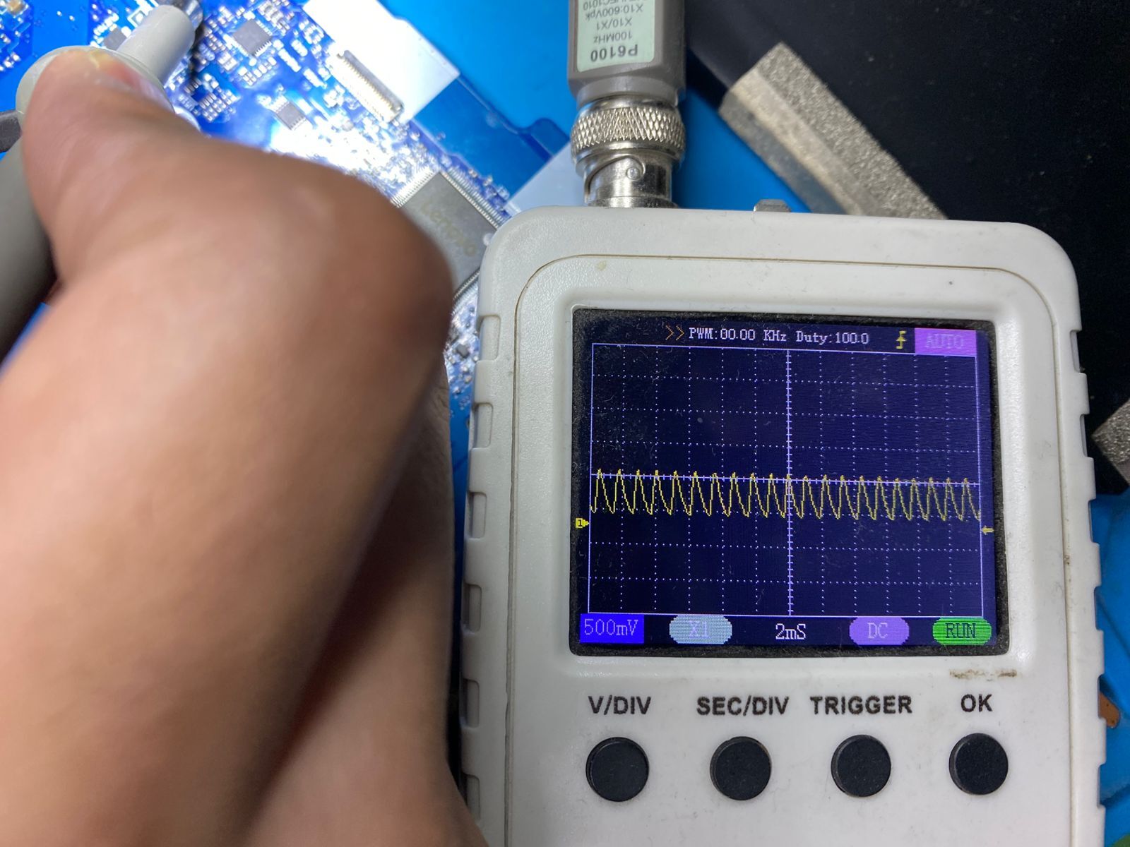

      Update: bought a small oscilloscope to take the reading of pin 23 for PQ5407 attached a photo
      I did the readings with and without battery and the result was 0​
      • judamex
        Active Member
        • Jan 2021
        • 186
        • Mexico
        Update 2:
        Check the measurements regarding this video
        (https://www.youtube.com/watch?v=ODcc...LaV0BS&index=7) in diode mode and everything is fine except PIN 17 with a value in the video of 0.6622 and on my motherboard it is 0.501. It is the only difference I noticed, everything else is fine with respect to ground (RED ground, BLACK to the IC pins)
        Or what oscilloscope measurements can I take?​

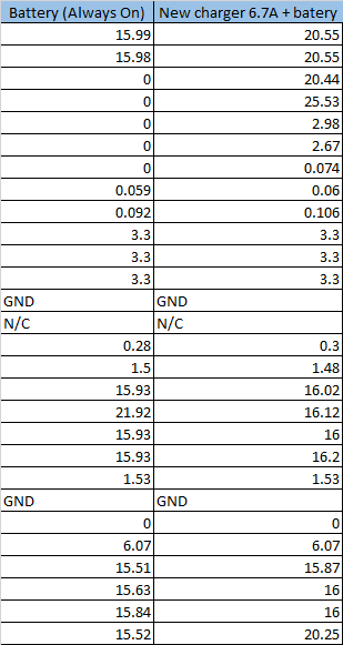

                  I took the following measurements with the new battery connected just in case, I noticed several details that may be important:
                  1- the motherboard restarted after several seconds, it did not turn off completely, it just restarted
                  2- a strange oscillation in the ACDET, it only did it once and then showed stable voltage​
                  New Batery + Charger
                  20.36
                  20.25
                  20.17
                  25.26
                  25.27
                  2.98
                  0.31
                  0.011
                  0.113
                  3.32
                  3.3
                  3.3
                  GND
                  N/C
                  0.31
                  1.48
                  16.37
                  16.26
                  16.35
                  16.39
                  1.53
                  GND
                  0.58
                  6.06
                  21.33
                  20.24
                  16.49
                  19.55
                  • mon2
                    • Dec 2019
                    • 14802
                    #29
                    Power down immediately. ACOK pin #5 should never be so high of a voltage. It appears to be shorted to the ACDRV pin #4.
                    Flux the ic well and reflow it and gently nudge the chip with tweezers to remove the short condition. This event can cause damage.
                    Double check your work with the meter to confirm the short is removed.

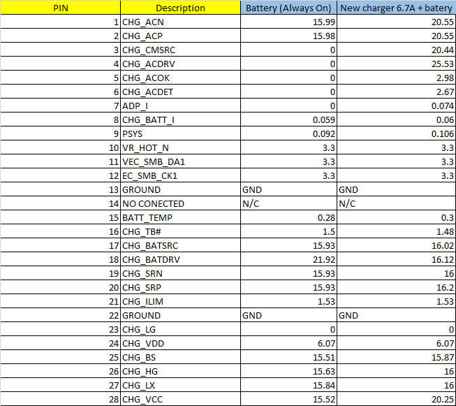

                              • judamex
                                Active Member
                                • Jan 2021
                                • 186
                                • Mexico
                                #35
                                The above table of measurements should really have pin #s and also the same pin labels as used by the datasheet for the charger IC. It will make the review much easier to study.
                                Not sure what the GND followed by N/C means. Best to repost with the latest values.
                                What is the voltage to ground of pin # 15 = BATPRES# on the charger IC? This is a critical voltage that should be a logic low = '0' = 0 volts to denote that the battery is attached.
                                You may have other charger IC pins shorted but will review with a fresh table of measurements with pin #s and pin labels.
                                Sorry for not indicating the number of pins, I update the table with the number of pins and their description based on the boardview of the motherboard, the charging IC corresponds to the BQ24780S
                                • mon2
                                  • Dec 2019
                                  • 14802
                                  #36
                                  Much cleaner. Thanks.
                                  Concerned about the gate voltage of the battery charge (PQ5404 & PQ5406) and also the battery mosfet (PQ5403). Each is a suspect.
                                  We know that the battery voltage is the voltage at pin #27 (CHG_LX) = 16 volts. For the battery to power the logic board, the battery mosfet gate voltage @ PQ5403 should be boosted to enable this N-channel mosfet. Yet, this gate voltage is the same voltage as on the source pins.
                                  Remove the power adapter. Connect only the battery. What is the voltage to ground of the drain pins on PQ5403 = main power rail to the logic board?
                                  In this condition, the drain pins should be ~16 volts and the laptop should function ok.
                                  To fully turn on PQ5403, the gate voltage needs to be boosted.
