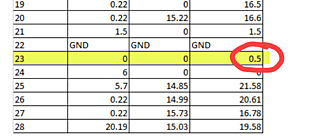

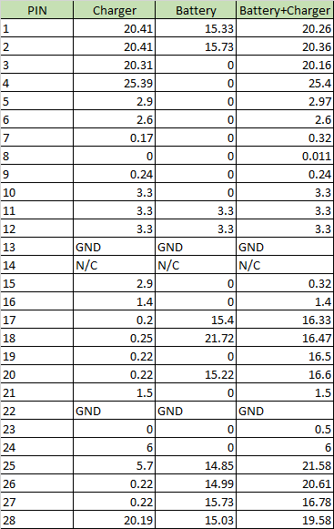

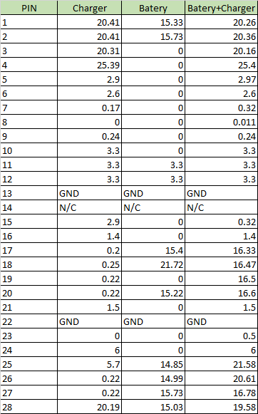

                                      I performed the following measurements, noticing several details, such as that only with the battery connected the equipment stayed on for no more than 40 seconds.
                                      Take 3 different measurements that appear in the table, only with charger (on), only with battery (off), and with battery+charger (On)
                                      If any of these measures do not help me, I will have to call the priest himself.

                                        Can you confirm the gate voltage of PQ5407 WITH battery & power adapter? It does not look right.
                                        Click image for larger versionName:	gate_voltage.pngViews:	0Size:	50.3 KBID:	3306120
                                        A few other points:
                                        1) remove all power -> measure the resistance of the 4k resistor @ PR5405. Confirm this resistor matches the schematic value of 4k. Concern is that in your measurements, the CMSRC voltage to ground is lower than the power adapter voltage.
                                        2) double check the BATTERY only measurement for pins 1 & 2 on the charger IC.
                                        3) repeat the measurements WITH BATTERY & power adapter for pins 1 & 2 on the charger IC. Pin # 2 (ACP) should be a higher voltage than pin # 1 (ACN). In either case, the voltage measurements should be very close to each other. Note the voltage drop across ACP and ACN junction when using only the power adapter. Higher voltage difference when the battery is used or when both battery & power adapter is used.
                                        With no power to the board and no battery, confirm the resistance from pin # 2 (ACP) directly on the charger IC to the current sense resistor @ PR5401. Then repeat the same test with pin # 1 to the same current sense resistor. Both checks should be ~0 ohms. Touch your meter probes together and this is the same resistance measurement you should have for this current sense resistor path.
                                        Also, I think that for the BATTERY only, the pin # 19 measurement was missed in the above table. It should be the same voltage as pin # 20.
