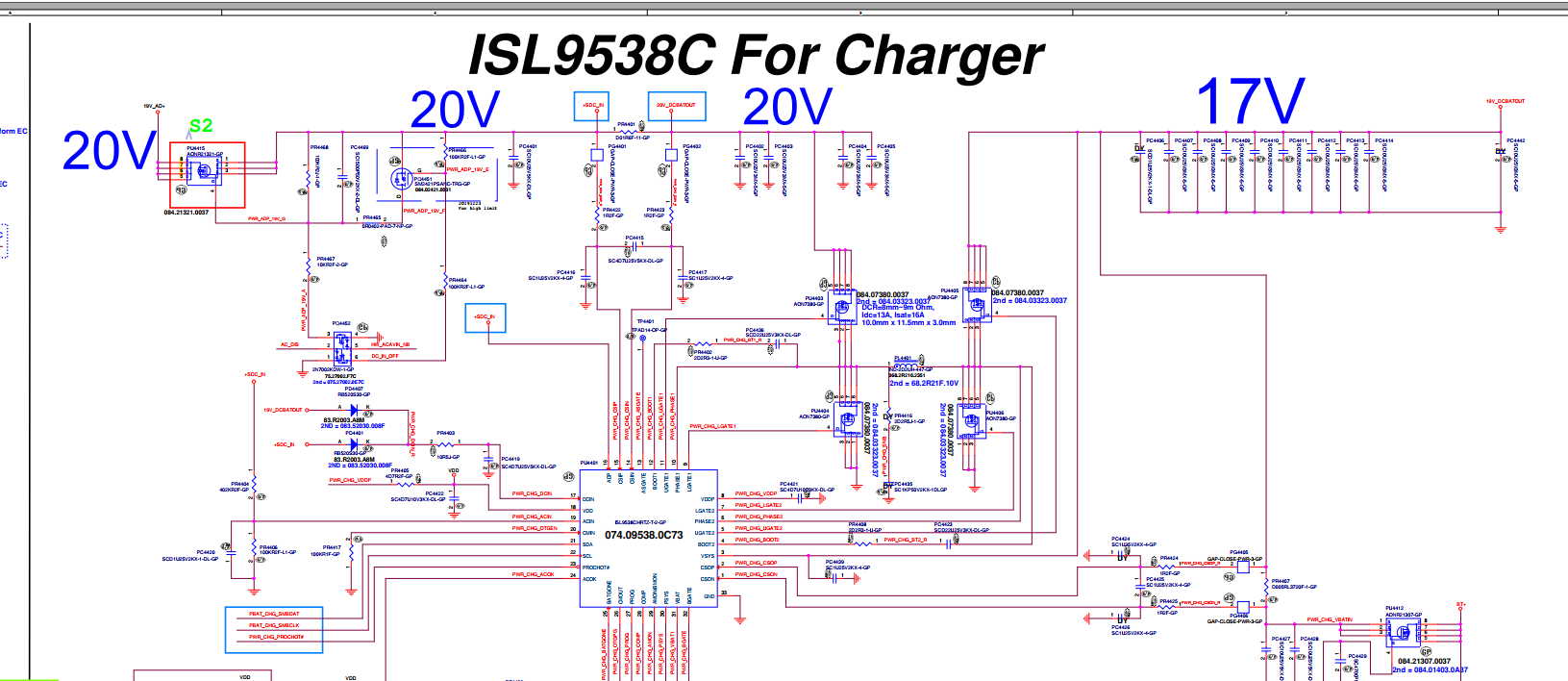

    Hello!
    I'm a new user here. I wish I can collaborate in the future and not only seek advice. I revive this thread as it is the exact model I have and I've downloaded the schematics. Huge Thanks for that!
    My laptop is 99.9% dead: When I plug the AC cable the LED turns white for a few ms then goes out.
    If I press the power button, the LED turns amber for as long as I keep the button pressed.
    Below are my voltages with the AC charger plugged in, the only 'weird' value is 19V_DCBATTOUT which is around 17V.
    Other tests I've done:
    ACOK pin is 3.3V
    Nothing gets hot on the thermal camera, just the ISL9538C increases a couple of degrees when pressing the power button but I can't see anything else of relevance.
    BIOS chips, U2501 and U2503. They get 3.3V VCC voltage. But I don't see any SPI activity (SCK, DI, DO, CS) even when I press the power button.
    Is my CPU dead, doctor?

      A little update.
      I do see BIOS activity, but only when the charger is connected. Not when the power button is pressed.
      I will try to perform BIOS dump to see if somehow is corrupted.
