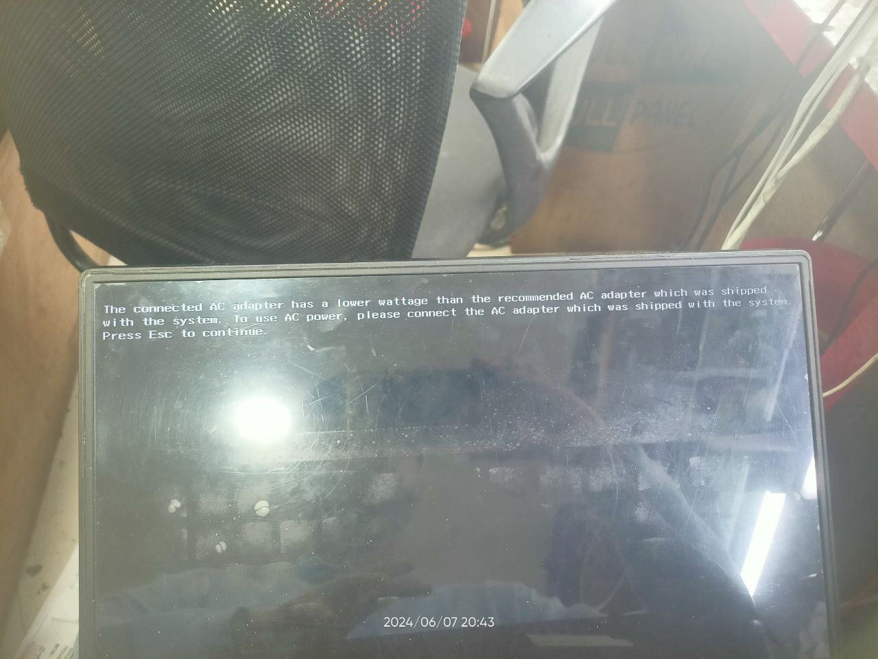

    i have a legion board nm-c221 rev 2.0
    if i connect 170w charger laptop will on and 135w charger laptop wont turn on whats the problem
    i check adp_id is ok i changed i/o
    here is messge

    Use 170W or higher power adapter for this model. Internet is showing this model requires a hefty power adapter.

      thanks for reply this laptop supported 220w adapter
