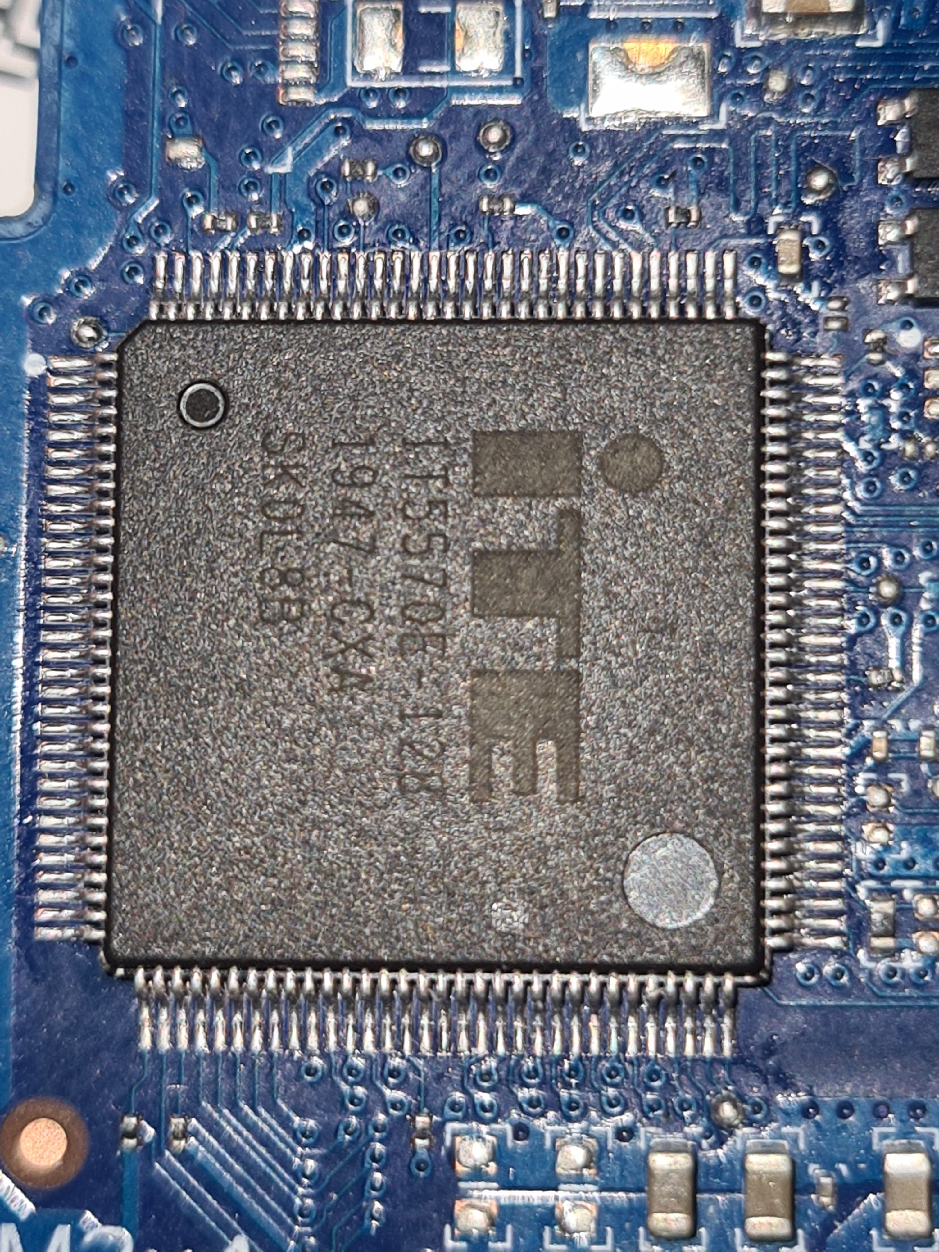

    So this is why the computer won't turn on? Are you sure this is the source of the problem? Can I measure it somehow?
    • mon2
      • Dec 2019
      • 14153
      Certainly do wait for feedback from other techs but to me, this IC is defective. It is deformity that is not present on a normal IC and often indicates that a transient went through this device -> caused internal damage to the semiconductor die and the same pressure caused the packaging to bubble up. Also, moisture combined with rapid heat can also cause such micro cracks / bubbles which in the PCB production world is named as 'popcorning'. This is a key reason that parts are gently baked before mounting through SMD ovens and that is to draw out or bake out the moisture.
      Can also be caused by reflowing with a hot air tool with too high of a temp and heating of the component at a too high rate. The moisture expands on the inside and as no escape.

        That can't be a popcorn effect as there is no BGA die on a substrate, the popcorn name refers i guess to the tin balls that pops out the side glue between substrate and bga die..
        to the O.P., scratch it away and see if a hole remains or is only a rosin drop.. bye

          Thank you for the responses so far. I scraped it, and I don't see a hole anywhere.
