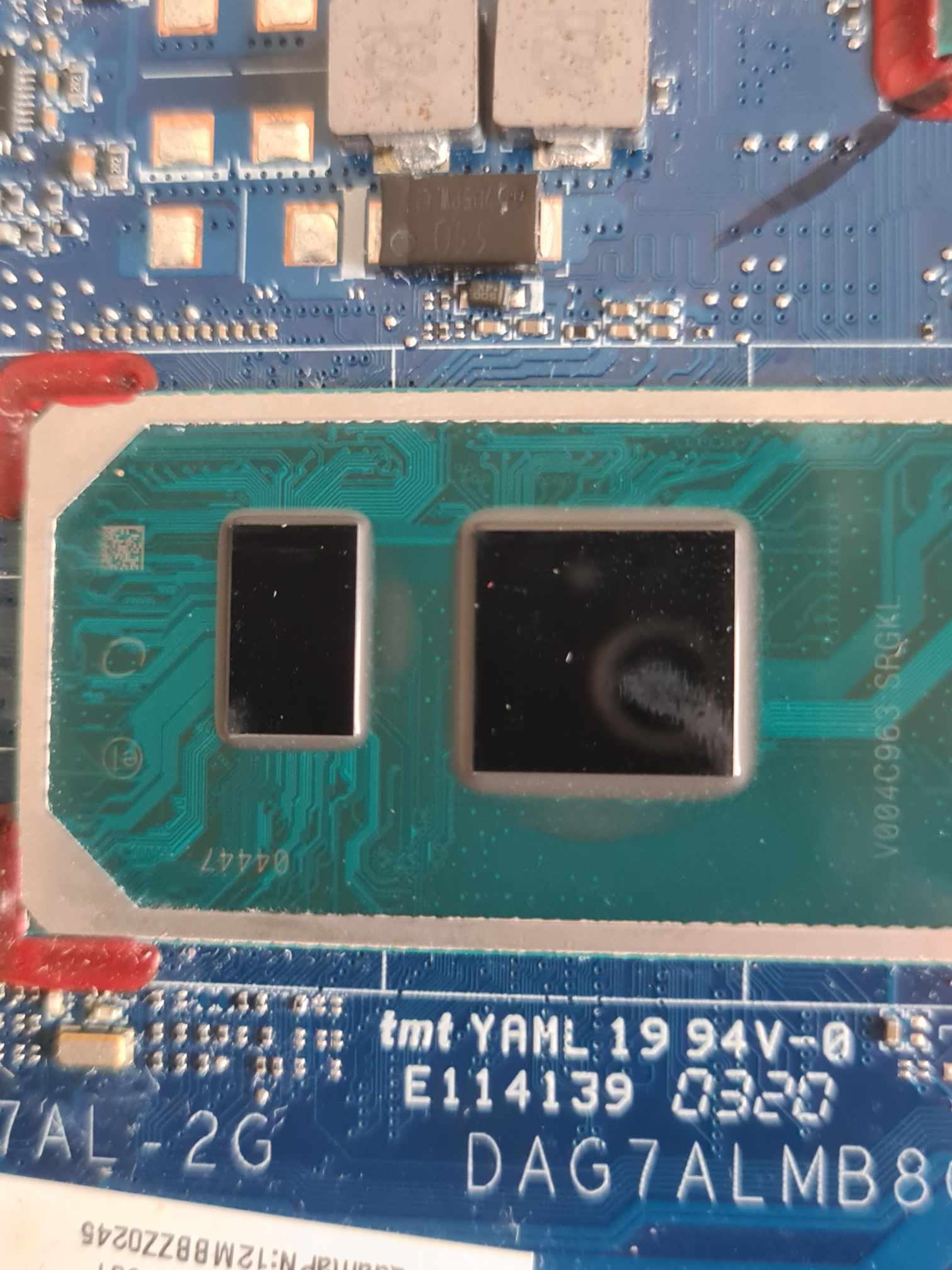

Heats comes from the smaller Die/Crystal?
Hp pavilion 14 - No display
Either way, what heats up is the culprit of the short circuit. So it's probably a dead end here, except you find something else heating up.Comment
Thanks for the help.
Unfortunately, I don't have a thermal camera yet, but I will invest in one, and then I'll take a closer look, processor overheating doesn't seem to be a short circuit the low current consumption suggests something else. Of course, the processor could be faulty even without a short circuit. It's very difficult to tell.
For now, I'll set this notebook aside and continue later when I have the proper equipment.
Thank you all for your help!!
Whenever there is short circuit on 1V/1.8V/2.5V rail,its usually the SOC. rarely you get lucky finding a shorted cap.Comment
