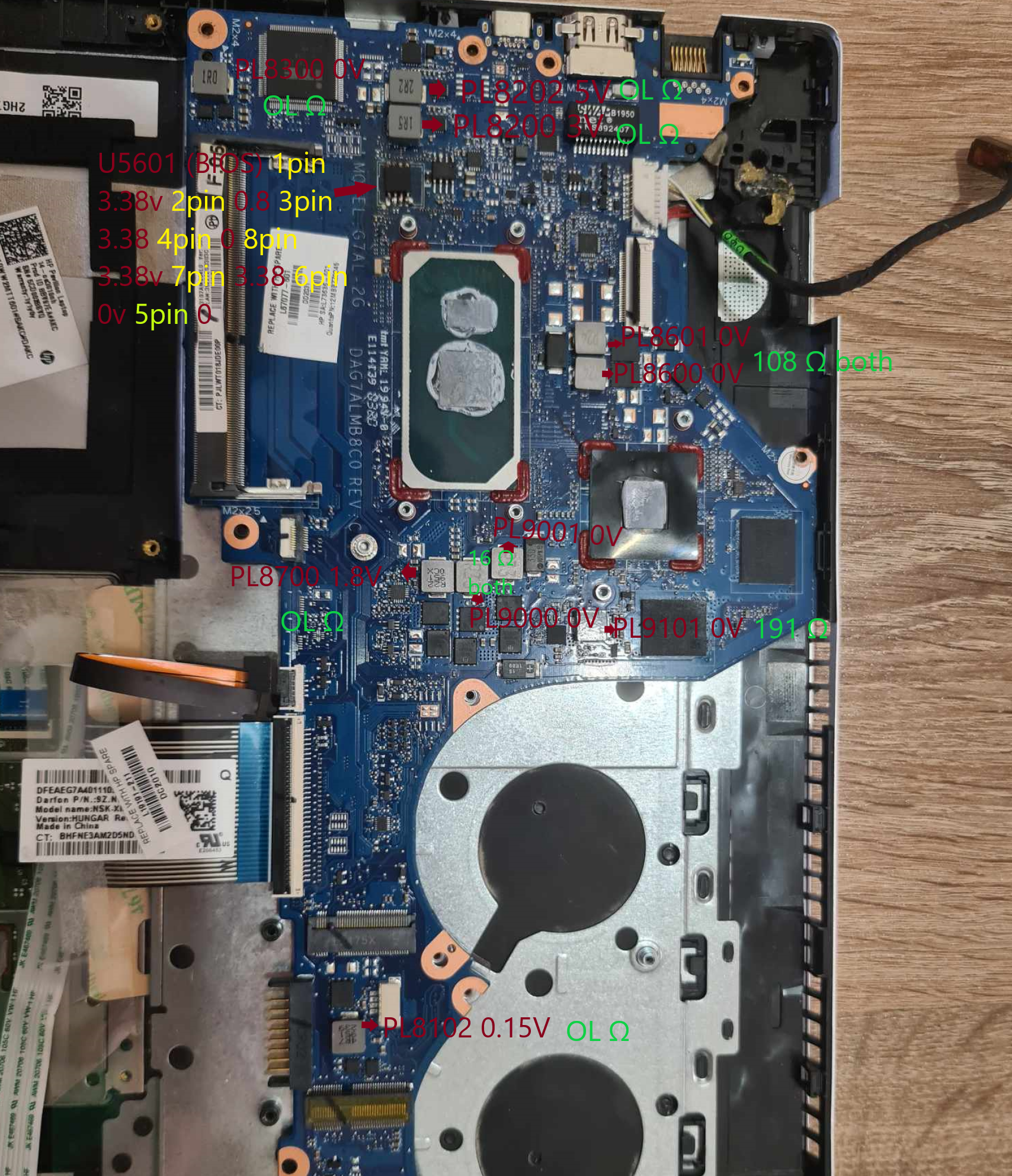

    Issue: I have an HP Pavilion 14-ce3010nh 8BV97EA laptop. When plugged into the charger, it turns on, but there is no display, the fans do not run, and the processor gets slightly warm. Unfortunately, I haven't been able to figure out what the problem is. I've reflashed the BIOS twice without any success. No post. Already tried out with another ram stick with no luck
    I measured the voltage with the HP turned on in red, and I measured their resistance with the HP turned off in green. (I measured the resistance in 200 mode)
    How should I continue, what could be the problem?
    Thank you in advance for any ideas!!!

      I only have a boardview:
      I bought it as faulty a few months ago from my friend, and I have been trying to figure out what's wrong with it for a few days now
      I'm using 19.5V 2.31A power adapter, HP original one
      Charger IC area (?)
      Click image for larger version  Name:	fffffff.jpg Views:	0 Size:	1.90 MB ID:	3280824Click image for larger version  Name:	ffffff.jpg Views:	0 Size:	1.53 MB ID:	3280825
      Please help me locate the DCIN mosfets ( on the boardview component name or just in any way)

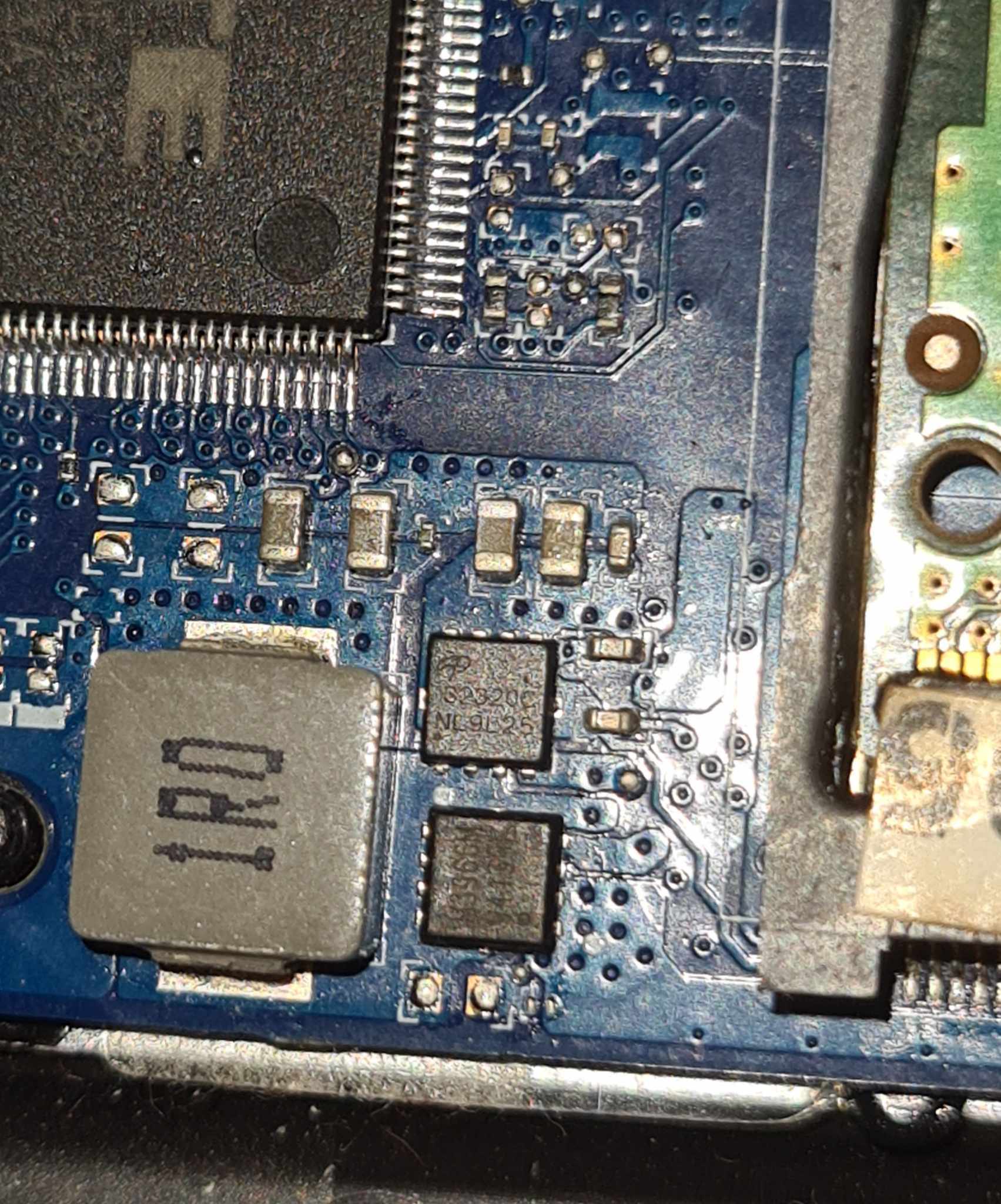

          Locate mosfets PQ1 and PQ2. Measure the voltage to ground on each pin of these mosfets. Charger IC is at PU1. See the linked schematics in the above post.
          • Nagyesz
            • May 2024
            • 124
            • Hungary
            @PQ8101 (also PQ8100)
            1-2-3 pin 19.4 V
            4 pin 24.6
            pin 5-6-7-8 19.4V
            @PQ8102
            With battery connected:
            pin 1-2-3 13 V
            pin 4 11 V
            pin 5-6-7-8 18.7 V
            Without battery:
            pin 1-2-3-4 0V
            pin 5-6-7-8 19.4V
            Couldn't find @PU1 (didn't find anything similar)
            Measured the values while it was turned on.
            • mon2
              • Dec 2019
              • 14185
              Do not have access to the actual schematic so you will be our eyes and ears on this repair.
              You are in the proper area with PQ8101. Based on your measurement, the gate voltage is correct to enable this N-channel mosfet.
              Who is next? Inspect the same details on the mosfet that follows. Post pics as attachments of this area. The charger IC must be nearby these parts. The last post did not come through on the pics.

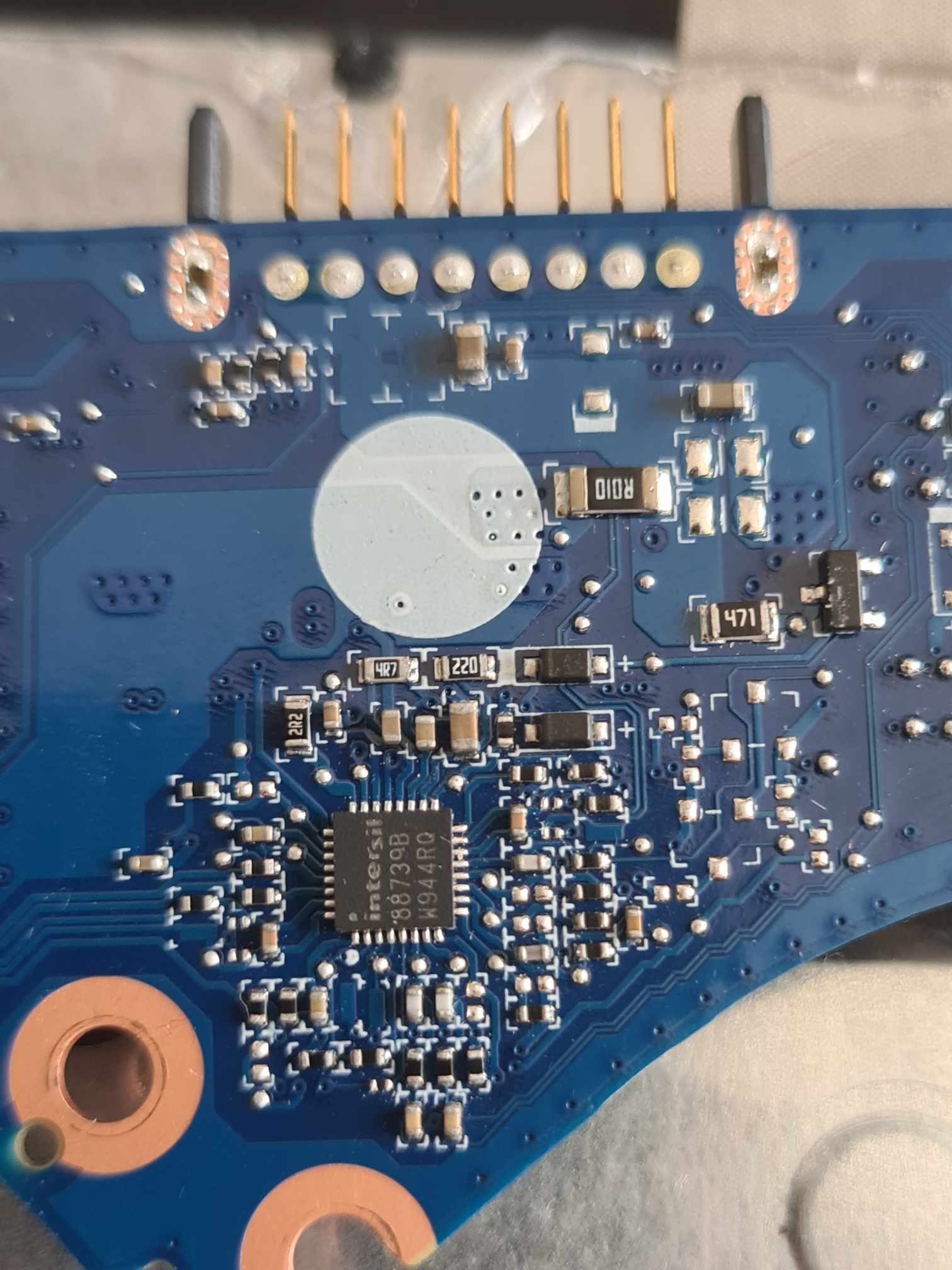

                @PQ8100 after PQ8101
                1-2-3 pin 19.4 V
                4 pin 24.6 V
                pin 5-6-7-8 19.4V
                (Boardview has been quite useful so far, unfortunately, I don't understand schematics.)
                Pics from above:
                @PQ8101
                Click image for larger version  Name:	ffffffffff.jpg Views:	0 Size:	232.3 KB ID:	3280878
                @PQ8102
                Click image for larger version  Name:	kiis.jpg Views:	0 Size:	216.3 KB ID:	3280879

                  Locate what you believe to be the charger IC and share the full topside markings. We can then search on Google to check if the device is indeed a charger IC or not.
                  In the 2nd pic, there is the battery connector so you are close. The dark mosfet to the left of the inductor appears to be discolored. Perhaps it is defective. You can test any mosfet with resistance checks.
                  Remove all power (never any power when checking in resistance or diode mode). Measure the resistance across the mosfet:
                  source (1-2-3) & drain (5-6-7-8)
                  source (1-2-3) & gate (4)
                  gate (4) & drain (5-6-7-8)
                  Checking for a low resistance measurement. Post all measurement. If you see an 'OL' then you must use a higher resistance scale on your meter unless the meter is auto-scaling.
                  • Nagyesz
                    • May 2024
                    • 124
                    • Hungary
                    That's @PQ8102
                    "With battery connected:
                    pin 1-2-3 13 V
                    pin 4 11 V
                    pin 5-6-7-8 18.7 V
                    Without battery:
                    pin 1-2-3-4 0V
                    pin 5-6-7-8 19.4V"
                    ___________________________________________________________________
                    1-2-3 to 5-6-7-8 is 2.4M ohm​
                    1-2-3 to gate 4 is 6.3M ohm
                    4 to 5-6-7-8 is OL every mode
                    Can @PU8100 charging controller?

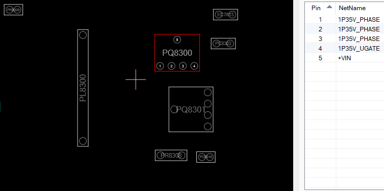

                              I did a bit of investigating, and I think I've found the problem. I'm not exactly sure which component it is, but I'm certain the values are not correct. ( ram inside, 45W supply)
                              Click image for larger version  Name:	_n.jpg Views:	0 Size:	337.6 KB ID:	3281338Click image for larger version  Name:	ffaaaa.png Views:	0 Size:	23.8 KB ID:	3281339
                              @PQ8300 pin 5 19.41V pin 1-2-3-4 0V
                              Click image for larger version  Name:	1551_n.jpg Views:	0 Size:	146.9 KB ID:	3281340Click image for larger version  Name:	fuuu.png Views:	0 Size:	39.5 KB ID:	3281341
                              @PR8306 pin 1-2 4.77V
                              @PU8300 11 pin 5.13v 12 pin 5.13v 18pin 4.77v pin 9 2.11V
                              @PC8308 pin 1 4.77 pin 2 0v
                              @PC8307 0v both
                              @PC8317 pin 1 5.13V
                              @PR8305 pin 2 19.4V pin 1 2.11V
                              What is my next step?

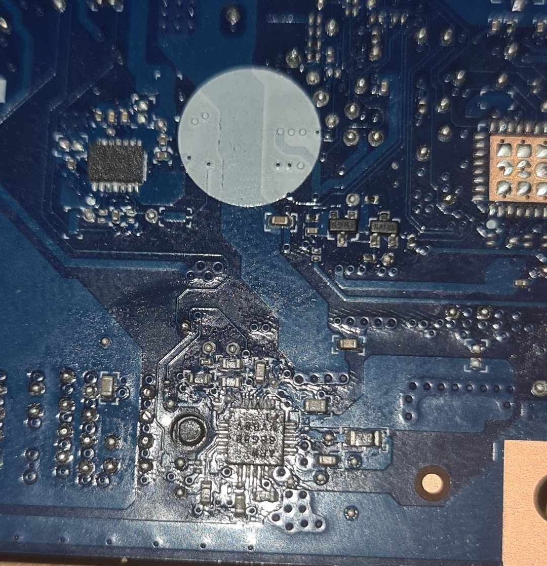

                                    Review the pics from post # 15 - there appears to be a pimple on the chip in the letter ā€˜E’. If true, this part is probably defective and is an ITE EC controller. Post a clear of this part.
                                    • Nagyesz
                                      • May 2024
                                      • 124
                                      • Hungary
                                      I don't quite understand what I should be seeing. I have taken two more visible pictures.
                                      • mon2
                                        • Dec 2019
                                        • 14185
                                        Note the bubble in the letter ā€˜E’. Top half of the letter.
