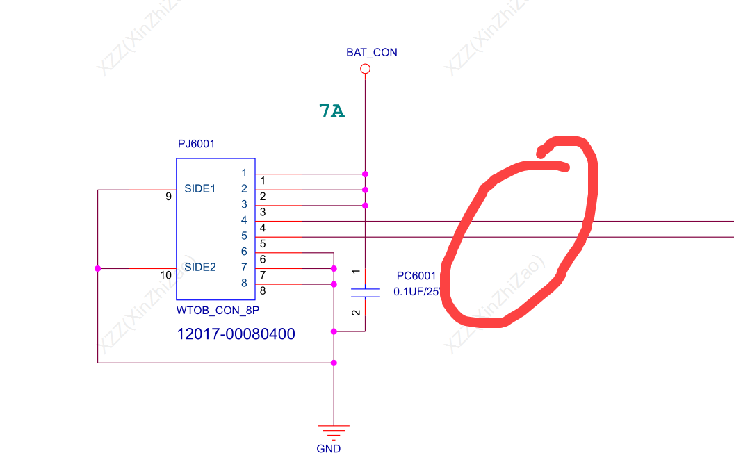

            mon2 Sorry, did you mean the connector on the motherboard or on the battery for the diode test of data/clk lines?

              Test in diode mode and check on the battery connector that is soldered on the logic board. Do not have the battery connected. The logic should feature some TVS ESD diodes on the connector. These diodes are present to prevent ESD damage to the mated boards. Check each pin and post the full list. One end will be the B+ group (often 2-3 pins); other end will be ground.

                  To clarify the above table, meter in DIODE mode. Keep the red meter probe on ground (metal shield is ok).
                  Black onto the battery connector pins. Label each pin # so they are easy to follow.
                  See attached. The circled pins are the most of interest = SMBUS lines.

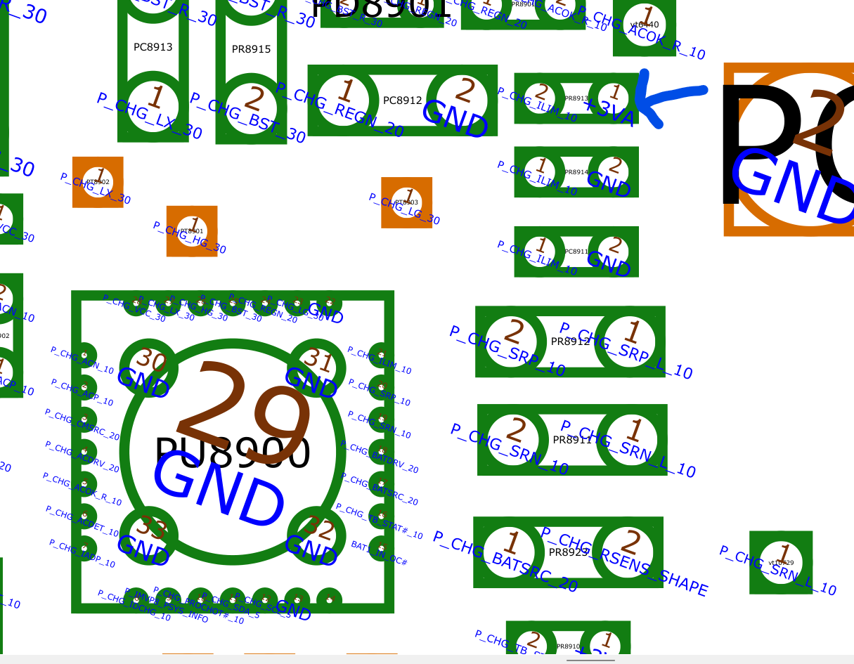

                    mon2 While I had it powered down I touched up the solder on pins 22-28 of the BQ chip with an iron (I'm thinking maybe I didn't do a great job seating that corner of the chip). The battery is charging again.
                    If I see intermittent weird behavior I will report back but I'm allowing it to charge up right now.
                    Maybe I was barely making contact yesterday and something flexed?

                        Tie ILIM pin directly to +3v3. Test again.

                            Yes, bridge PR8913.

                              Hmm, just an observation but the schematic rates PR8913 at 120kohms but it measures 89kohms. Is that a significant enough difference to cause an issue?
                              Also PR8914 schematic value is 68kohms but it measures 57.6 kohms, less of a difference but just so you have the information.

                                Earlier, you measured the voltage at the junction for ILIM. The voltage was correct for ILIM so PR8913 is 120k. It is probably measuring lower since it is in circuit. According to the datasheet for the charger, if ILIM is 2V or higher, you are instructing the charger IC to support the charging with max current.
