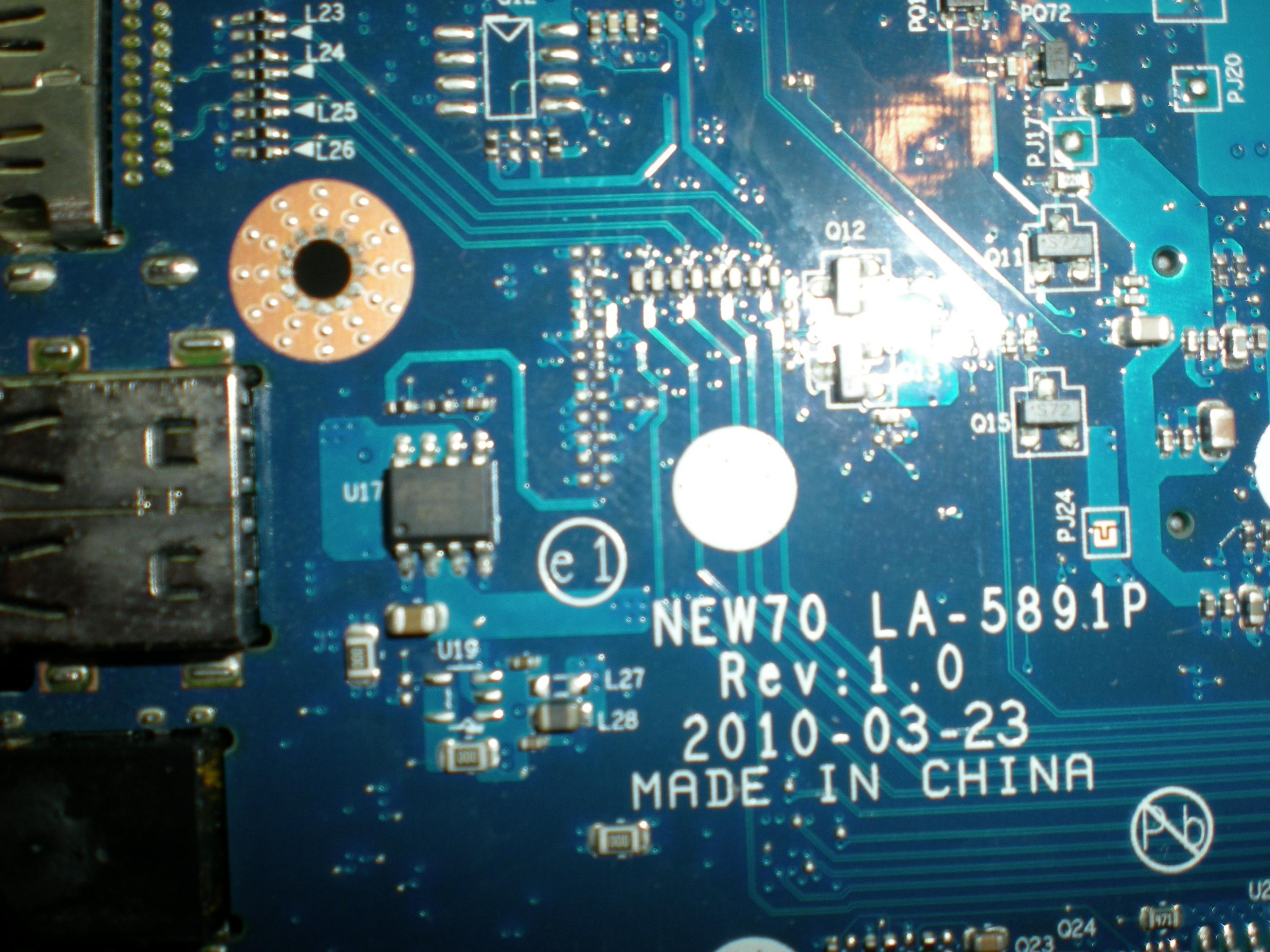

    Hi any help would be appreciated. This laptop shows no power on Leds but there is 19v at adapter and first connector on PCs motherboard. Could anyone direct me where to next check for voltages and or signals.
    Many thx in advance, John

        Will need some laptop wizards to help- does it work on battery, can you post pictures of the area around the socket - can you spot any fuses?

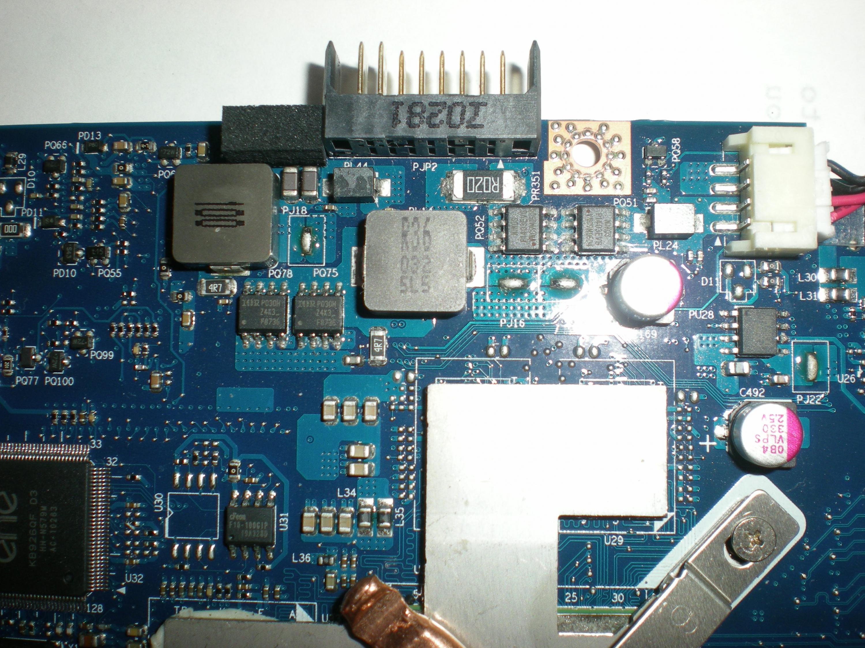

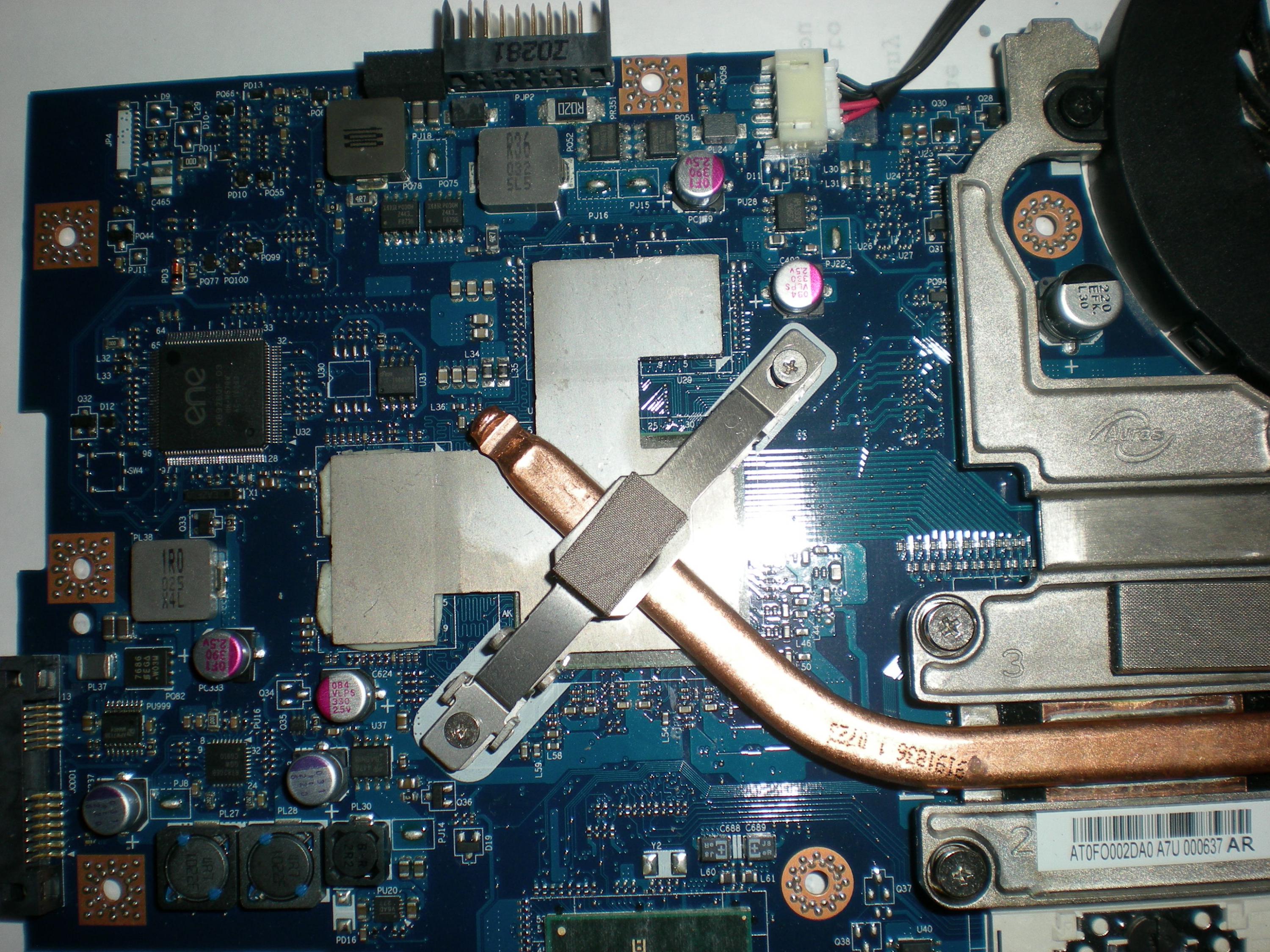

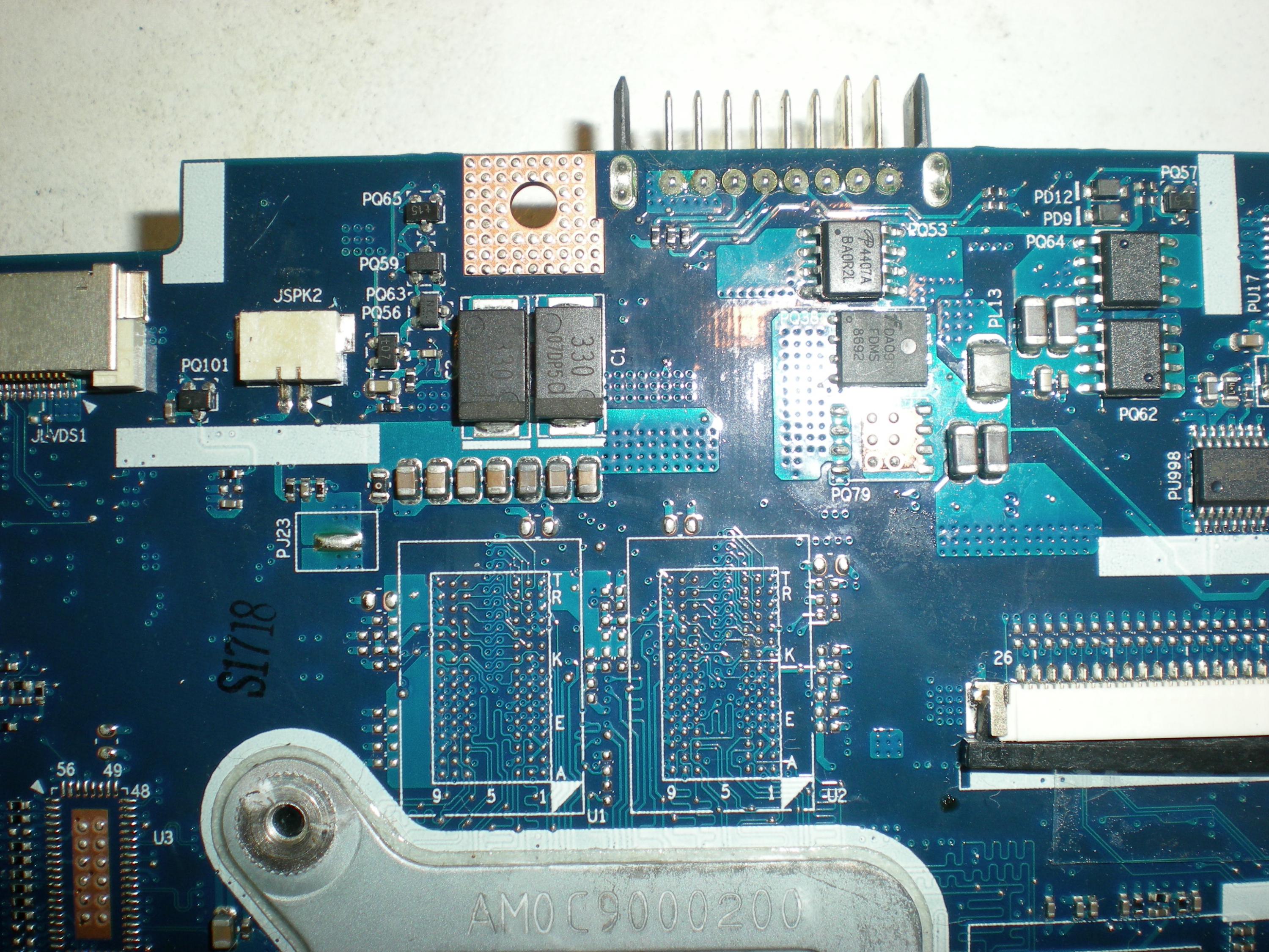

          Re: No power new70 5891p motherboard acer 5742
          Yes, there are 2 fuses both ok nothing appears burn or discoloured will post pics tomorrow.
          Unfortunately battery flat as no power on laptop to charge it.
          Cheers, John.
            you can try this schematic. read page 44 dcin (pjp1) thru page 47 VIN/charger. hope this helps
              Hi lessimply, thanks for replying.
              Took some random voltages as I am not an expert just learning will try to attach photos.
              Voltages at components on schematic.
              PD2 = 19VDC
              PL24 = 19VDC
              PD1 = 0VDC
              MOSFET
              PQ51 = DRAIN = 19VDC
              SOURCE = 0VDC
              GATE = 0VDC
              MOSFET
              PQ52 = DRAIN/SOURCE/GATE ALL = 0VDC.
              Thanks lads, John.
                If pq51 pin number 4 (gate) is 0v, try checking pq56 and pq58 which gives voltage to gate. You can also check pc249 for short and the resistance of pr353
                  Hi again,
                  PQ56 Base = 0vdc
                  Emitter = 18.6vdc
                  Collector = 18.6vdc
                  PQ58 Base = 13.13vdc
                  Emitter = 0vdc
                  Collector = 0vdc
                  PC249 not marked on PCB cannot find any capacitor 25volts.
                  PR353 also not marked on PCB.
                  Hope this helps.
                  Cheers, John.
                    Check pin 1,2 and 3 of PU18A.
                      Hi whaldsz, thanks for your input.
                      PU18 is a LM393dg soic
                      Pin1 = 0vdc
                      Pin2 = 3.31vdc
                      Pin3 = 0vdc
                      Best regards, John.
                      • whaldsz
                        • Apr 2013
                        • 395
                        • Philippines
                        pin 1 is abnormal, it should be higher than 3.31vdc.
                        1. Check PR297 and PR298, they could be open.
                        2. Check PC211, it could be shorted.
                        3. Check the resistance of pin 1 to ground of PU18 - could be shorted. Replace if needed.
                          didnt read the whole posts but change lm393, usually burns on this board.

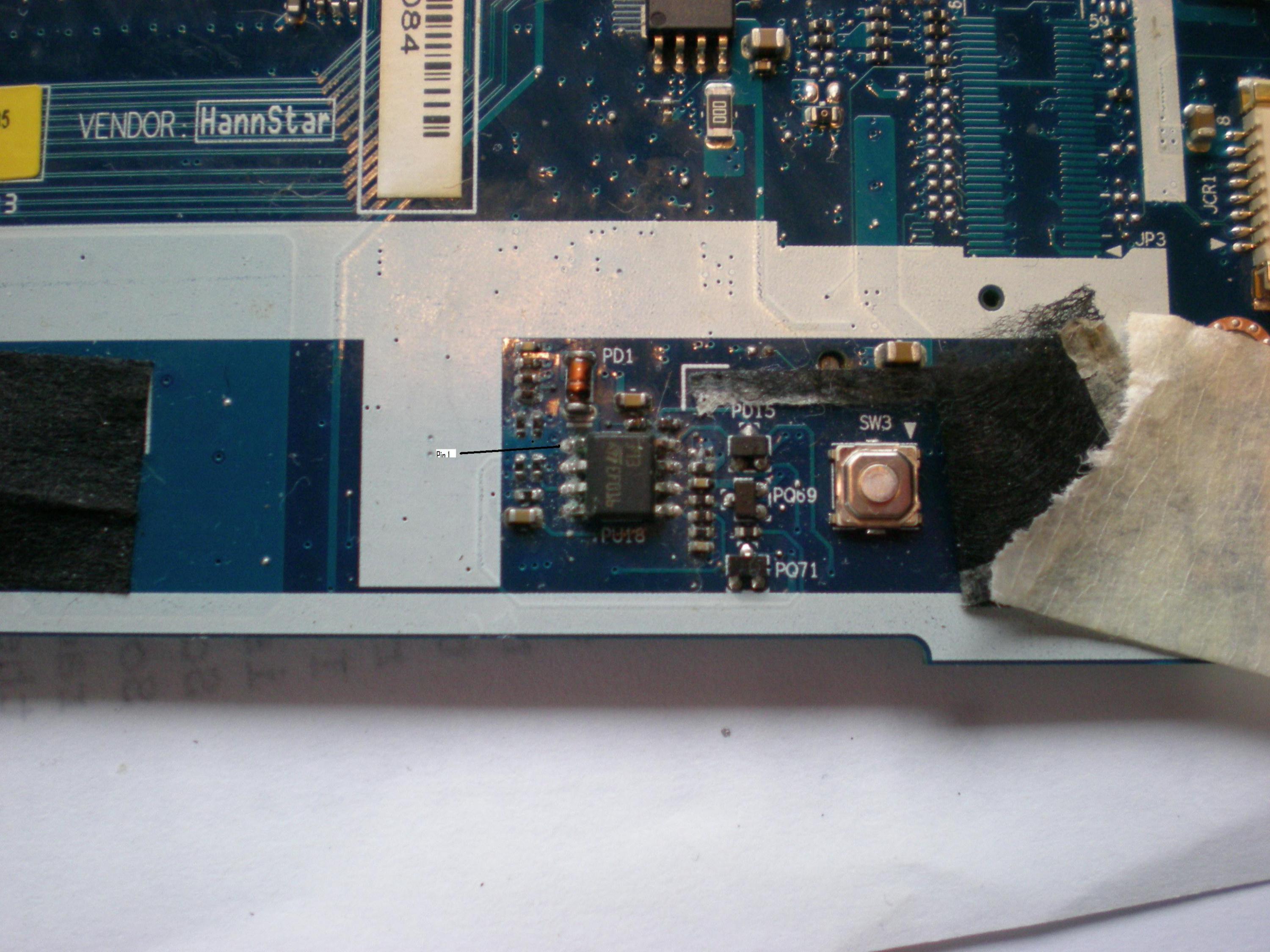

                            Hi Lads, hard to identify resistors and cap as they are so small.
                            Pin 1 = 9.7Kohmns to gnd.
                            Sent for LM393DG will be a few days before it arrives.
                            Added another photo. PU18
                            Regards, John.
                              Hi lads, sorry for taking so long was waiting for parts and solder paste.
                              Replaced Lm393 regulator.
                              Pin1 = 0v
                              Pin2 = 3.3
                              Pin3 = 0
                              Pin4 = 0
                              Pin5 = 2.8
                              Pin6 = 2.8
                              Pin7 = 0
                              Pin8 = 18.4
                              • whaldsz

                                Check why pin 3 is 0V on PU18A:
                                1. Is PR298 open? it should read 22k ohms
                                2. Is PR297 open? it should read 84.5k ohms.
                                3. Is PR301 shorted? it should read 20k ohms.
                                • John McGivern

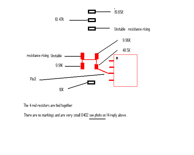

                                  Hi whaldsz, thanks for your help.
                                  Nothing is shorted, resistances are shown on attachment lm393 reg.
                                  Many thanks, John.
                                    Pin 3 of PU18A is connected to PR298. You said pin 3 reads 0v and PR298 measures 49k which is not normal. When tested in circuit this resistor should measure no more than 22k ohms. Measure the voltage at both ends of PR298. You should expect a voltage readings of 0v at one end and around 3.6v at the other end.

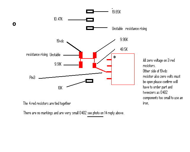

                                      Hi whaldz, took voltages at resistors shown on attachment.
                                      • John McGivern
                                        • Dec 2013
                                        • 195
                                        • uk
                                        Hi again lads, was measuring voltages at
                                        Pq51 gate source and drain between 19vdc to 18.6vdc
                                        Pq52 had gate 18.6 pins 1,2,3 18.6
                                        Pins 5,6,7,8. 360mV.
                                        Does this need replacing.
                                        Cheers
