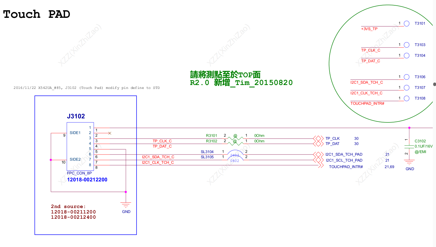

    My laptop's touchpad is not working. I have tried software, touchpad and touchpad fpc. I think the motherboard is faulty, can you share motherboard schematics or how can I fix the problem?

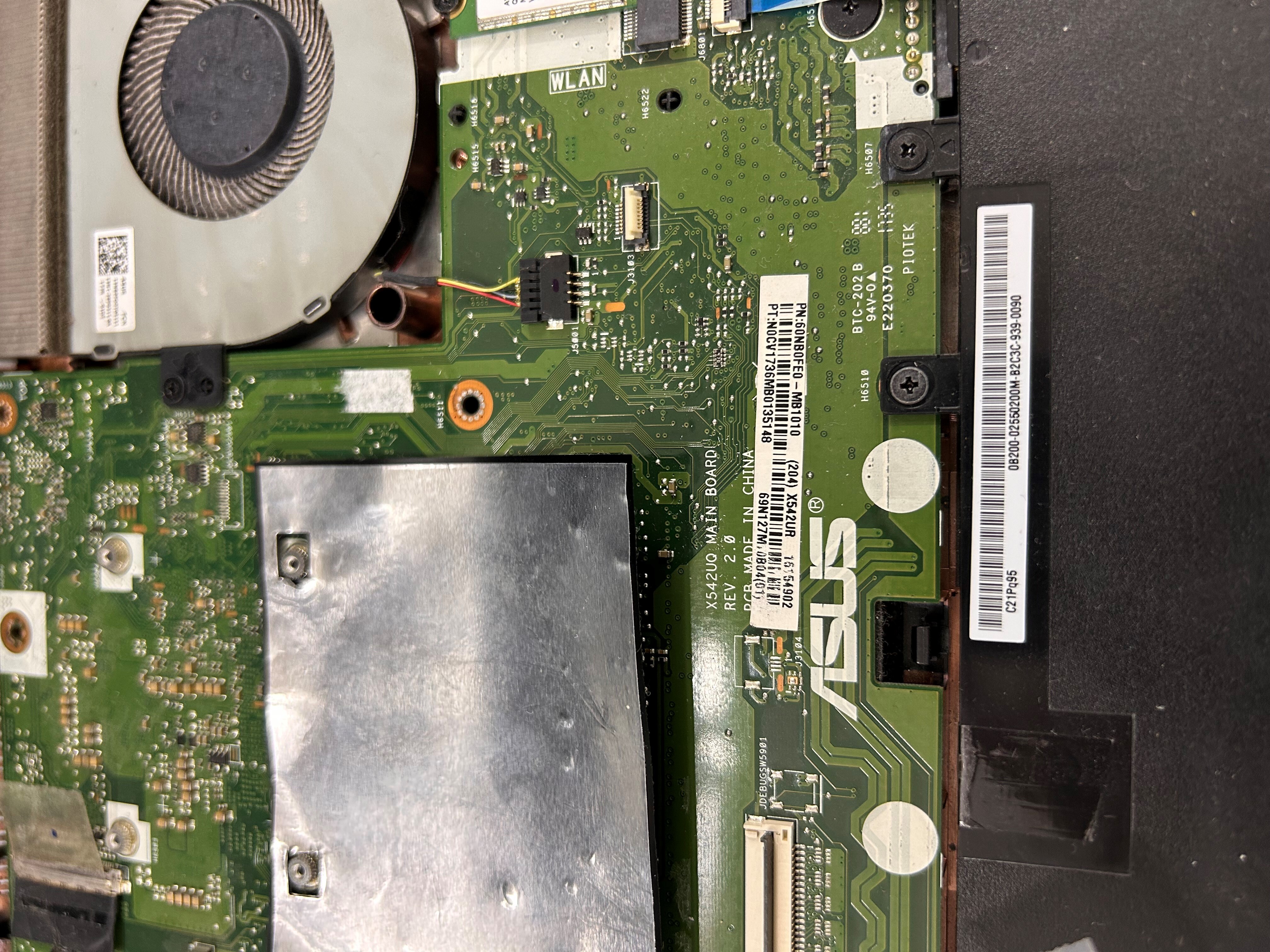

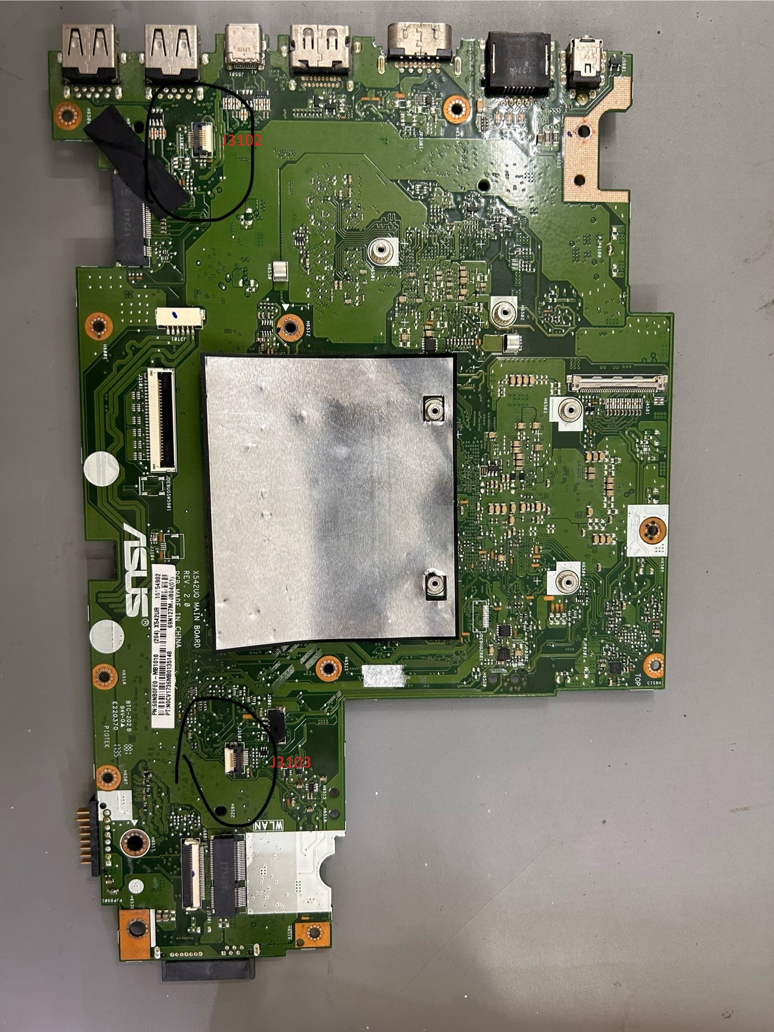

        Which is the trackpad connector? Is it J3103 in the shared pic?
        Test it by placing the meter in diode mode. No power on the logic board. Connect the trackpad.
        Red meter probe (yes red) to ground.
        Black meter probe to point to test.
        Test each pin on the trackpad connector. Post each diode mode measurement.

          I checked each pin of J3103 and they all work

                    and my motherboard touchpad connector name is not J3102, my touchpad connector its J3103.
                    • Test asus
                      • Apr 2024
                      • 7
                      • Turkey
                      ok my problem is solved, I was connecting to the wrong connector
