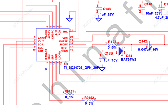

    Hi All,
    I have been struggling to repair a HP 8460P laptop. Motherboard does not turn on. I have traced the problem to what seems to be a missing signal KBC_PWR_ON causing Trip2 on IC 5006 (TPS51123) to be activated.
    The following components have been replaced but the problem remains.
    C5191
    C5192
    U50006
    Listed below are voltages appearing on U5006 when the Motherboard is supplied with power from a bench power supply for the first 15 seconds or so.
    Pin 1 (Trip1) = 0.65
    Pin 6 (Trip2) = 0.65
    Pin 8 (Vreg3) = 3.31
    Pin 17 (Vreg5)= 5.13
    +V3A (Measured at Pin 1 of L3013) 3.37
    +V5CP (Measured at Pin 1 of L3012) 5.13
    KBC_PWR_ON = High
    Pin 23 (Pgood) = High
    Current drawn at this moment 24.00mA
    15 seconds later... All voltages above still present except
    Pin 6 (Trip2) = 0.00
    +V3A (Measured at Pin 1 of L3013) 0.00
    KBC_PWR_ON = Low
    Pin 23 (Pgood) = Low
    Current drawn at this moment 18.00mA
    Please help and advice. Thanks!

    Review the charger IC @ U7.
    Carefully measure and share the readings of voltage to ground for:
    ACDET ; pin 6
    REGN ; pin 16
    VCC ; pin 20
    ACOK ; pin 5
    ACDRV ; pin 4

      Thanks for your response and sorry for my late reply. The voltages for U7 are listed below. All voltages are measured with respect to Gnd
      ACDET ; pin 6 = 2.59
      REGN ; pin 16 = 6.01
      VCC ; pin 20 = 18.45
      ACOK ; pin 5 = 3.25
      ACDRV ; pin 4 = 25.00
      Please note that the motherboard is not connected to the battery when the measurements are taken​.
      Thanks.
