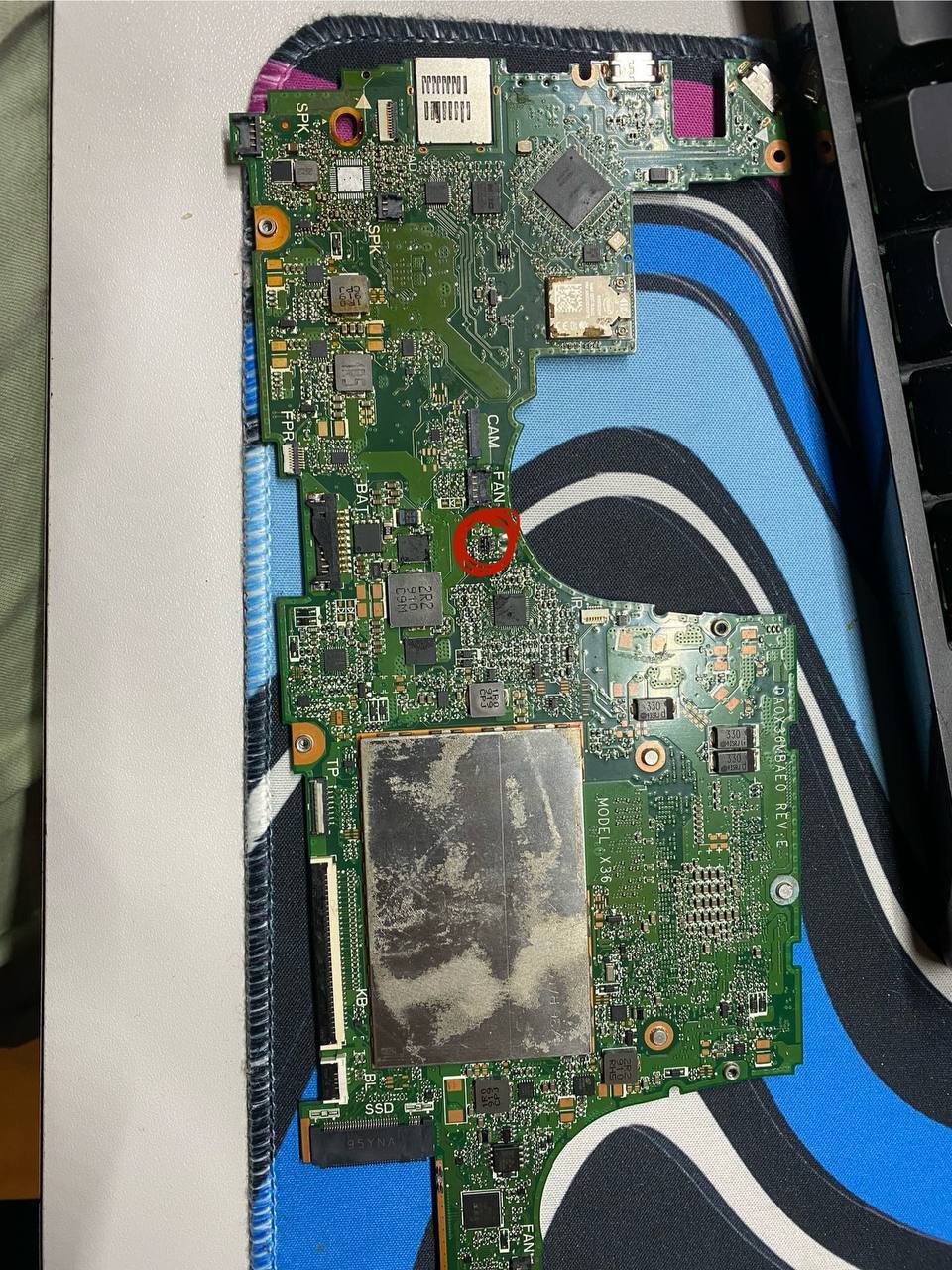

    Team - Help identify SMD chip 38F on this system board from HP spectre - x360.
  • mon2
    • Dec 2019
    • 13905
    Post a pic of the component to review the topside SMD markings.

            I am sorry. I rechecked and it is marked as 36F
            • mon2
              • Dec 2019
              • 13905
              The linked pic (post # 4) shows a bunch of mosfets. Unable to locate 38F / 36F. Review the linked pic and highlight the part with this marking.

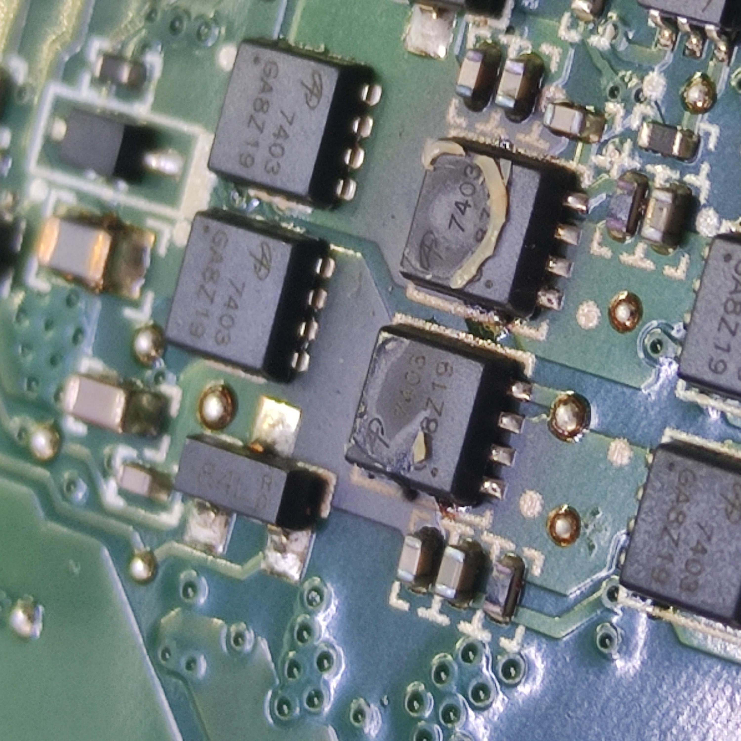

              • mvilkhu
                • Apr 2024
                • 5
                https://www.badcaps.net/filedata/fetch?id=2091007.
                Same 2 chips burned as shown in this picture
                • mcplslg123
                  • Jun 2015
                  • 7262
                  • india
                  As per post#8 pic,the burned mosfet are clearly AON7403. Its a P channel mosfet.
                  • mvilkhu
                    • Apr 2024
                    • 5
                    Thanks.Same mosfet is marked as 36F 1905 on my system board. I got an eqvt. mosfet but still having trouble with power on. Currently no power is detected using USB-C power meter.
