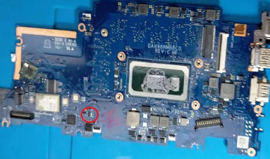

    good day experts!
    i have huawei matebook d14
    DAH98NMB8C0 REV C HF
    the laptop works normaly when using it and charging
    the problem is when i shutdown the laptop and not using it, the part in the picture with red circle
    becomes so hot you cant even touch it, and it drains the battery quickly
    i cant find schematics for this laptop
    can someone tell me what is this part so i can replace it

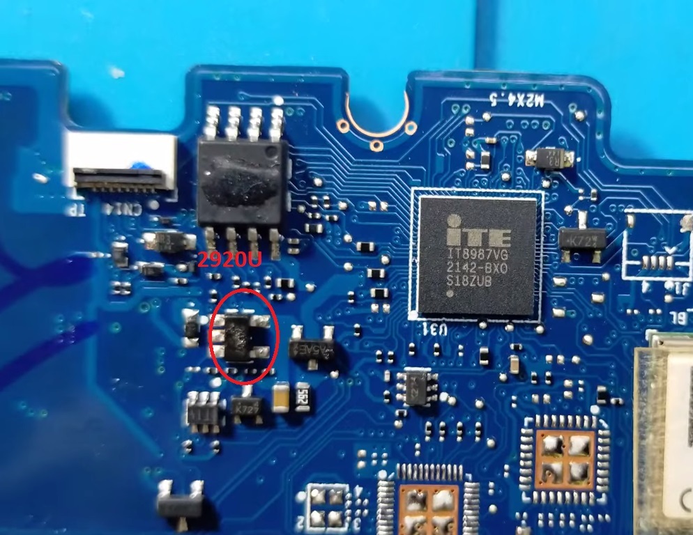

    this is the part
    2920u (sot23-5 marking)
    when laptop on and charging (normal)
    pin 1 vin = 16v battery voltage
    pin 2 GND
    pin 3 = 0.7v
    pin 4 = 0.9v
    pin 5 out = 3.3v
    when laptop off
    pin 2 GND
    pin 3 = 0v
    pin 4 = 1.2v
    pin 5 = 2.6v
    when laptop is off and charger plugged in (normal)
    pin 2 GND
    pin 3 = 0.7v
    pin 4 = 0.9v
    pin 5 out = 3.3v​

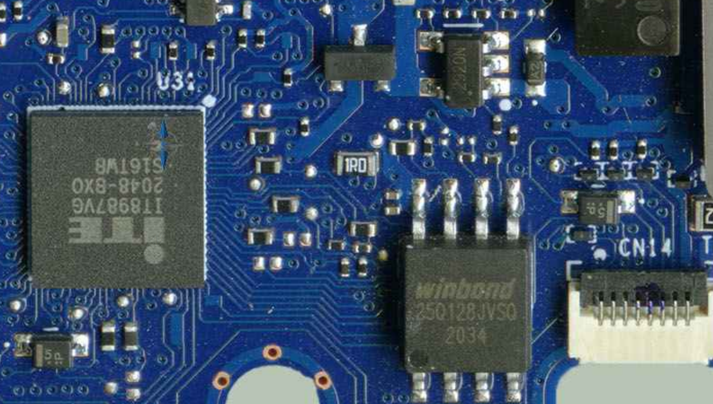

      can i replace it with this?
      • mon2
        • Dec 2019
        • 14677
        Do not replace this part till more is known about the original.
        The last character of this part looks like a ‘7’ ? Pour alcohol onto the top surface to gain clarity of the markings. Can you confirm?

          its not my pic, CTTO, i only edit the video i got from the net, the part marking in mine is 2920u,
          forgot to take the picture in mine cause the owner took it and will return it to me when i have the parts

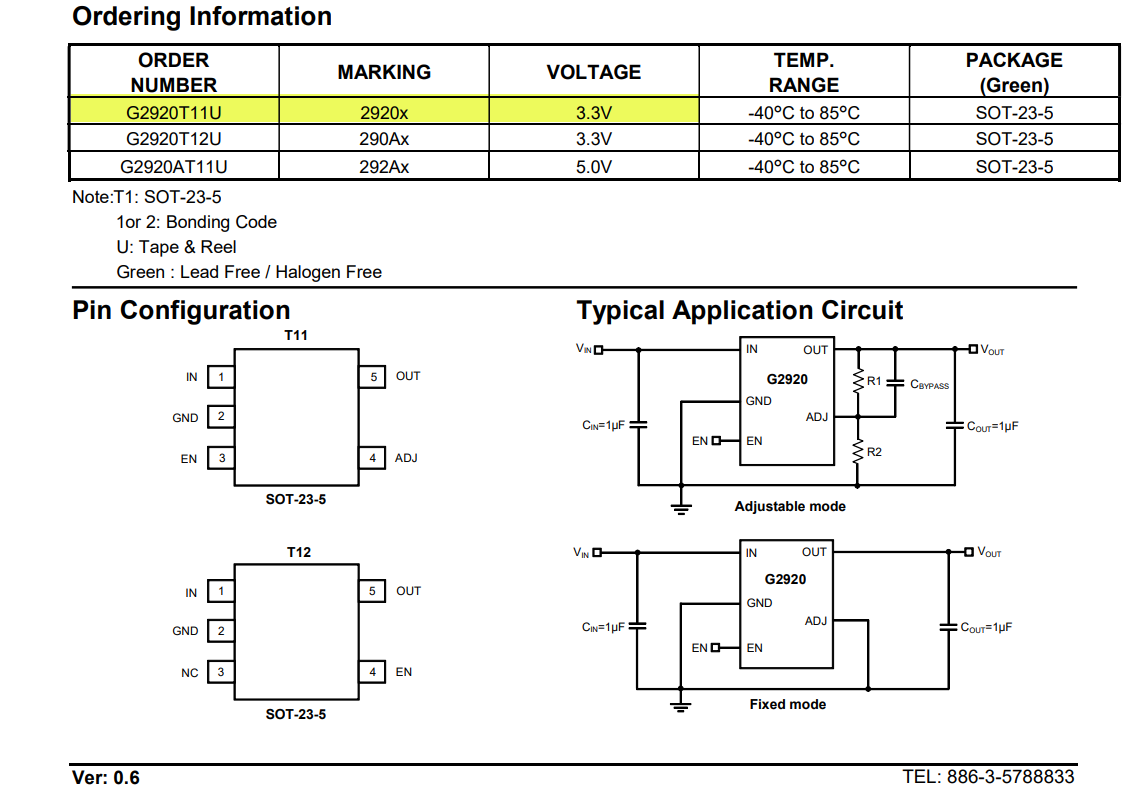

                I think it is part # G2920T11U by GMT but still working on a few leads. More later once at the office. Aliexpress has these.

                  resistance
                  test probe shorted 0.9ohm
                  test to gnd
                  pin 1 = 197.8 ohms
                  pin 2 = gnd
                  pin 3 = 99.0 ohms
                  pin 4 = 8.57 kohms
                  pin 5 = 13.19kohms
                  the test is no battery connected

                      Ok - found it. See attached.
                      From other board pics of a similar model:

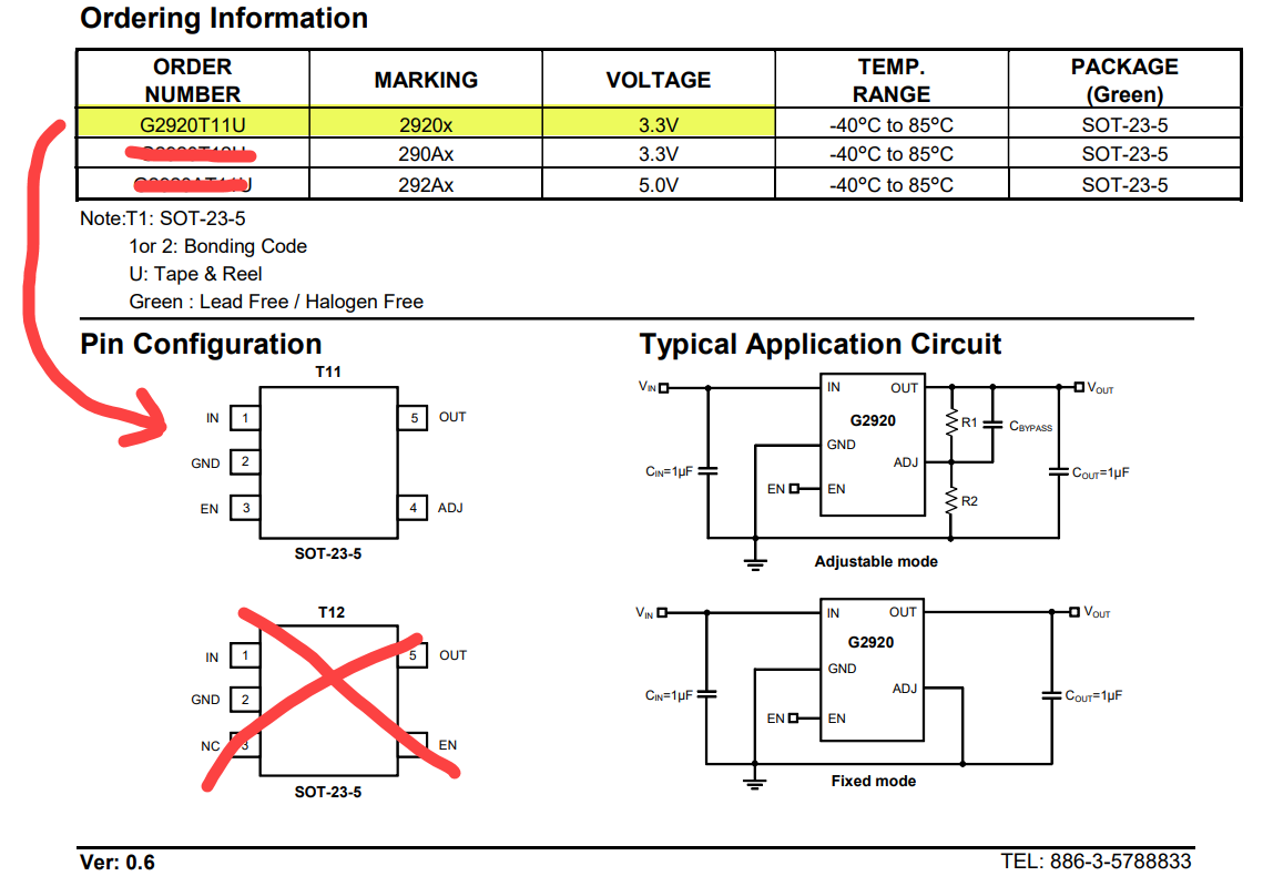

                      This is a HIGH VOLTAGE (for input) low current fixed LDO @ 3v3 output. Should be common to replace with others if the pinout can match.
                      Click image for larger version  Name:	pinout.png Views:	0 Size:	126.5 KB ID:	3246049
                      Datasheet:

                          I do not have this board but a similar one is in my database. The LP*** LDO is rated @ 50 mA but this one from GMT is rated @ 150 mA. You could try it if it is available to you but need to review the pinout functions.
                          My last post lost the datasheet - it is attached here.
                          G2920.GMT-1493-220214-0.6.pdf

                              We can locate a suitable replacement if needed. In the end. This is a fixed 3v3 ldo with an enable pin. The input must be tolerant to a high voltage like the battery or adapter voltage.
