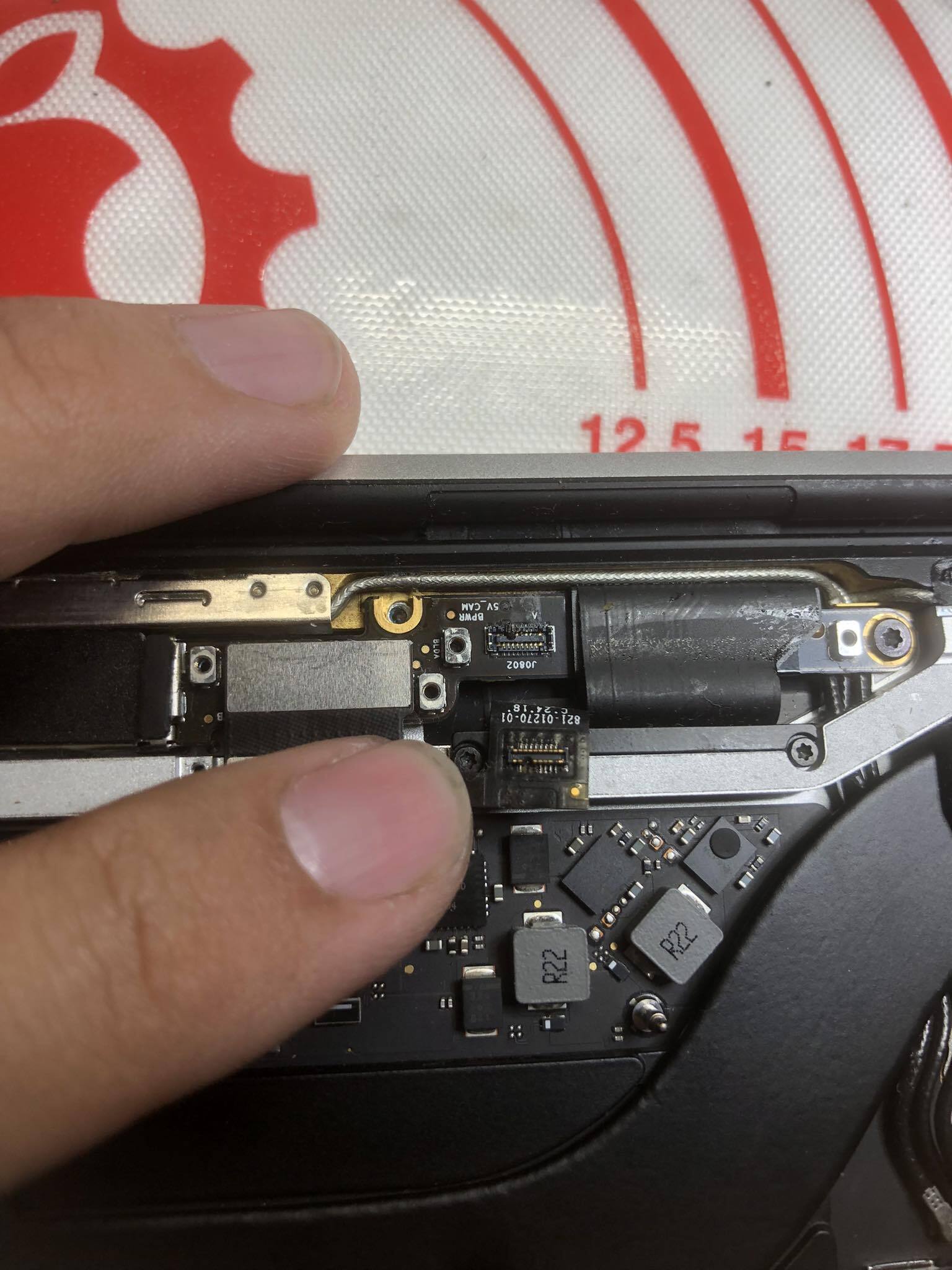

                ok sir i forgot to tell that the camera connector is blown .. ok tommorow i will replace backlight ic and give u update sir thank you so much for ur help i really appreciate it

                      check the smbus lines from the camera connector. They maybe impacting other smbus slave devices/sensors.

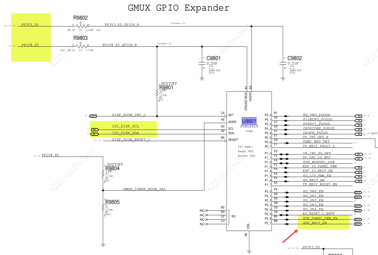

                            Adding to the list...remove all power. Meter in DIODE mode. Red meter probe, yes RED to ground.
                            Black meter probe to point to test.
                            Measure the following points of interest in this DIODE mode:
                            I2C_DISP_SCL
                            I2C_DISP_SDA
                            Post each measurement. The above I2C / SMBUS lines are used to configure the graphics MUX (multiplexer) @ U9801. If these lines are defective or not working correctly then the LCD display will not be powered, backlight will not be enabled.

                              sir this is the result upon checking
                              DIODE MODE:
                              I2C_DISP_SCL =0.422
                              I2C_DISP_SDA =0.422
                              VOLTAGE MODE:
                              I2C_DISP_SCL= 1.2V << is this normal?
                              I2C_DISP_SDA= 1.2V << is this normal?
                              PP3V3_S5_GPIOX_R=3.3v
                              PP1V8_S5_GPIOX_R=1.799v

                                  No, the parked I2C_DISP_SCL / I2C_DISP_SDA voltage is not normal. It is a good find.
                                  Carefully review the voltage to ground of PP5V_G3S. This is the pull-up voltage rail used by this I2C pair of communication lines.
                                  Carefully, measure that you have a valid 5 volt reading on each side of R8444 and also R8445. This power rail is used to power the backlight IC and other parts of the logic board.
                                  Next, remove all power -> meter in resistance mode (not diode mode) ->measure the resistance to ground of PP5V_G3S​. If there is a shorted part on this rail, the voltage will be lower than expected.
                                  This power rail is created by U7650 buck regulator. This regulator may be defective or have a shorted part on the output. Measure the resistance (not diode mode) to ground @ L7600 (either side is ok).

                                      Go back to the i2c lines and measure their voltage to ground on each side of the pull up resistors.
                                      I2C_DISP_SCL
                                      I2C_DISP_SDA
                                      • alfredposadas09
                                        • Aug 2020
                                        • 342
                                        • Philippines
                                        R5215 = PP1.8V_S5 = 1.8V /I2C_DISP_SDA=1.8V
                                        R5216=PP1.8V_S5 = 1.8V /I2C_DISP_SCL=1.8V
