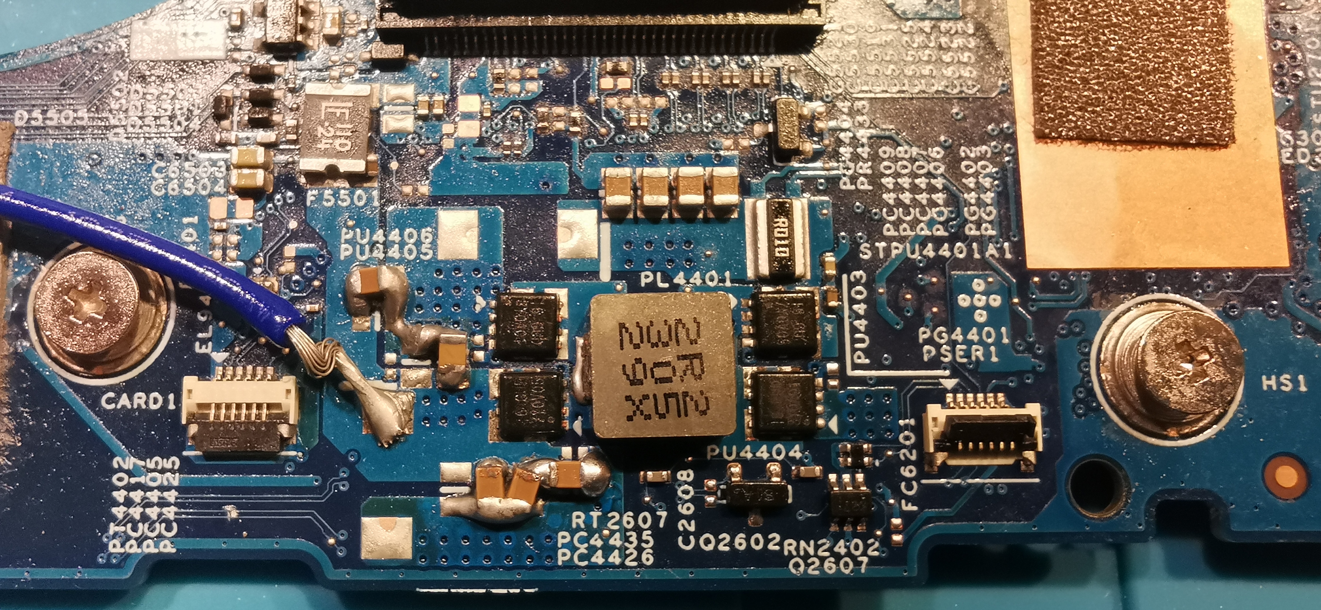

    Hi guys
    I have received this laptop to try and repair it (and to learn more in the process).
    It was liquid damaged, I found some corrosion near the screen cable that I cleaned. Now I'm left with a short on main power rail (19V).
    I was hoping that it would be something simple as a shorted cap around a liquid damaged area, but no.
    My problem is, I cannot identify what is shorted. I've inserted 0.9V (to be on the safe side) on mail power rail, and the voltage drops to 0.4V with the max current drawn allowed of 4.8A.
    However, the board is cold as ice, I cannot see anything heating up! I don't have a thermal camera (and was hoping not to have to buy one) so I'm spraying board with IPA (not beer ) to see where it evaporates. I've tried on both sides but I can't see absolutely any warm or hot spots.
    Also, this is a bit strange laptop, at least to me, as I don't see any mosfets for other power rails (5V, 3.3V, Vcore...), just coils. And from my tests there are no shorts on the any of coils output, just on 19V rail.
    I'm a bit scared to try to insert 19V on the rail in case I've missed something, don't want to fry CPU or RAM or whatever, but I need to change something because this approach is not producing results.
    Do you think I should up the inserted voltage (and limit max current to 2A or more?), or do you have some other suggestion?
    Thanks in advance!

      Green areas are caps that are short to ground (0ohm resistance), purple are resistance coils to ground (bottom right coil is currently missing, removed to isolate input from output, so values are on each side). I haven't seen any coils or shorts on the other side, just some chips (Realtek, ThinkShield...) and connectors

        Let me try to revive this post, maybe I could get some help this time.
        The story is:
        I have this Lenovo L13 gen3 213037-1N laptop, water damaged, no schematic, and I've identified a short on a main power rail. Spent silly $$ to buy thermal camera.
        However, I cannot find what is shorted. I've tried inserting voltage on various points on main rail, but NOTHING GETS FREAKING HOT. I've inserted from 0.9 to 19V, board always uses only 0.45-0.5 V with max current allowed. So something is taking 5A without getting hot! There are several "combined MPPX" mosfets that I've tried removing from the board, as I'm not sure how to test them, but the short persists.
        Other voltage supplies are not shorted. Previous picture shows shorted caps (on main rail) and measured resistance on various coils.
        I've hit a dead end and have no idea what or how to test next.
        Any help -advice, idea, schematic...- would be highly appreciated! (And to repeat myself, my knowledge is quite limited)
        THX

            These are the pictures of input circuit; wire is main rail where I inserted voltage:Click image for larger version  Name:	IMG_20240508_145316.jpg Views:	0 Size:	3.71 MB ID:	3267028 Click image for larger version  Name:	IMG_20240508_145843.jpg Views:	0 Size:	2.51 MB ID:	3267027

                Thank you for a detailed process of examination and explanation.
                Since this particular laptop was received as "liquid damage", my testing path was a bit different. For start, I never connected motherboard to power supply. I opened it, noticed some corrosion -on the first picture in last post, where a wire is soldered and some messy caps, corrosion was present all around those messy caps, then up around the fuse and on the connector on the upper part (this is screen connector). I took those caps out, cleaned everything with IPA, and put still good caps back. That's why they're so messy.
                Then I checked with multimeter against the ground, and noticed a 0ohm short. I checked around all coils, and short seems to be present on the input side only, meaning before "combined" mosfets. This indicated to me that all mosfets are most likely OK, but I might be wrong.
                On the picture in the much earlier post there is a motherboard with measured resistances between ground and various coils. Since it's 0ohm between main power rail and ground, measurements should be exactly the same.
                At that time I didn't have thermal camera, so I opted to insert 0.9V at the soldered wire -which i identified to be main power rail-, and tried to find shorted component by spraying motherboard -both sides- with IPA. I started with 1A and upped to 5A, no conclusive result.
                Then I tried cooling the board with the cold spray and checking which part would melt first -on both sides of motherboard- , also with inconclusive results; nothing seemed to get hot even with 5A.
                Recently I bought thermal camera, UNI-T UTi721M, and checked the motherboard again, again on both sides. Even after 5-6min running on 5A, NOTHING SEEMS TO GET EVEN A BIT HOTTER. Only warmer patches (that I can find) are around where the + and - probes touch the board.
                I know something should get hot, I understand how much of a current 5A is.
                At this point I really have no idea how to proceed. I'm even not sure if my original conclusions are valid, since I cannot experimentally prove them.

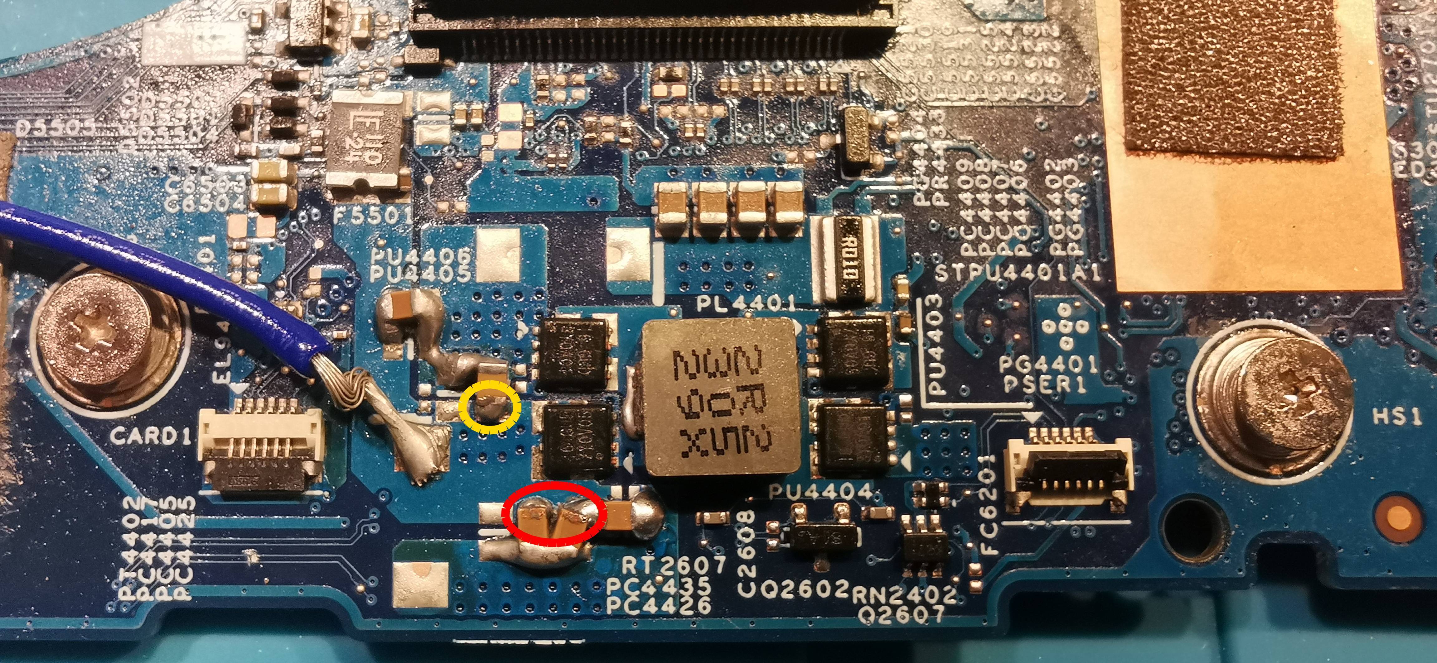

                  I'd suggest using real leaded solder, flux and a good soldering iron with appropriate tip. This soldering is not great, and maybe there is a solder bridge somewhere between the power rail and ground. Additionally, when the end cap of SMDs is too corroded, they should be replaced.
                  Also, is the capacitor next to the polyfuse F5501 really supposed to be there?

                    This is exactly what I was thinking lately, that maybe my bad soldering created another short around those caps. This is the first thing I will check next.
                    I removed the bad caps, and put back only the good looking ones. There's also a chance that I've damaged them when putting them back badly.
                    Regarding the cap next to the fuse, I will definitely check it closely. Thanks!

                      Click image for larger version  Name:	IMG_20240508_145316_e.jpg Views:	0 Size:	1.27 MB ID:	3267973
                      Circled in red are capacitors with their end caps damaged. The left one may not even have taken solder.
                      Circled in yellow is a capacitor with a partially damaged end cap. There is still enough material left for it to be soldered properly, but it is better replaced anyway.
                      • double_DD
                        • Mar 2024
                        • 50
                        • Croatia
                        Well colour me stupid! I've removed those messy caps and the short is mysteriously gone. Apparently I've been chasing my own tail for the last month or so. No wonder I couldn't find anything with thermal camera. 😠
                        And I've replaced all of them with brand new ones.
                        The weird part is, I'm almost 100% sure that when I originally removed those caps, short was still present. So either I'm remembering wrong, or removing and putting back other components somehow disappeared the short. Or some of the mosfets I've put back are not properly soldered on.
                        Anyhow, now checking with my multimeter all coils show high resistance to main rail, and connecting power supply to either of usb-c ports gives me a stabile input 20V. Now I need to reassemble and check if there are some other errors.
                        Thanks mon2 & piernov for now, I'll be back with updates!
