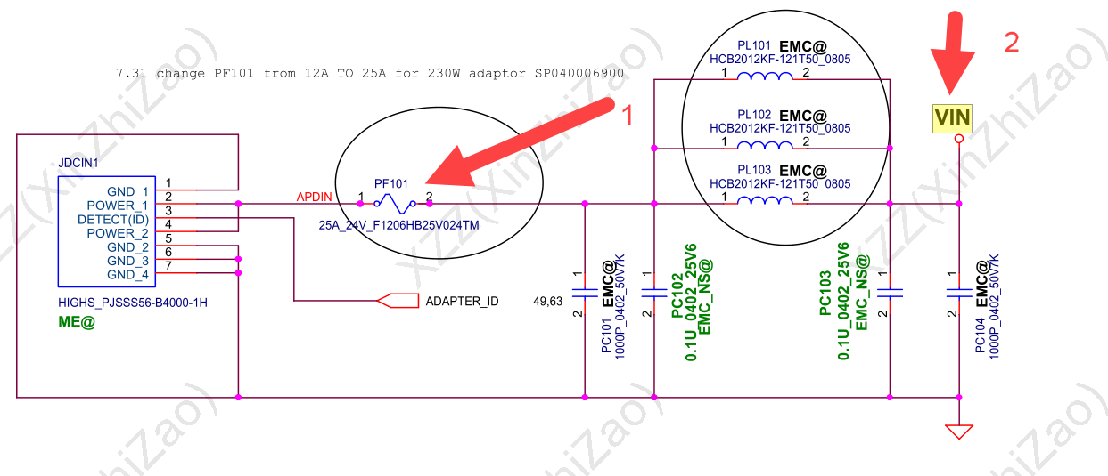

            Ok. Review the schematic for the NM-C531. Start with the DC in power connector where you insert the power adapter barrel plug. This is the entry point to power this logic board.
            Locate a white color (usually) surface mount fuse (post pics if in doubt). Need to check if this fuse is defective or not. Remove all power. It is safer to do this for now. Meter in lowest resistance scale.
            Short the meter probes and this is the expected range of the fuse if it is not defective / blown. Apply the same meter probes across this surface mount (SMD) fuse. What is the resistance measurement?
            Next, carefully, do apply the power adapter. Meter in DC volts (30v or higher scale). Red meter probe on this fuse (either side if the fuse is ok); black to ground (metal shield is ok). What is the voltage reading on the meter? You should have ~19 volts on the meter measurement.
            Confirm these measurements.

            • salamiman67
              • 10
              Is it the red arrow or the black arrow or neither sorry i just couldnt find anything on the board that said pf101?

                You probably need to remove the board from the chassis. There are components soldered on the other side of the board too.

                    So I checked for continuity, and it is present, I checked resistance, and it measured the same as if my probes were touching. Lastly, for voltage on the fuse there was 20.6 volts. FairRepair you were correct it was on the back of the motherboard.
                    • salamiman67
                      • 10
                      im not really sure where to go from here
