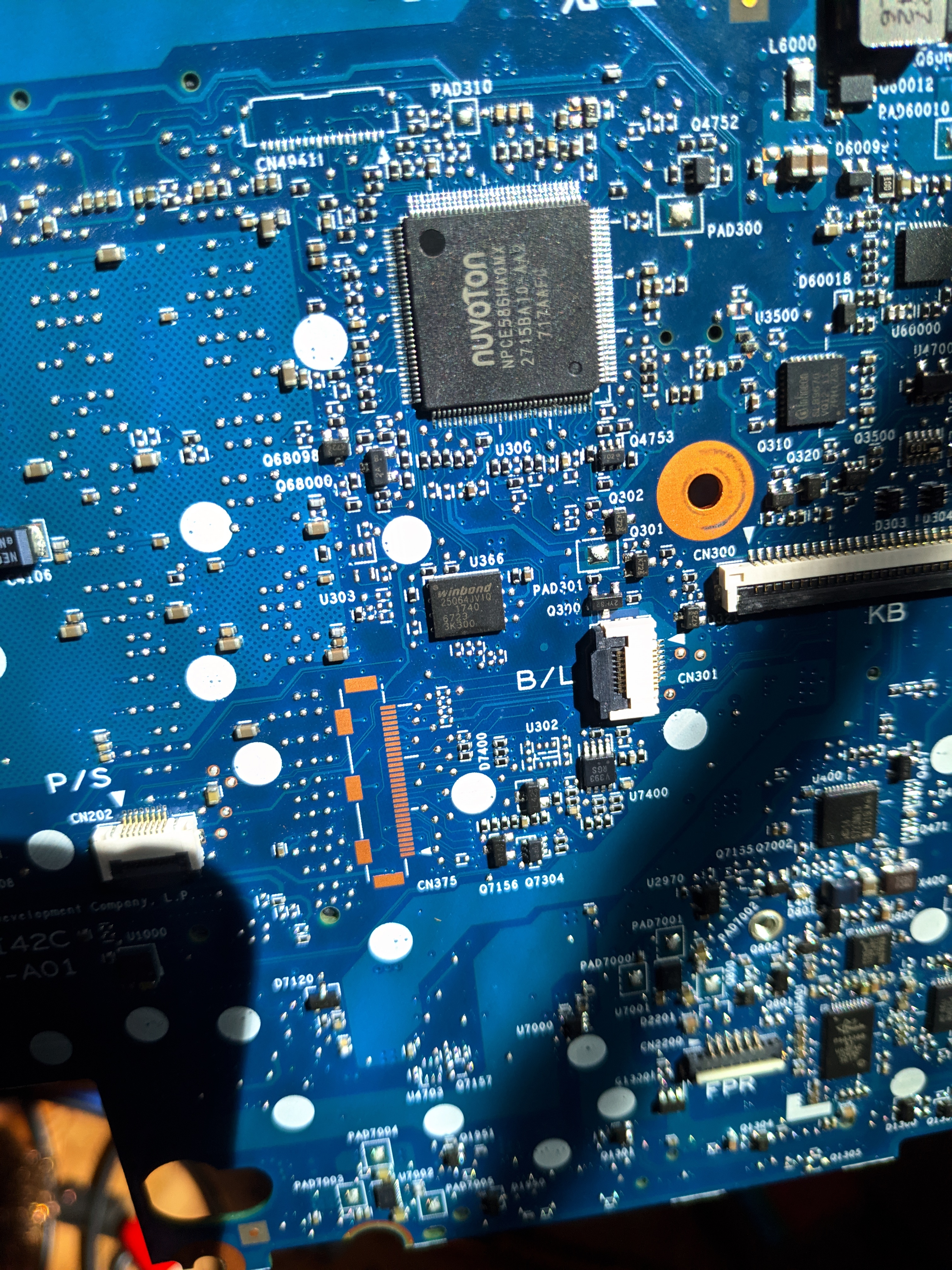

        Originally posted by mon2
        1) backup the entire flash before erasing or reflashing it
        2) share the top side pics or part number of each flash. Then review the datasheets. The larger density flash is the one that will be the main bios. Other is the ec bios.
        3) start with the main bios - be sure the voltage is correct for your flash and programming tool else the flash can be killed.
        I have these two
        • mcplslg123
          • Jun 2015
          • 7262
          • india
          25Q128 is the main bios

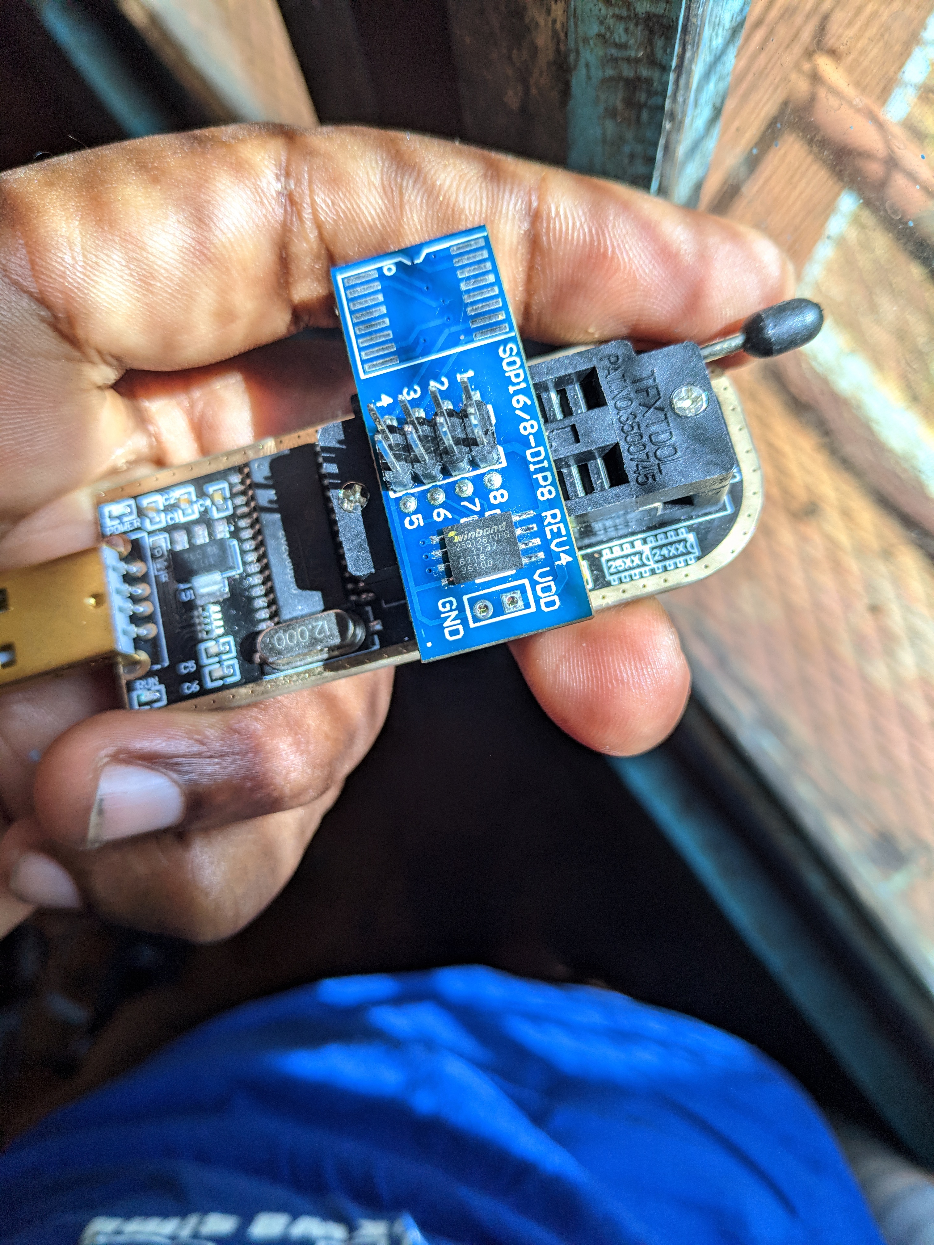

          • sarry86
            • Jun 2021
            • 90
            • Tanzania
            Thanks, I tried erasing it, blank verify all went smooth, I can write the bin file to it but I get error when verifying after flashing it, could the chip be fault?

              • mcplslg123
                • Jun 2015
                • 7262
                • india
                It could be the chip itself is bad but woth updating the software for your programmer. Which programmer you used?
                • sarry86
                  • Jun 2021
                  • 90
                  • Tanzania
                  I use CH341A

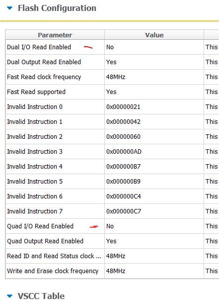

                            • 21844
                            Don`t worry about the QE bit .
                            840 G3 flash configuration
Name:	840 G3 Flash Configuration.jpg
                            • piernov
                              • Jan 2016
                              • 4439
                              • France
                              "Quad Output Read Enabled" is set to "Yes" though.
