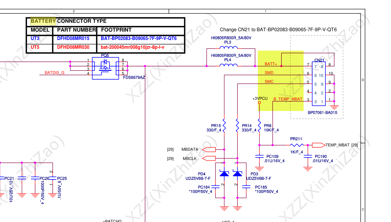

    Compaq CQ61
    I have charging problem the system detect battery but it won't add to the battery and the battery will be discharging.
    pls help me

    Is the battery old? Are you able to check the # of charge cycles on the battery? The power adapter is the original and suitable for use with this laptop?
    If there is a doubt on the above details of the battery - test with a known good battery first.
    Do you have a multimeter to check on the voltages? If yes, meter in dc volts scale (20v or higher is ok). Carefully measure the voltages to ground on each pin of the battery connector while the power adapter is attached to the logic board.

      DA00P6MB6D0 have different charging ic it use rt8206b
      The problem is it will show charging on the desktop but the battery is not adding and the charging indicator show light.
      There are voltage on the battery terminal... Pls help me
