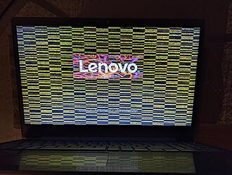

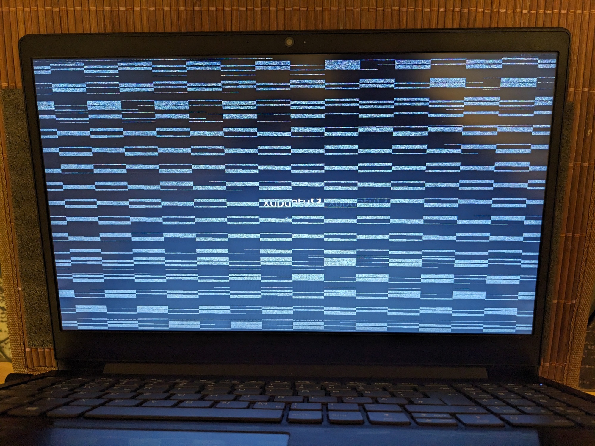

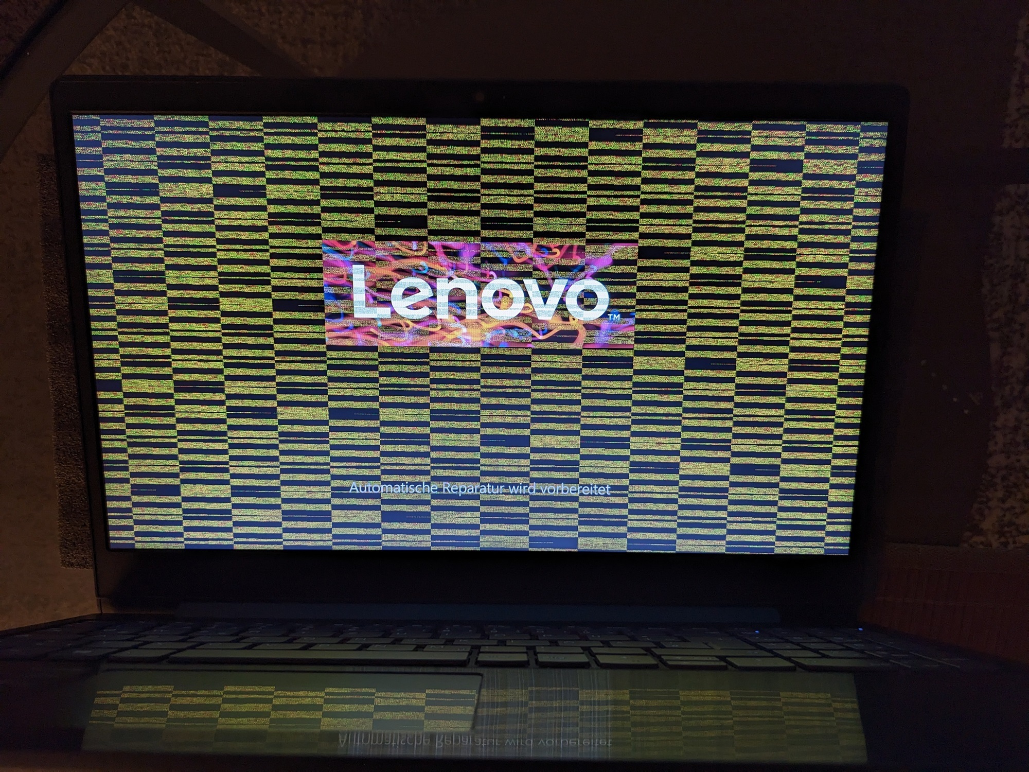

    Lenovo Ideapad S145-15IIL RAM problem
    I have a strange problem with an Ideapad S145-15IIL (nm-c711). This computer has 4 GB of RAM soldered to the board and works absolutely fine as long as the additional SODIMM slot is not populated. When additional RAM is inserted then sooner or later the machine will freeze and show glitches on the screen. Mostly happens in Windows but can also happen in BIOS and also happens when booting a live Linux. Most times it happens straight upon booting the OS but sometimes it works for some minutes before it crashes.
    I tried different sticks of RAM, checked the slot and its connections, flashed the BIOS... but nothing helped.
    What I find strange is that I never get bluescreens, it´s always graphic glitching that looks like VRAM errors. The laptop does not have a discrete GPU, it is integrated in the CPU (i5-1035G1).
    Any ideas for possible causes and things I could try to fix it?​

      Since there is no issues with onboard ram and issue arises only with ram slot,very likely the slot itself is defective(cpu memory controller should be ok as its working with onboard ram). The best idea is to use a ram slot tester.

        RAM slot looks okay though. No corrosion, nothing bent. I checked every single pin is soldered solid. I´m not ruling out the CPU yet, maybe a cracked solder ball corresponding to DDR channel A (the slot).
        Another thing that seems strange but might be normal: I checked resistance to ground and voltages on all coils. CPU coils (PL3400, PL3401) read 128 Ohm and voltage can be up to 1,6 V. Both values seem quite high to me. But I don´t know unless someone with the same board can confirm this.

            Yes, the onboard RAM is stuck down with black glue. Putting pressure on the RAM stick or rattling it never really changed anything.
            I have now resorted to re-soldering every pin of the RAM slot (to eliminiate possible cold solder joints) and the machine is now running for over an hour without the issue appearing. But I am still very hesitant to call it a fix. Will need to leave it running for some time and run some tests.
            Still don´t understand (if it was bad connections) why it never resulted in bluescreen errors but always graphical glitches. Is that expected behaviour?

                            Laptop has just passed two complete runs of Memtest86 without errors so I might call it fixed for now, even though I have changed nothing since the last time the fault occured. Strange one. Thanks for your help, guys!
