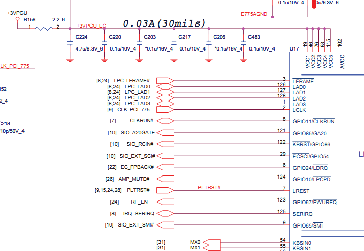

    Dear All..
    Received with Condition power on but no display, on my DC Bench Supply only 0.780 A. Everything look's like get power except ATI GPU still cold when I touch with my finger. All I have done :
    1. Flash Bios ( grab it from toshiba web )
    2. Change CPU
    3. Reballing ATI 216-0810028
    4. Reballing Intel HM76
    5. Resoldering every Caps, Coil and PU
    With no change, still same at first condition 0.780A but without memory the current raise up to 1.250A. Working without schematic, can't find schematic for this type DABY3CMB8E0 REV:E - Model : BY3C. Any help would be appreciated

        Attach post card to LPC, google for "WPCE885L pdf", you should find some shcematics which might be similar. The LPC test pins might be on wlan minipcie socket also. Upload backup of original bios. The discrete GPU might not be in use at first - hence no power supplied to it.

          Thank's khaahk. Actually I have no Post Card yet (WTB )
          And it's NUVOTON NPCE885LA0DX on board C840, google it and just find one quite similar ZQTA-ZQSA Board that I don't know what laptop is, here is I attach original Bios and from Toshiba web

            Re: Toshiba Satellite C840-PSC6EL need Help..!
            Regards
            ZQSA is the board number for Acer V3-471G.
