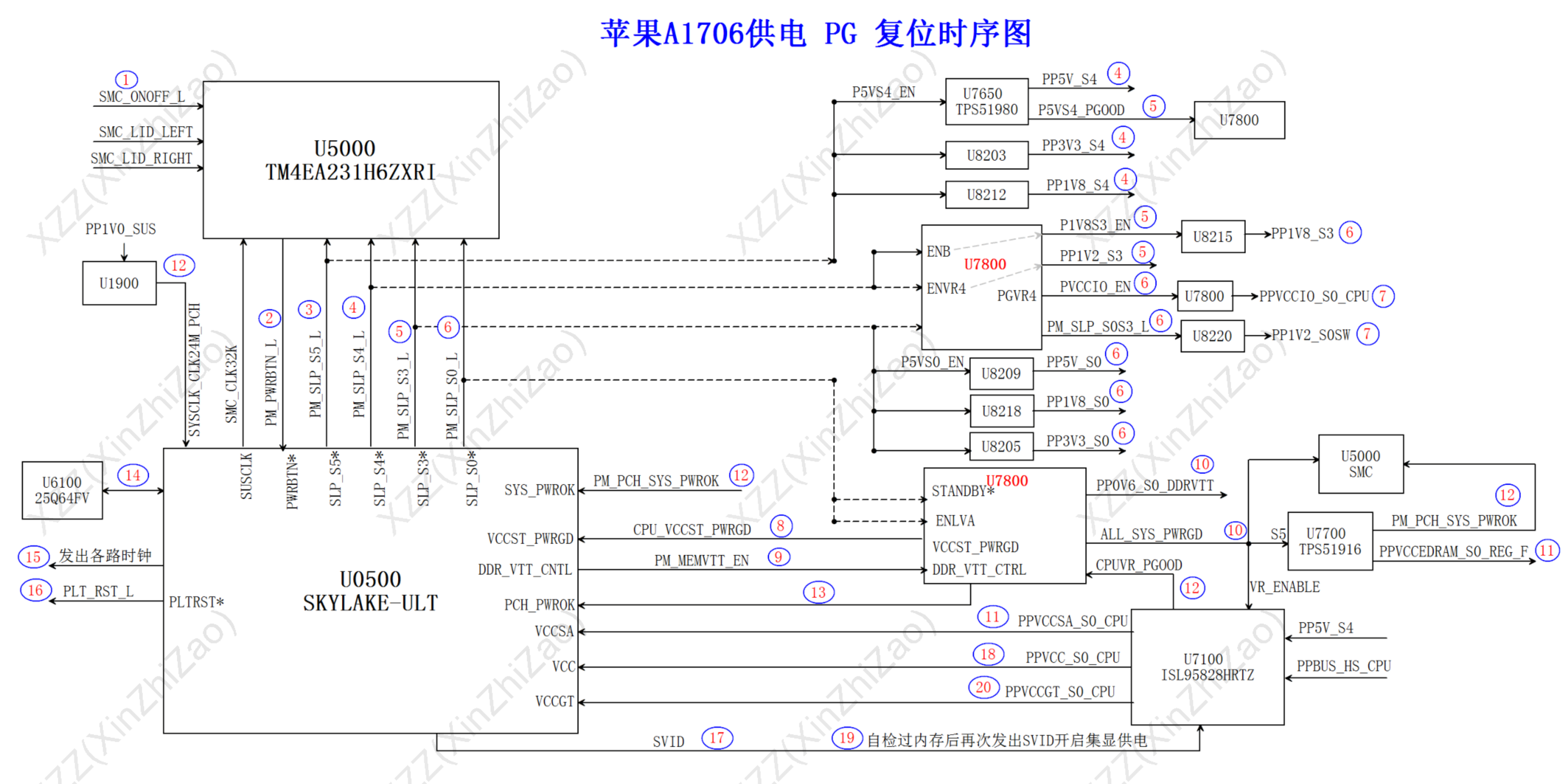

    a1706 820-00923-A. CPU hot No boot
    hello I am asking for your help on an a1706 820-00923-A.
    The CPU heats up
    PPVCC_S0_CPU=1.07V
    no change after 10s
    voltage at charger 20V 0.6 to 0.89A varies
    I did the tests with the motherboard outside the chassis
    No trace of corrosion found either.
    THANKS​

    What is the voltage to ground of PPBUS_G3H ?

      PPBUS_G3H​=13.22V

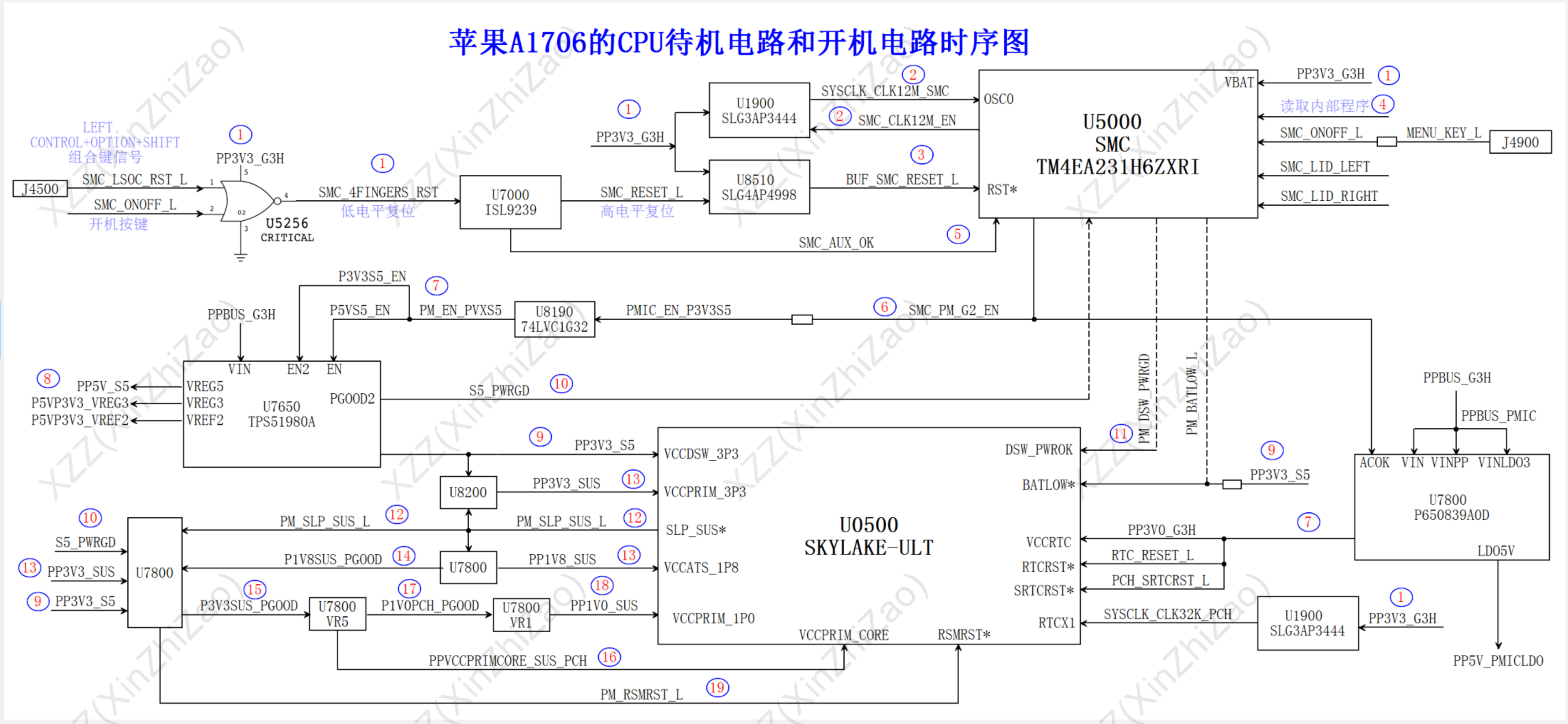

        Remove all power. Measure the resistance to ground of each and every inductor for a review. If the resistance is too low, that power rail will not powere up due to the current sense resistor observing a larger than usual voltage drop = excessive current draw so shuts it down. You will need to review which rail is not powering up.
        Study the power up sequence that is attached.

          I just took the measurements and couldn't find any shorts.
          PP5V_s0= 5.02v
          pp3v3_s0=3.38v
          pp1v8=s0=1.82v
          PPVCC_S0_CPU=1.07v
          PPVCCGT_S0_CPU=0V 1.7ohm​

            Hello
            I think that the 19 svid sequence is not working, how can I test this part?
            Svid=vidsclk ?
            • azemar
              • Nov 2022
              • 46
              • France
              Does anyone have an idea where I can do other tests?
