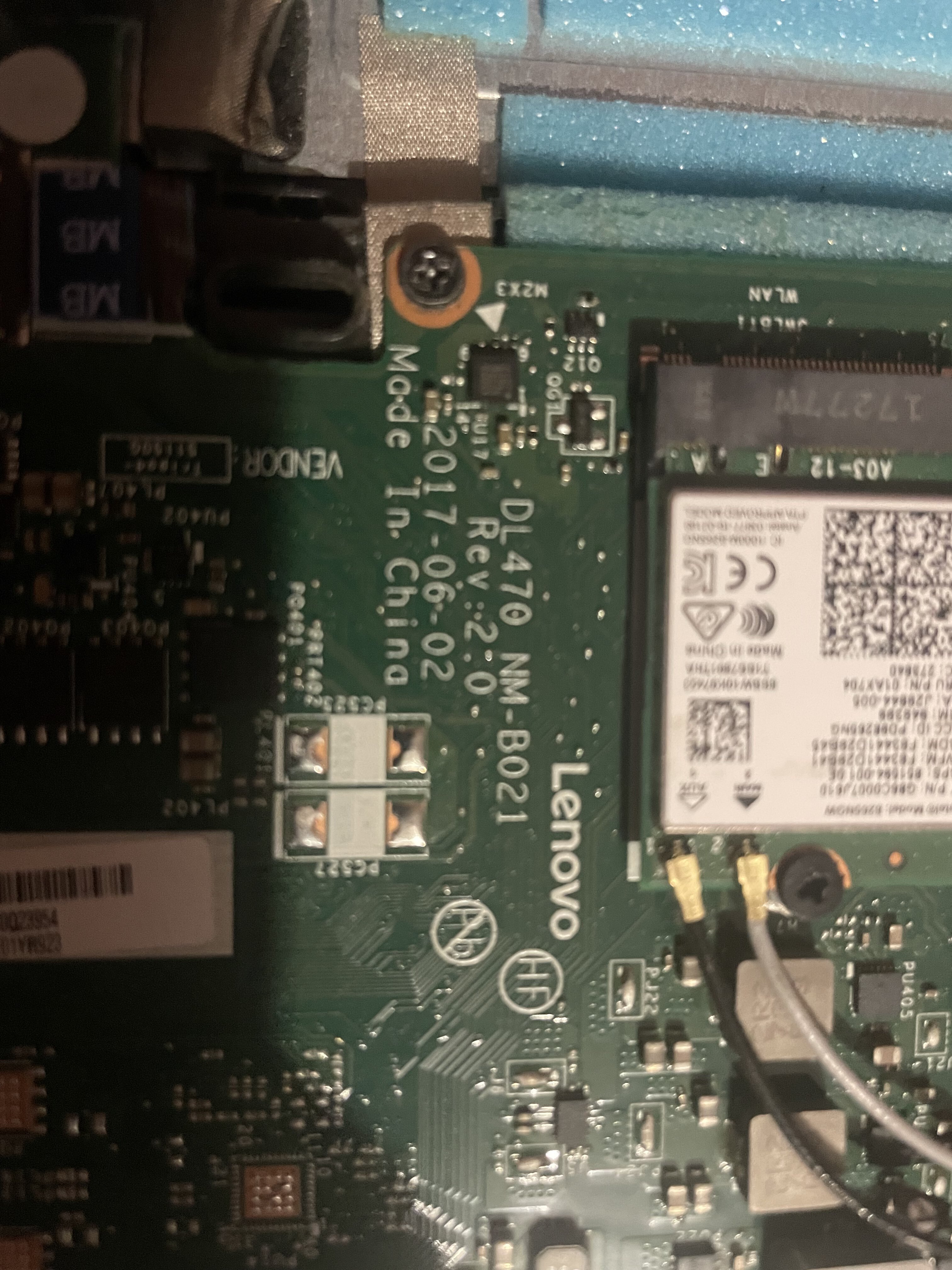

    Hello friends, I have searched the internet to the last pages on google, and I can't seem to find any information regarding a BIOS recovery for my Thinkpad L470, I was unknowingly updating the BIOS via windows and shut down the laptop.
    I need to know if there is a BIOS recovery method that I can use to restore this thing, when you press the power button its just a black screen, not even the backlight turns on.
    This is pretty much all info I have regarding the laptop model/serial number etc...​

    I believe you will have to use an external programmer to remove the original bios chip -> reflash it and solder it back on to fix this case. Best to post the same question in the dedicated bios forum.

      Could you confirm if something like this would do the trick?
      https://www.takealot.com/eeprom-flas...t/PLID90431302
      will probably only use it once so I don't want to buy the wrong thing

        Yes, I think this programmer is suitable but do wait on others to share their comments before proceeding. From a quick review of the schematics for the NM-B021 board, the flash memory chip that is of interest resides @ UC16M1. This appears to be the Winbond W25Q128FVSIQ device and is a QSPI (Quad mode SPI device). Respectively, you will need to either purchase a spare flash memory device that is of the same type or consider to reflash the one that is onboard. Personally suggest to buy a spare one to experiment with. They are not expensive from Digikey / Mouser. In my paid database service, found the flash memory chip dump for this model. This flash chip operates @ 3v3 volts so it should be straightforward to use the referenced programmer. Be sure to first check the programming software to confirm it can support this flash device - 99% sure it is possible. We recall writing our own programming s/w to operate in SPI and QSPI mode to benchmark against the Spansion brand a few years ago.

          I checked stock on the mentioned retailers, there seems to be 0 stock on any of them. Best I could find was eBay at almost 4 times the price. I think it's best I just try flash the onboard chip, the laptop was forgotten about regardless and it fails, it wont be the end of the world, then I might purchase a new one.
