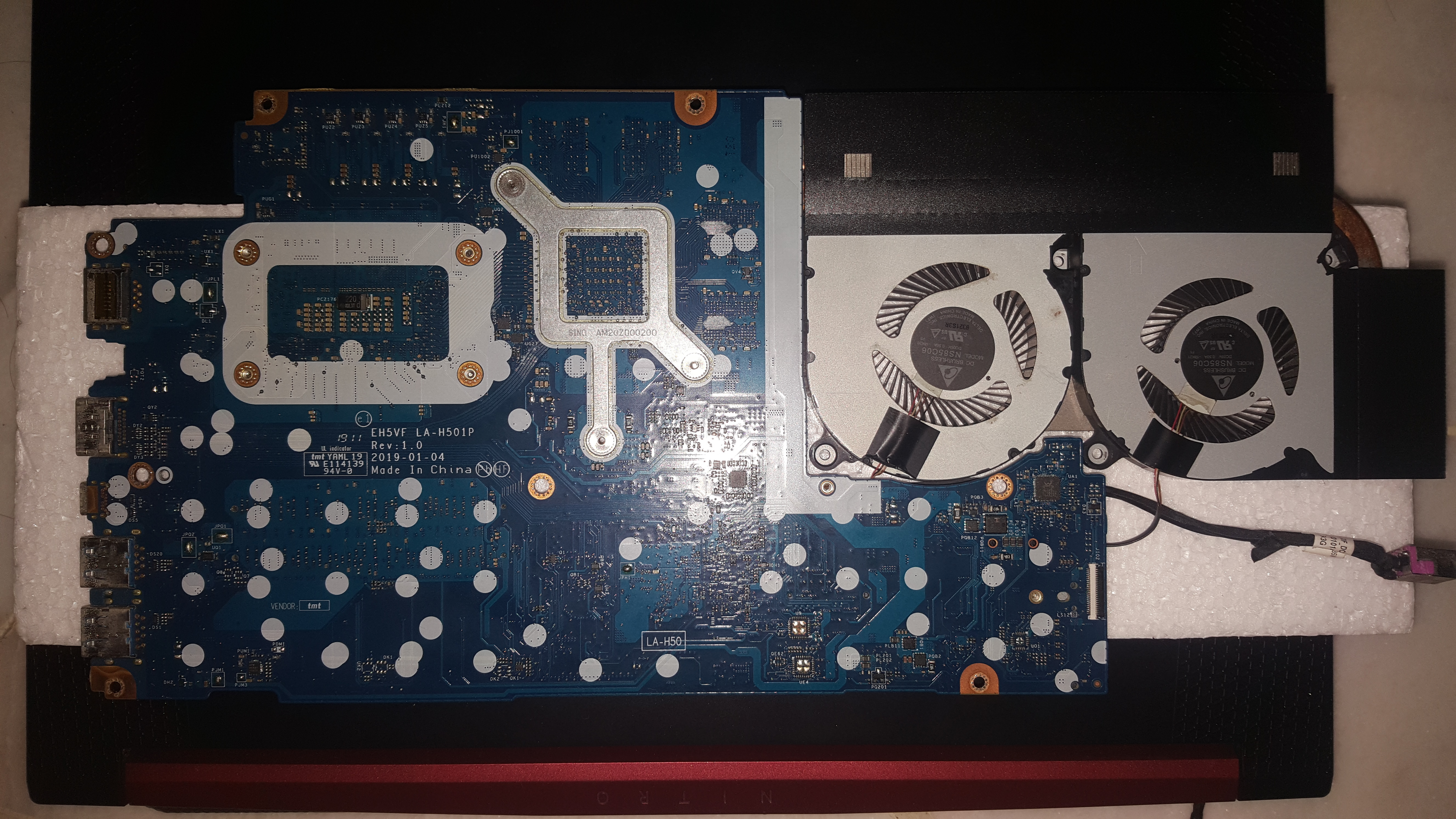

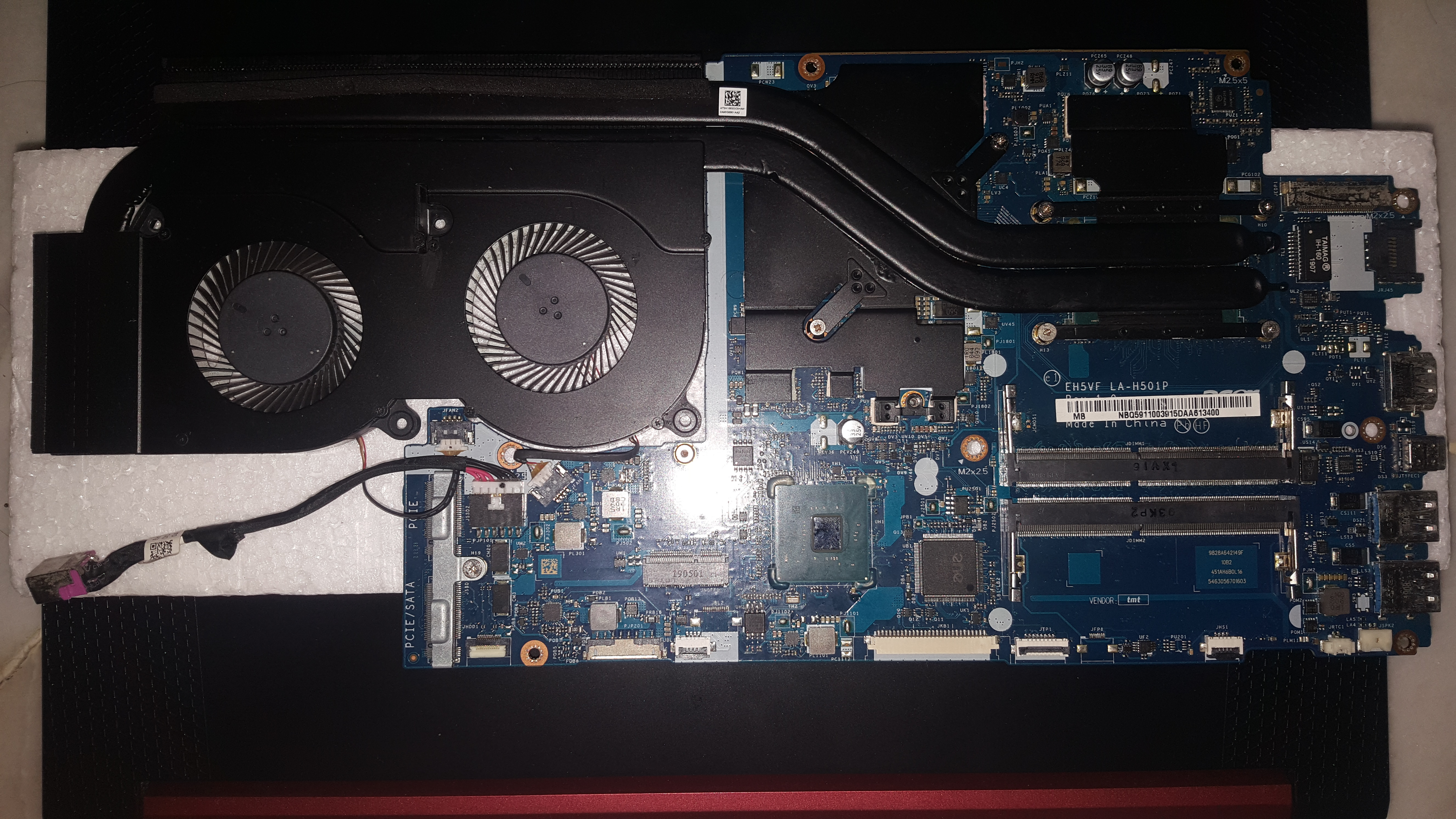

    I have an Acer Nitro 5 AN515-54 no charging indicator and not powering on via AC. Battery is totally dead (0V) and I'm in the process of getting another battery that at least has some charge left in it.
    I have no idea where to start so without plugging in battery and plugging in AC, I measured main voltage rails with my analog multimeter. i've also attached boardview and schematics for this motherboard.

                      I've also noticed that this metal bracket for the NVME slot getting quite hot for no logical reason whenever the AC adapter is connected.
                      Edit: I've also just noticed that PUB1 (ISL88739AHRZ) gets very hot and is burning to the touch. Could this be the issue all the other inductors aren't getting power?
