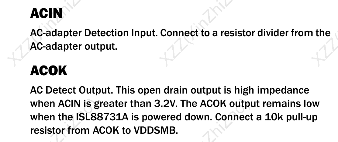

        #43
        This last measurement confirms that the charger ic does not like the adapter voltage so ACOK is being pulled to a logic low.
        Concerned about the LDO voltage at ~4v when it should be ~5 volts.
        what is the voltage to ground of pin#20 (vdd) on this ic?
        confirm that the chip is soldered properly. At the start of this thread, the dcin mosfets had the boosted gate voltage so back then the adapter was deemed to be ok. Are you using the same power adapter? Do you have another adapter compatible for this machine?
        if the acin voltage is high enough, only then will the asgate pin will supply the boosted voltage.
        Measure the voltage to ground on each of the DCin mosfets @ PQB11 and PQB12. Post each measurement for the source (1-2-3); gate (4) and the drain pins (5-6-7-8).

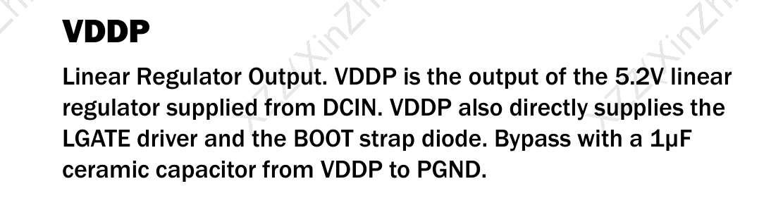

        Update:
        While the full datasheet for this specific charger IC is not available to the public - no idea as to why they do this but we can perhaps learn from other Intersil charger devices that may be similar.
        See attached = my bad, from this VDDP review - it is pin #20 that is the output of the LDO on these parts from Intersil. So proceed to check if VDDP is ~5 volts as it is on other devices from Intersil. Then remove all power and confirm the resistance across the resistor @ PRB21 which should be ~4.7 ohms.
        Click image for larger version  Name:	adapter_conditions.png Views:	0 Size:	38.5 KB ID:	3205805
        Click image for larger version  Name:	vddp.png Views:	0 Size:	24.7 KB ID:	3205806

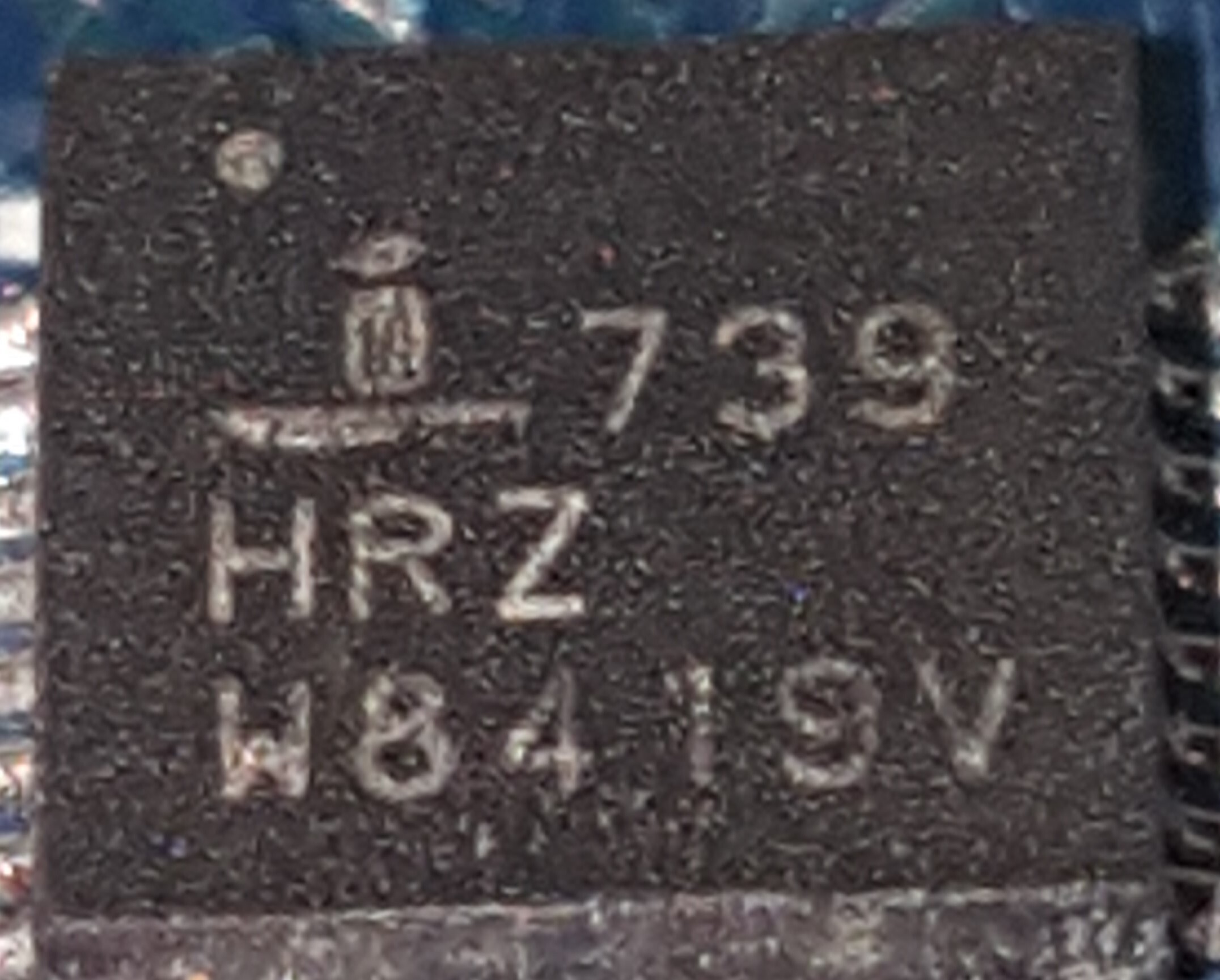

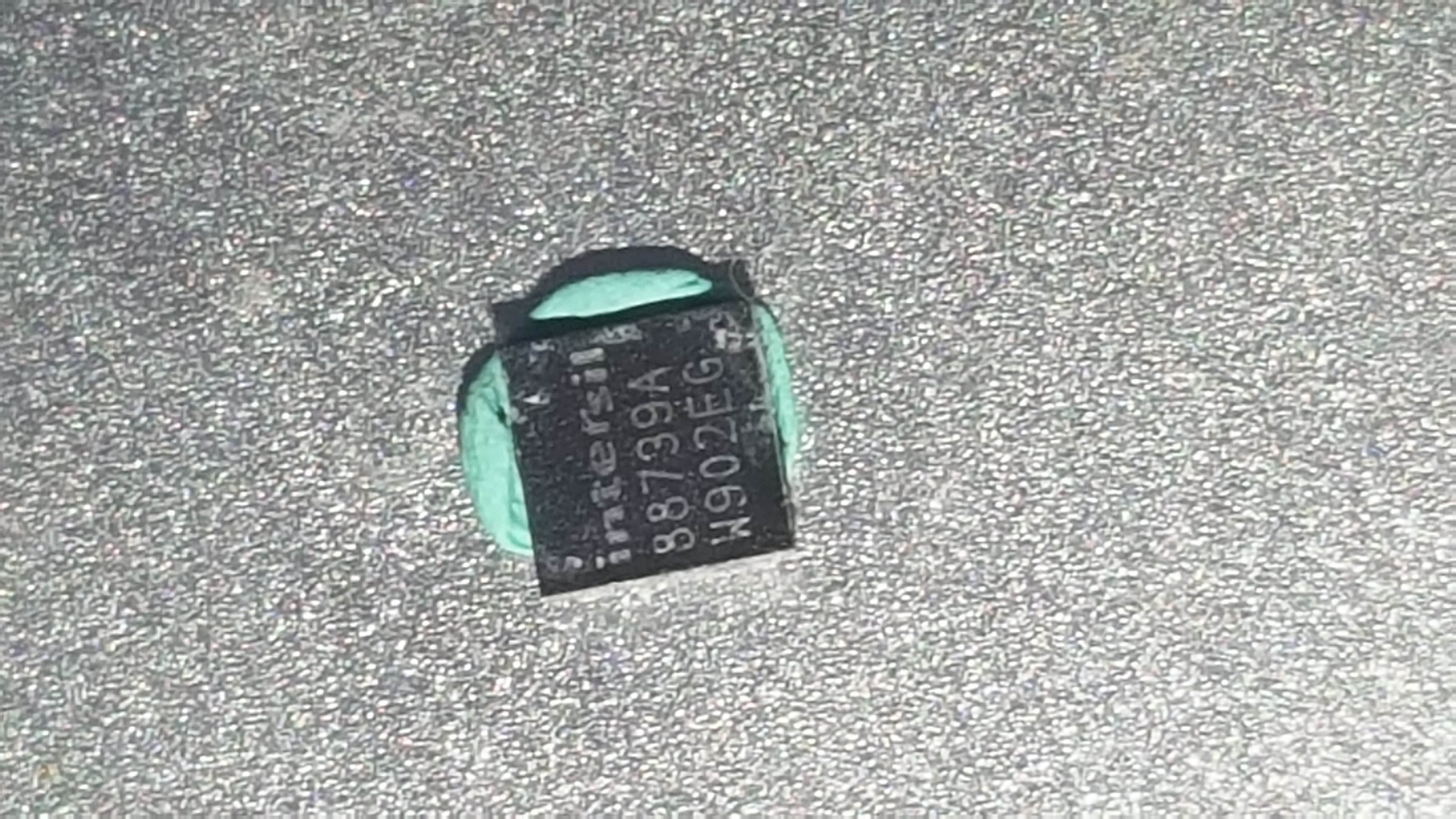

          I've reapplied solder on the charging IC pins and they now look fine on all four sides. I'm now getting 5.32V on both pin #19 and #20.
          Yes, I'm using the same factory adapter that came with the laptop itself from the beginning of this thread. Unfortunately, I don't have any other adapter that has the same barrel plug size even though they have the same output voltage but slightly different amps. I had thought of maybe swapping the female barrel jacks but unfortunately the connector size on the motherboard is different. The other adapters are all ASUS which for the negative conductor fits into the connector but the positive conductor is bigger than the one in Acer's barrel jack.
          The factory IC that came with this laptop has the chip marking "ISL88739AHRZ" while the replacement I bought has the markings "ISL88739HRZ", missing the "A". Hopefully there isn't any difference between the functionality / specs of this charging chip. I've looked up the datasheet on digikey and doing a side-by-side comparison kind of looks like there are no difference between them.
          I initially changed the charging IC because when turning on the adapter, the charging IC instantly became very hot and I suspected that it might be an issue.
          Factory IC:
          Click image for larger version  Name:	20240128_140019.jpg Views:	4 Size:	2.92 MB ID:	3205840
          Replacement IC:
          Update:

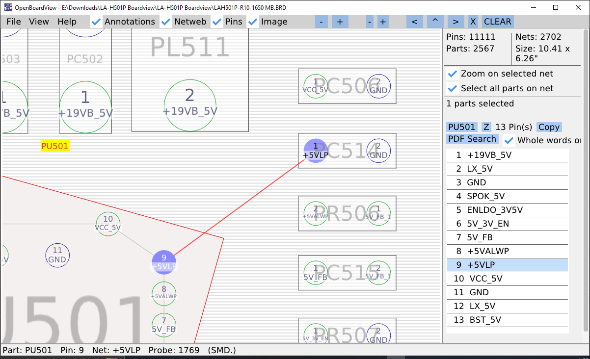

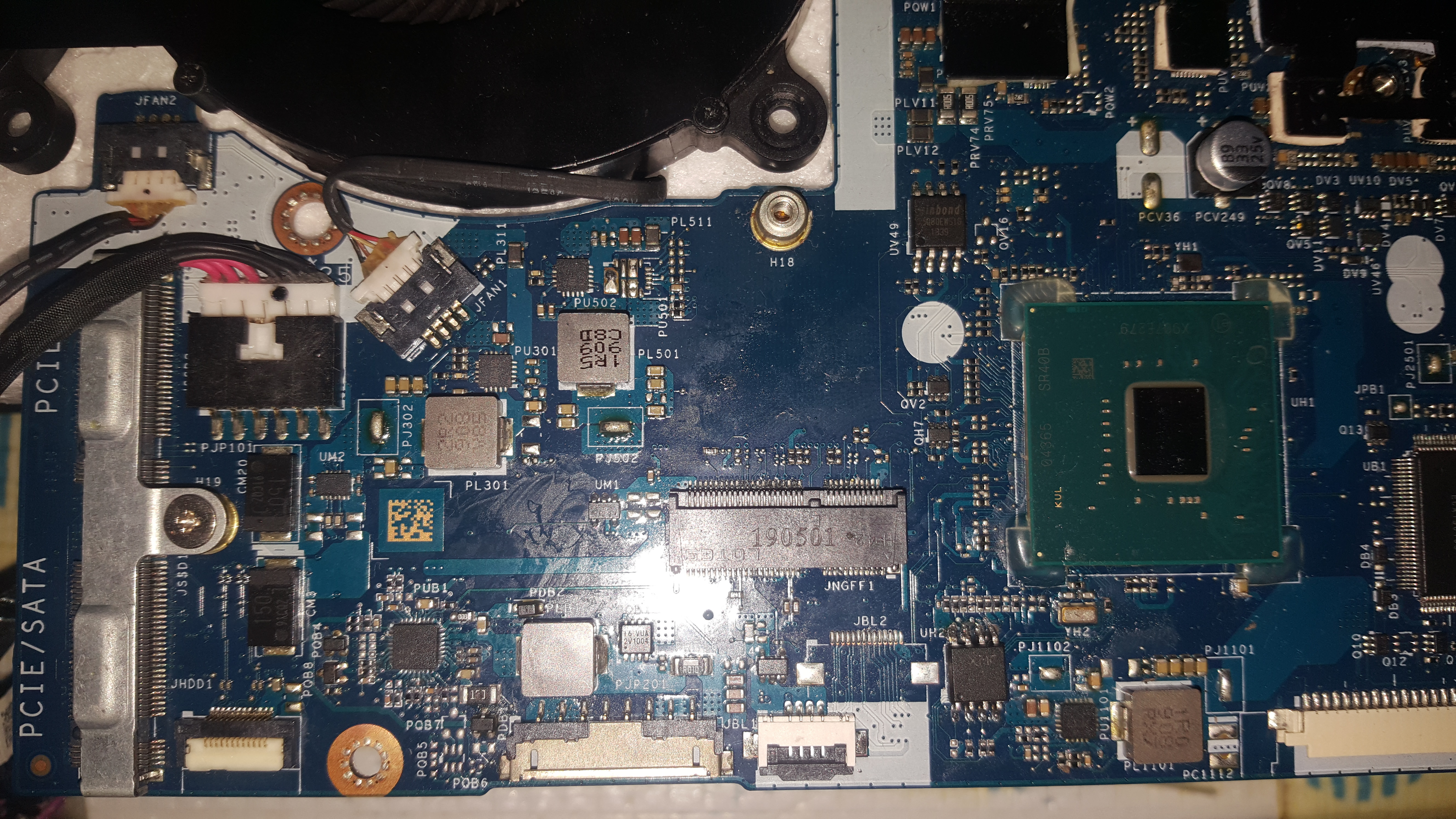

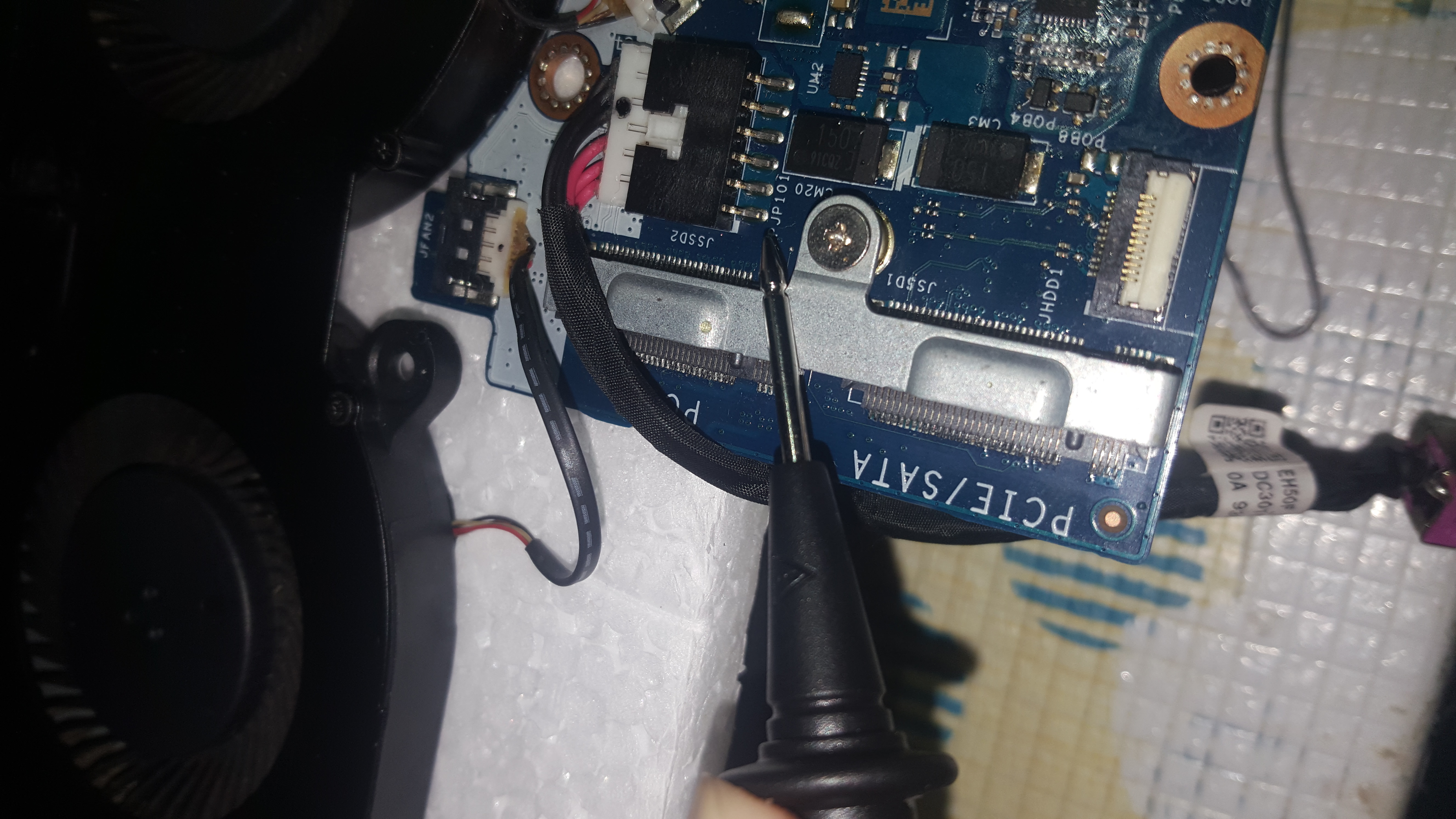

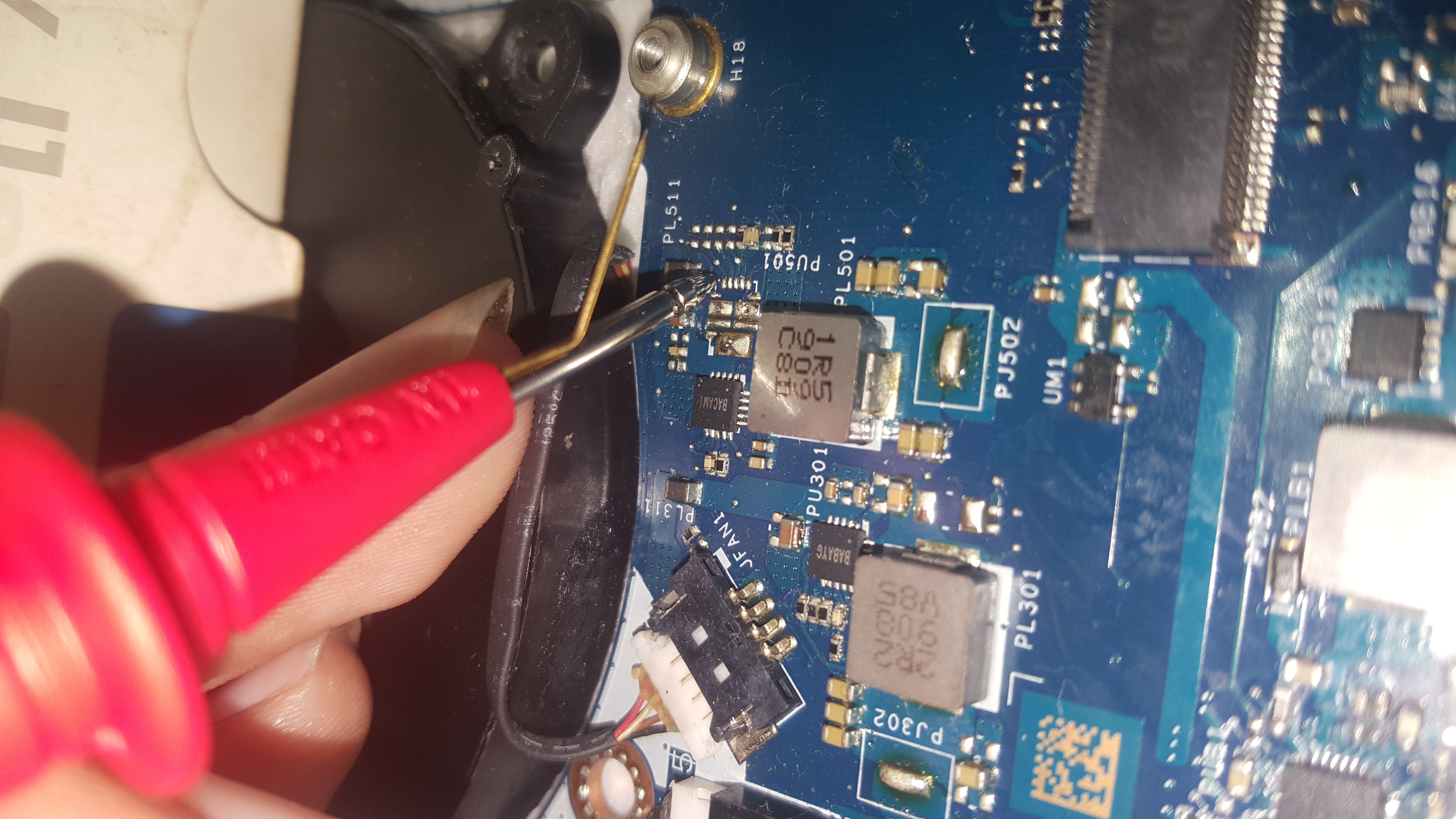

                          To confirm, check the LDO output pin with your meter in DC volts (10 volts or higher scale is ok since we know it should be 3v3 or 5v0) - black meter probe to ground; red meter probe on this LDO output. You must have a stable voltage reading here. If not, the regulator is defective. We know that the motherboard is wanting to turn on the LDO rail but the output rails are not to the specification.
                          • Growtopia Jaw
                            • Aug 2023
                            • 36
                            • Malaysia
                            #53

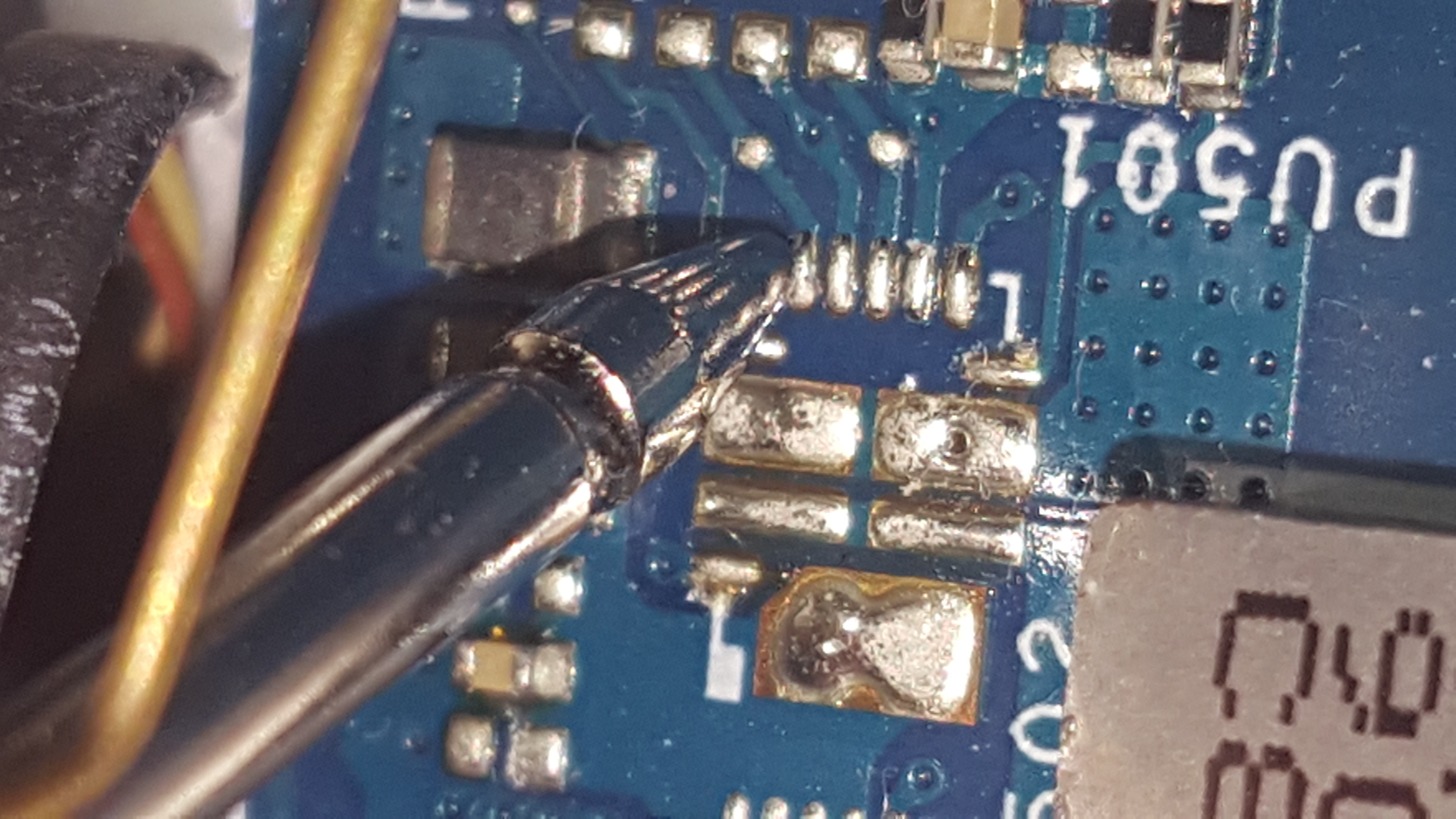

                            I measured PU501 like this, meter in DCV mode -> turn on and connect adapter -> black probe on GND -> red on pin #9 PU501. I've also measured the same linked lines of pin #9 just to confirm whether the readings are consistent (See yellow marked box below for same lines of PU501's pin #9). As before, I got "No reading" for said pin.
ID:	3206183 Original unedited image: Click image for larger version
                            Procedure:

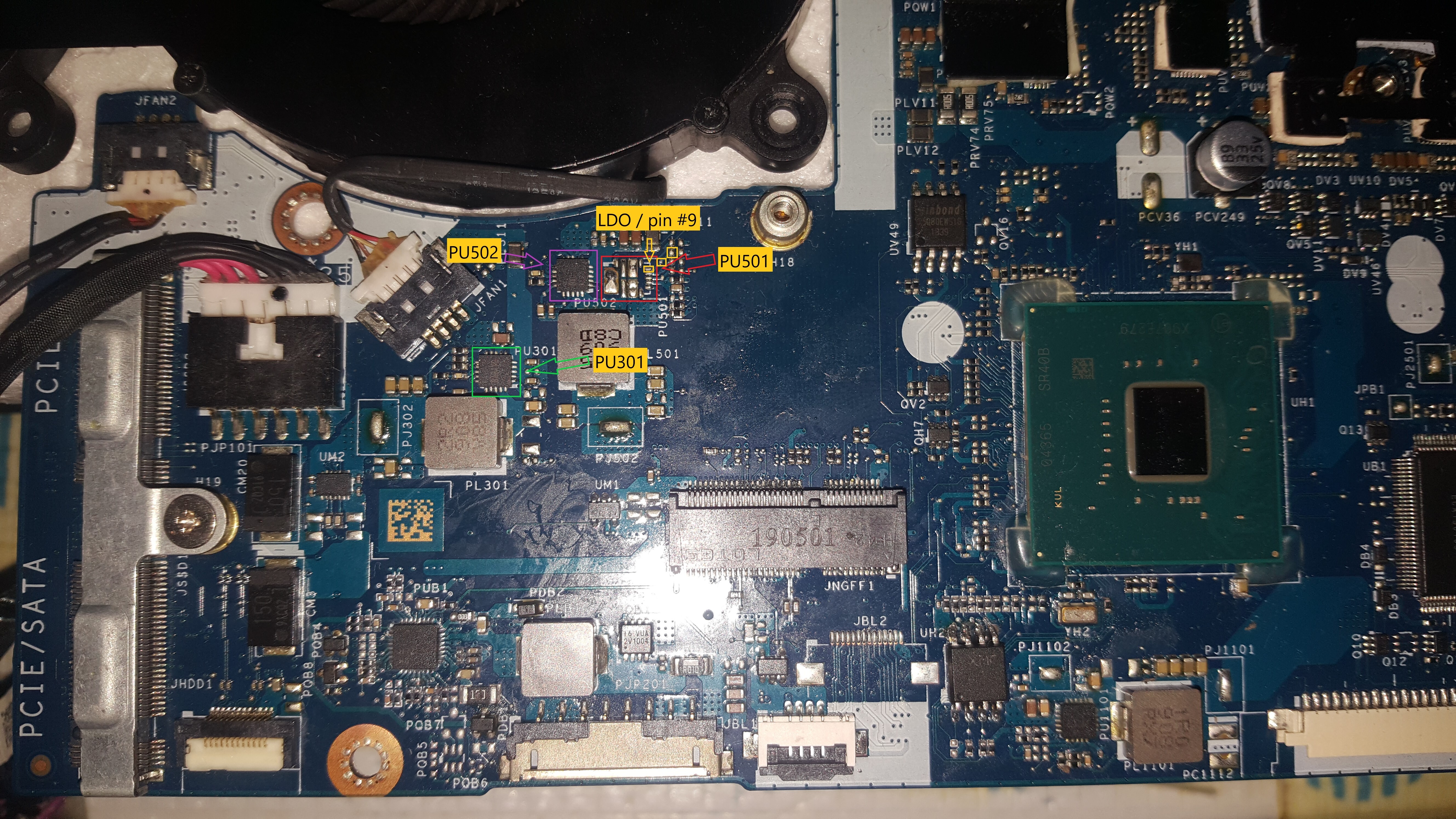

                              Good pics. It appears that PU501 is not even stuffed on this board build. Instead, PU502 takes the place of the PU501 device. Proceed to measure the LDO rail @ pin # 14 to ground on PU502. Also measure pin # 15 on PU502. These should be ~5 volts if the LDO is working.
                              • Growtopia Jaw
                                • Aug 2023
                                • 36
                                • Malaysia
                                #55
                                PU502:
                                pin #14 = 0V
                                pin #15 = 4.9V
                                • mon2
                                  • Dec 2019
                                  • 14631
                                  #56

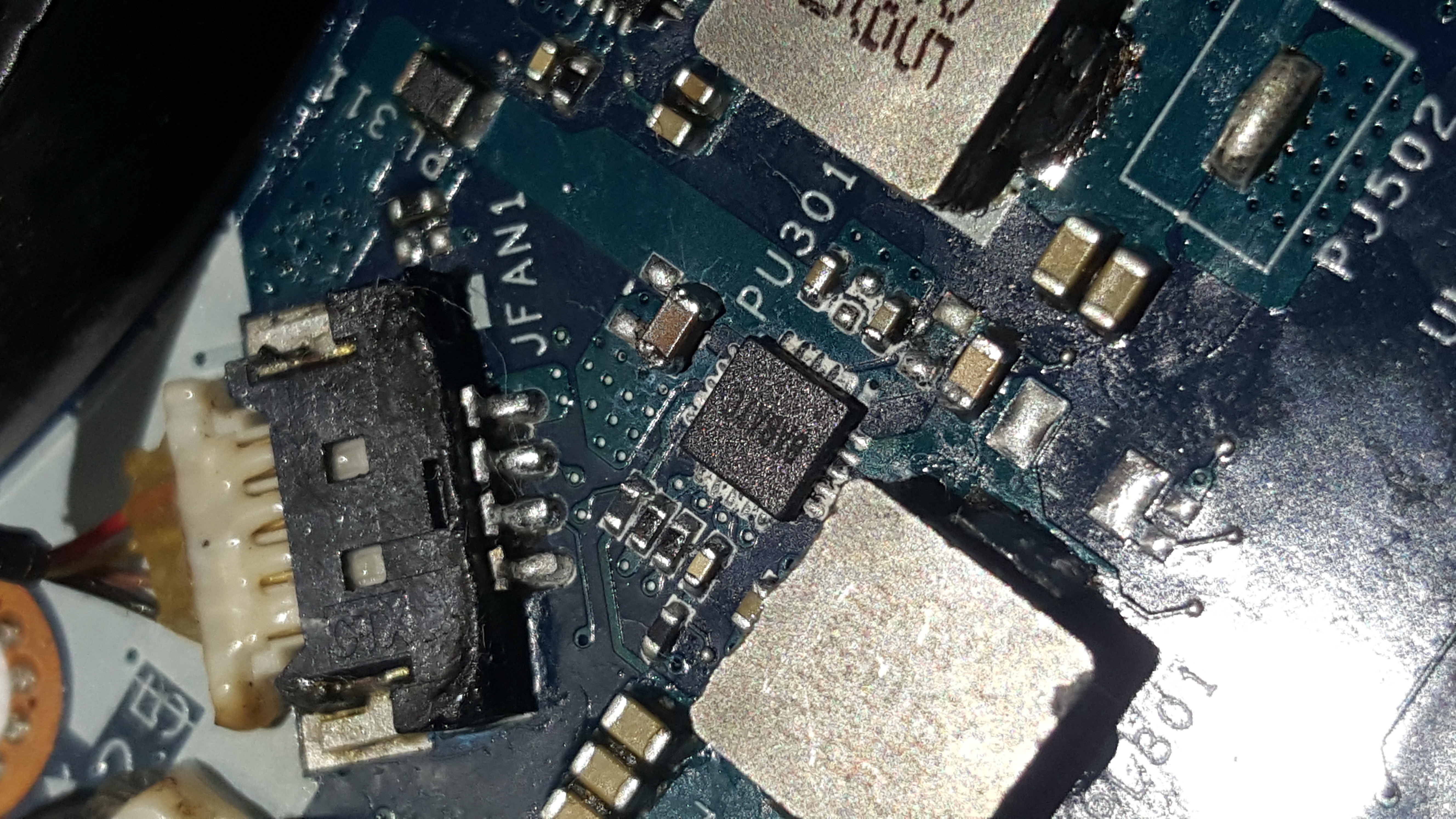

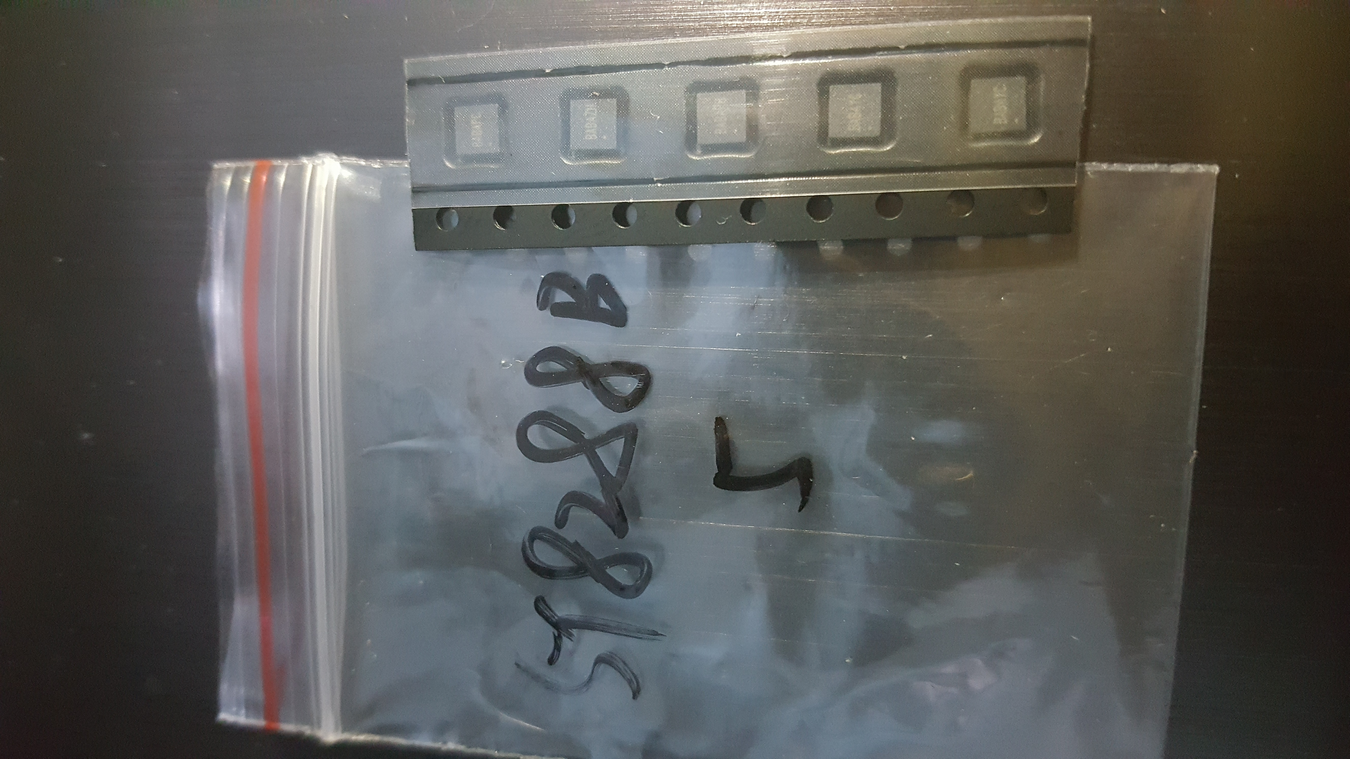

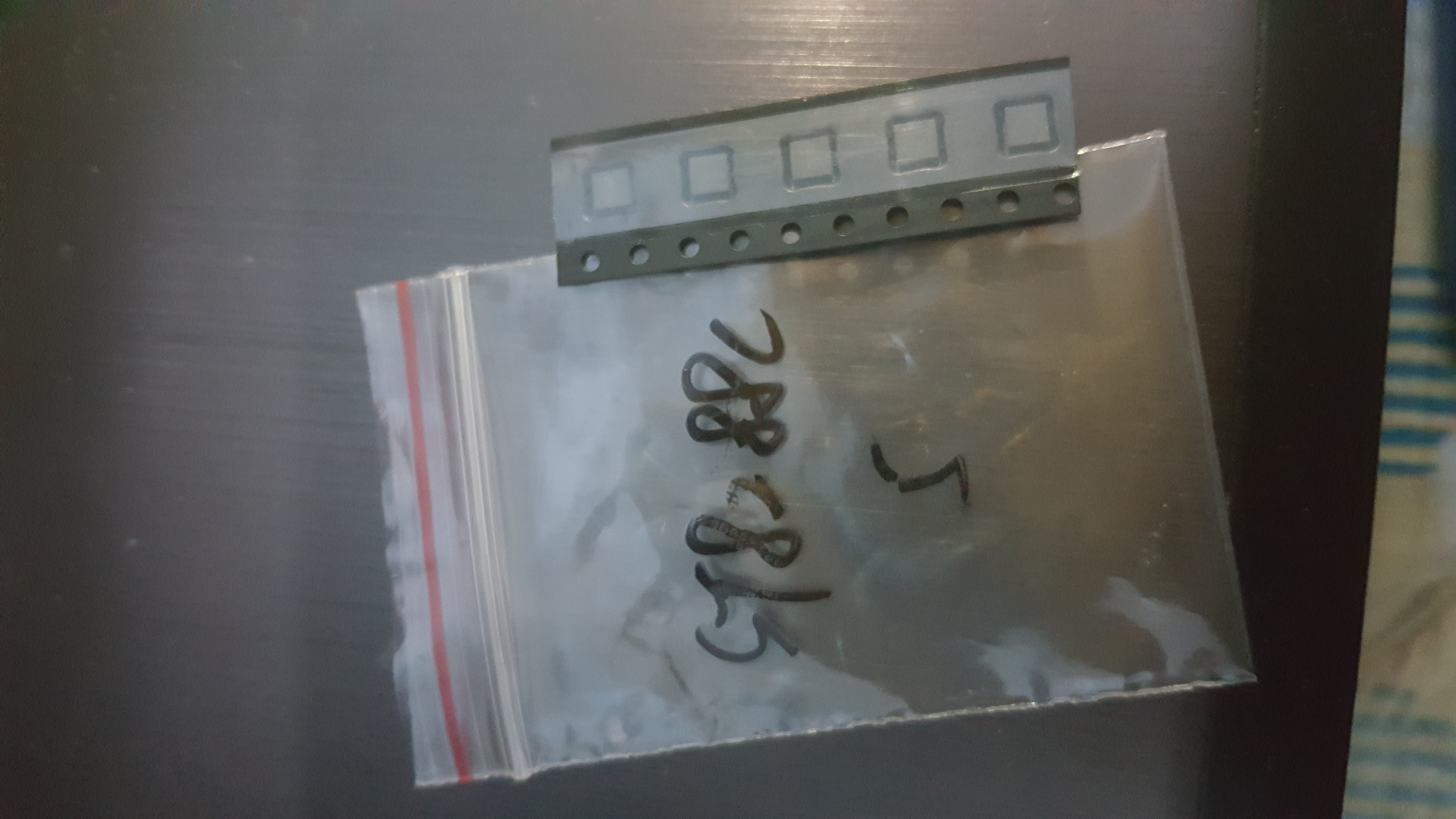

                                  Good. To me, at this time,summary is that PU301 is defective since the LDO enable pin for this regulator is a logic '1' yet the LDO output is not 3v3. If the resistance to ground of this LDO is not too low - it must function unless it is defective. This +3v3 rail is required to power the EC controller which is often a 8051 microcontroller used for the keyboard scanning and other tedious functions (RTC, etc.) -> only if the EC is powered and working will the LDO for the heavy current rail +5VLP_5V_8A on PU502 be enabled. Since the EC is not being powered, it is to be expected that pin # 14 on PU502 is @ 0 volts.
                                  If you are shopping on Aliexpress, consider to order a few spares of PU301 and even a few pieces of the PU502 which should be inexpensive. However, it appears for now that PU502 is not defective.
                                  Do pay attention to the full suffix of each part as it is important. I think that your charger IC is ok since the boosted voltage @ ASGATE is present. but if you are shopping - consider to pick up a few of the charger IC with the 'A' suffix (apparently there is even a version with a 'B' suffix - no idea on the differences). I think the SUHMS store has these parts or review if you have a donor board to borrow from. Just pick someone with a high positive scorecard. Do post your updates.
                                  • Growtopia Jaw
                                    • Aug 2023
                                    • 36
                                    • Malaysia
                                    #57
                                    Sorry for the really long wait. I've ordered the chips SY8288BRAC_QFN20_3X3 (PU301) and SY8288CRAC_QFN20_3X3 (PU502) as recommended and it took about 2 months to arrive. Just had it soldered on just now (PU301). I haven't soldered on PU502 yet.
                                    • mon2
                                      • Dec 2019
                                      • 14631
                                      #58
                                      Looks good. You can use IPA (alcohol) with a cotton bud to remove the white residue around the joints.

                                        Good morning, I know this topic is old, but I have the same problem, I would like to ask a question.
                                        I will buy the pu301 and pu502 components,
                                        My question is whether the two are the same component, since in the electrical diagram the numbering is the same for both (SY8288CRAC_QFN20_3X3).
                                        And the most important question is whether the repair worked.
                                        thanks​
                                        • piernov
                                          • Jan 2016
                                          • 4437
                                          • France
                                          #60
                                          SY8288B != SY8288C
