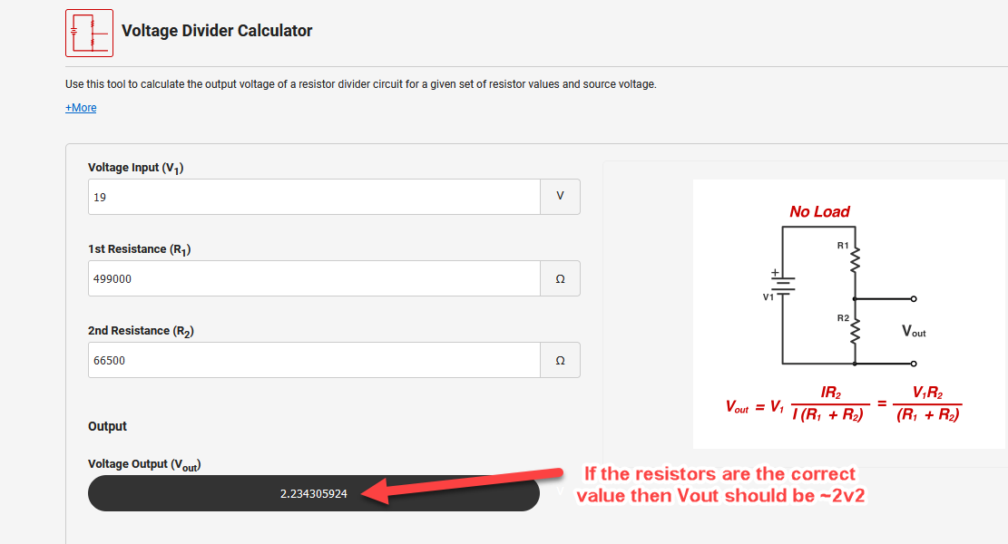

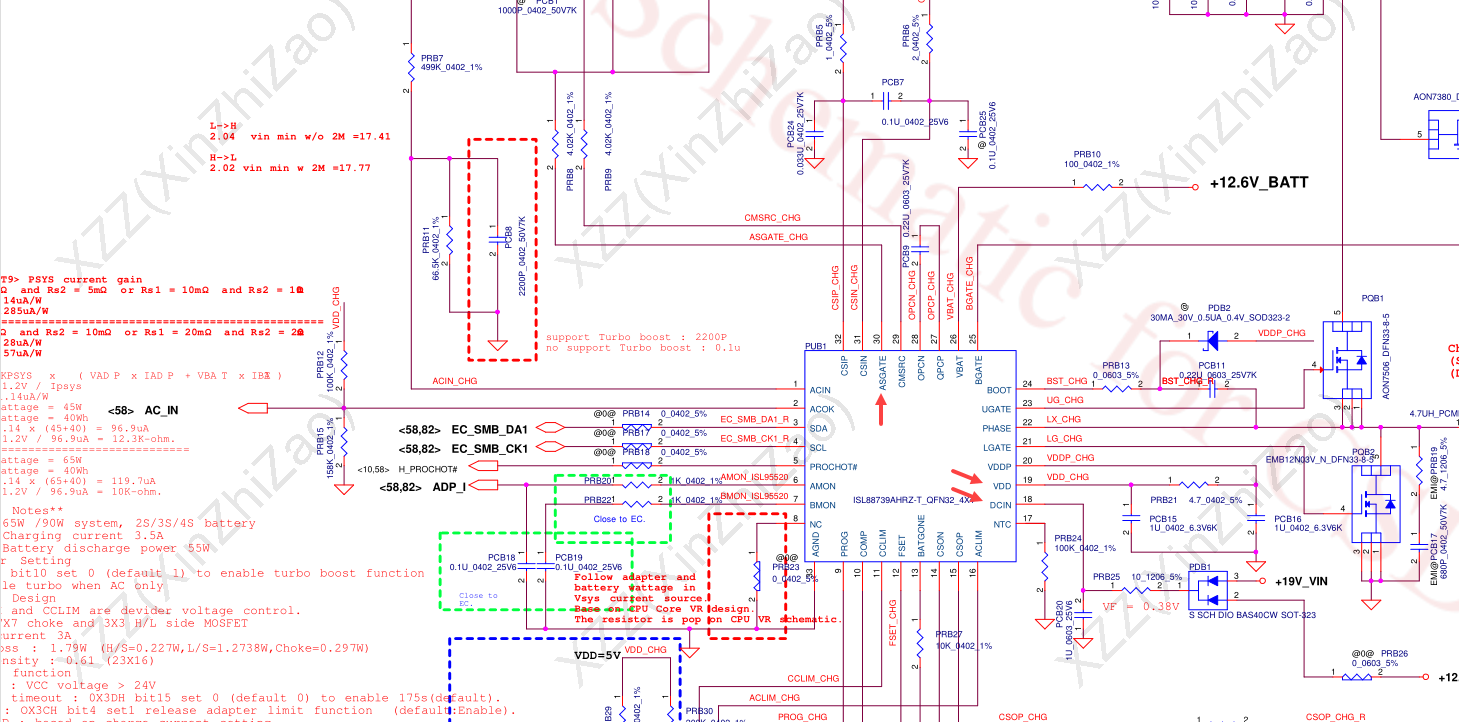

      ACIN is too low. This is a voltage that is created by the resistor based voltage divider @ PRB7 and PRB11. Together, they will accept the high adapter voltage of ~19 volts and lower it to a safe value for the charger IC. If this safe voltage is higher than the threshold, then the power adapter is considered to be worthy to power the logic board else the DCin mosfets will remain OFF.
      It appears that this ISL (Intersil) part wants a threshold of 2 volts or higher.
      Reference calculator:
      https://www.digikey.ca/en/resources/...oltage-divider
      Suggest to remove all power -> meter in a high resistance scale (higher than 500k ohms) -> measure the resistance across PRB7. It should be ~499k ohms. Repeat for PRB11 which should be ~66k5 ohms.
      Unless the ACIN voltage is above 2 volts, the charger IC will not offer the boosted gate voltage to enable the DCin mosfets. The mosfets are like gate keepers / mother-in-laws for the main power rail.

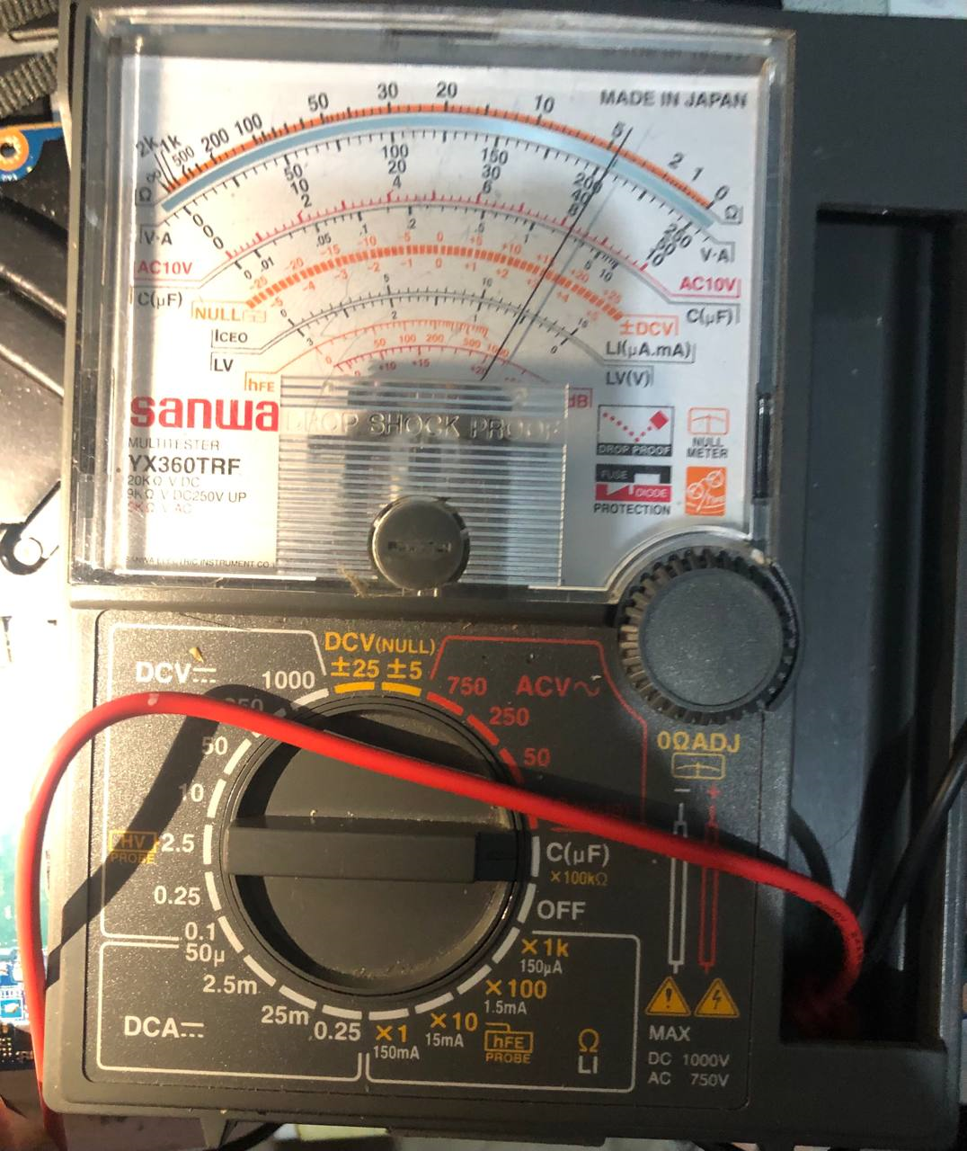

          Post a pic of the meter face for these measurements. Be sure that there is no power to the board during these resistance checks.
          PRB7: 450k ohm in 100k range
          PRB11: 60k ohm in 100k range​
          It is not possible to measure 450k ohms if the meter is in the 100k scale. This means the max resistance this meter setting can measure is 100k and all else will be reported as '1' = over limit. Then you must select a higher resistance scale on your meter. Also measure the exact voltage output of your power adapter. It must be ~19 volts or higher. With this adapter voltage and with proper resistors @ PRB7 and PRB11, you should have ~2v2 for the voltage at the output of this voltage divider. If it is under 2 volts, the charger IC will not function properly.

            I have an analog Sanwa YX360TRF multimeter and if not mistaken, according to its spec sheet
            Click image for larger version  Name:	image.png Views:	0 Size:	907 Bytes ID:	3183051
            source: YX360TRF | Sanwa Electric Instrument Co., Ltd. (sanwa-meter.co.jp)
            I've also did 0 ohms adjustment everytime I changed the range for accuracy

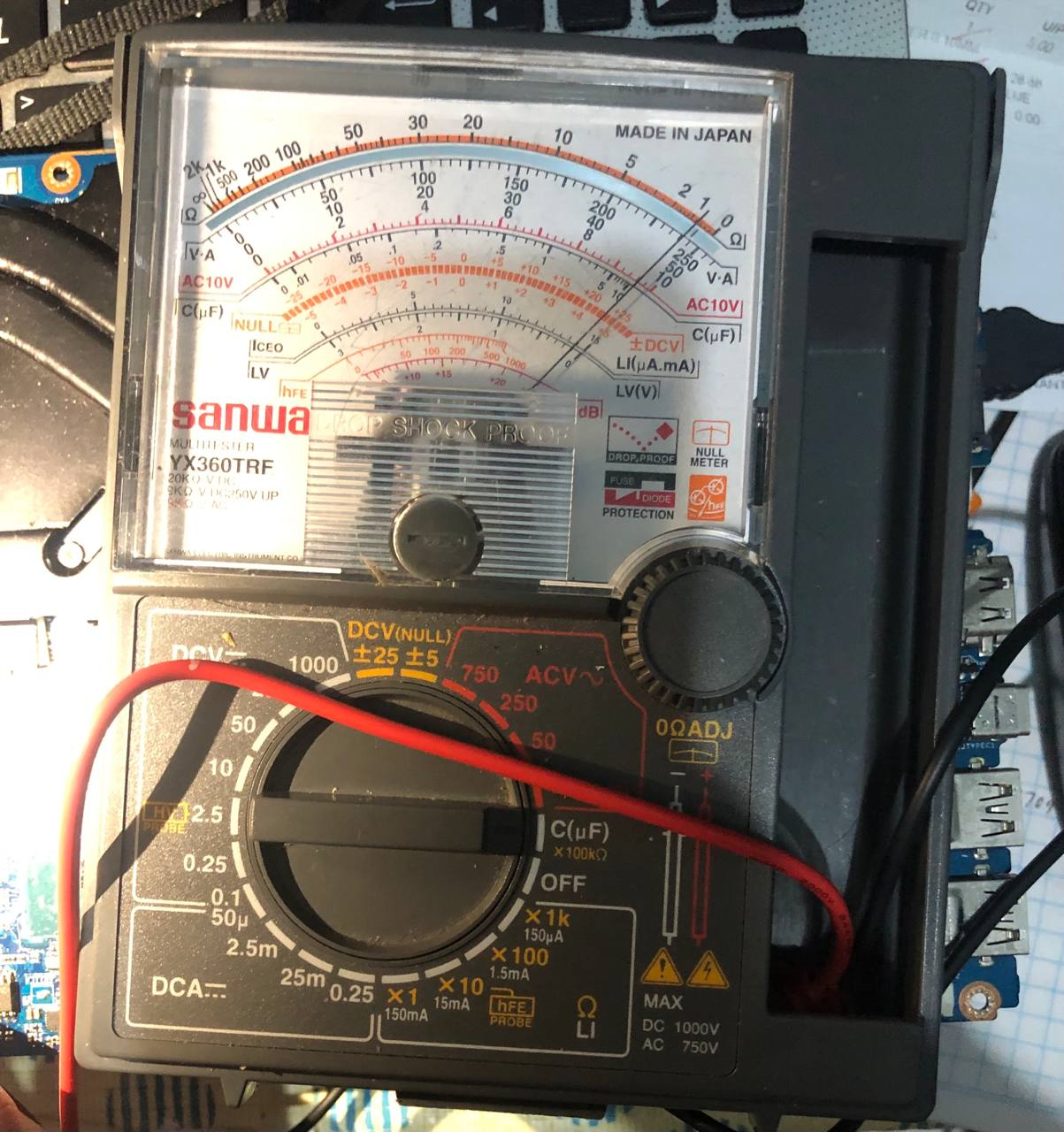

                I'll try to obtain a digital multimeter. In the meantime, here is the photo as requested
                PRB7:
                PRB11:

                  The analog meter measurement will depend on your observation of the meter pin so it is an approximation. Best to use a digital meter but in the end, the ACIN voltage is what matters.
                  should read as:
                  PRB7: 450k ohm in x100k range
                  PRB11: 60k ohm in x100k range​
                  since any measurement on this scale should be multiplied by x100k ohms. The final ACIN voltage on the Digikey calculator is also without a load so that is a factor as well. Using the same calculator, you can select other resistors that you may have to increase the ACIN voltage to be above 2 volts to trigger the charger IC mosfets. Be sure to double check the resistors and their values before powering on else the ACIN voltage may shoot over the max limit and cause damage to the charger IC. At this time, suspect the fault is with these resistors or the power adapter voltage is lower than expected. The calculations are based on the power adapter being ~19 volts or higher.

                            Pin #18 on the charger ic? Post a clear pic of the region and part that may be defective.
                            ACIN is high enough to be ok.
                            measure (carefully), voltage of:
                            ACDRV ; should be ~25v to enable the dcin mosfets
                            REGN ; should be ~6 volts
                            on the charger IC.

                              I might've accidentally shorted the pins between #17 and #18 / #18 and #19 due to the leads being too big. It released a little smoke and I've put a stapler piece in place temporarily for the red probe to make the leads smaller.
                              Not sure which pins are ACDRV and REGN. I don't see it in schematics and boardview.
