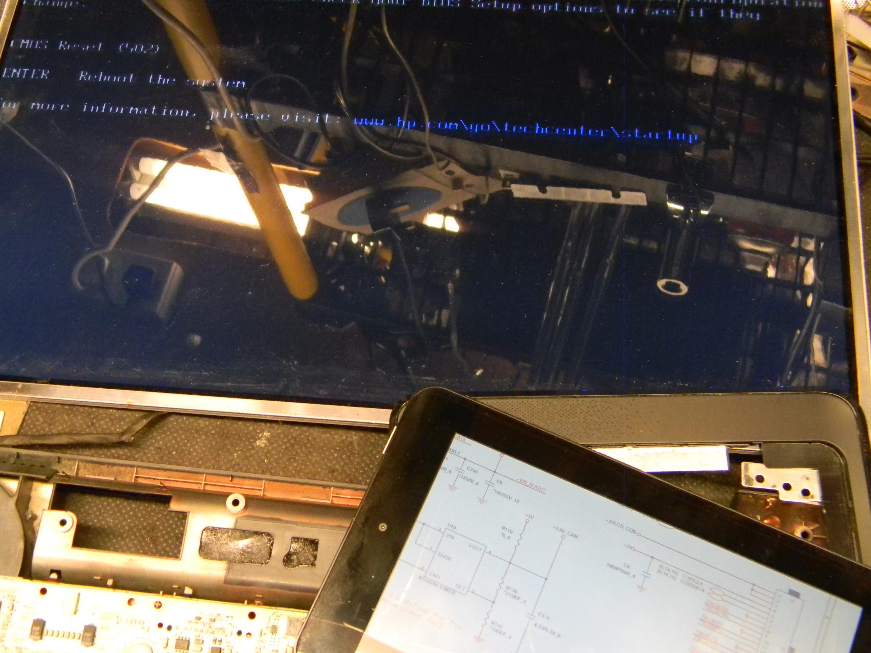

    hy
    anyone can help me with a schematic?
    da00p6mb6d0 rev : D
    i got no backlight on this notebook
    plzz

    Re: CQ71-320sa
    try this

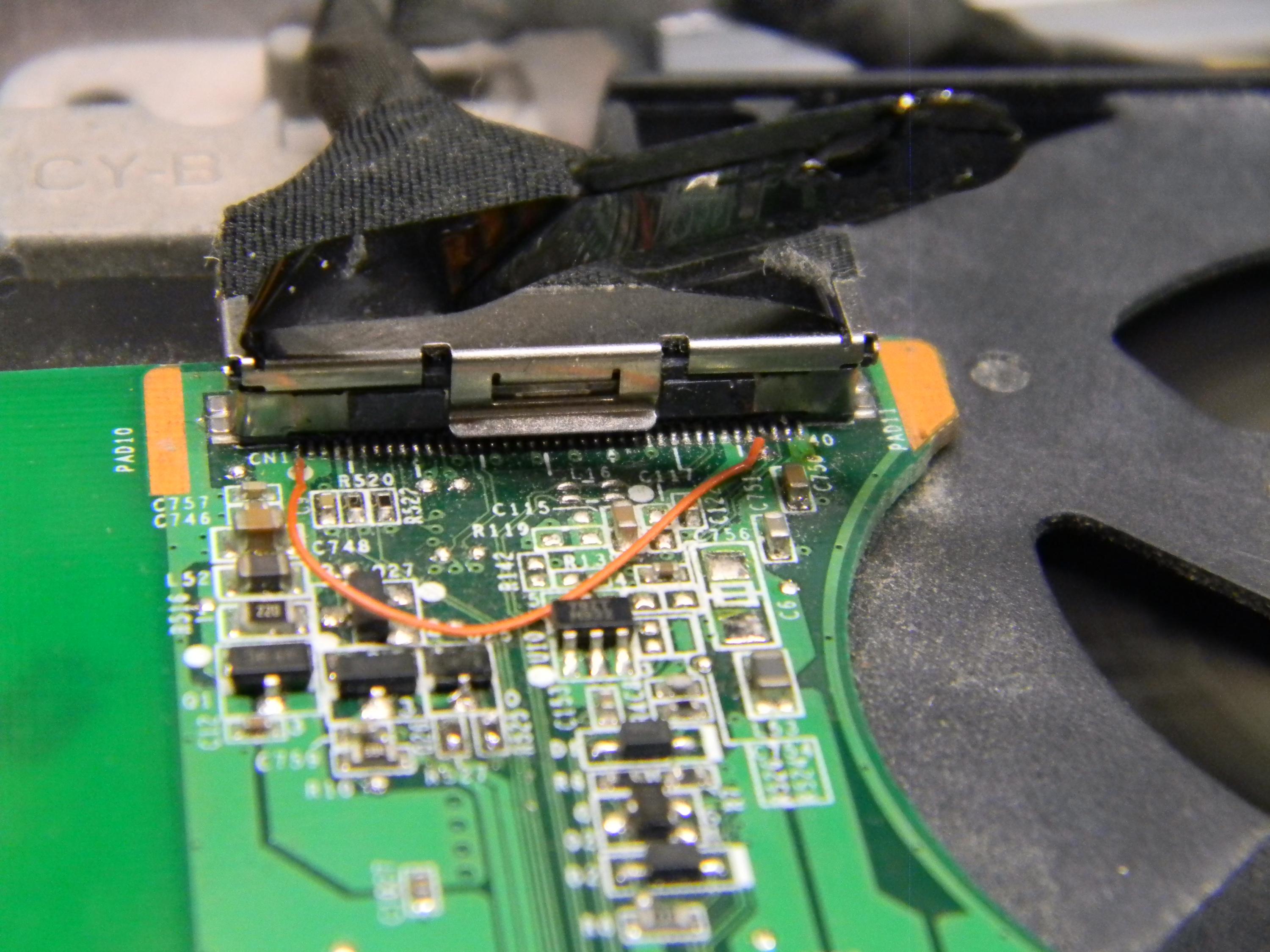

        Re: CQ71-320sa
        anyone know what is the voltage for Vadj1 ?
        i got 19v on blon, +3vlcd 3.2v +3 present
        only the the adjust its missing

          Re: CQ71-320sa
          without adjust you must have back light but only u can not change brightness

            Re: CQ71-320sa
            i solve the problem.
            i took 3.3v for vlcd
            but i think the problem its related to the gpu because its giving me a red tone and some red pixels on the white text
