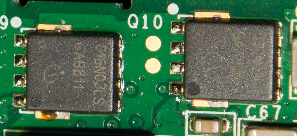

    Have an aspire 8903g here that initially was just dead, you'd plug it in and nothing but a constant clicking noise.
    That turned out to be the graphics card which is an mxm 9600gt card, with that removed it powers on but obviously doesn't boot.
    Looking at the card everything looks ok apart from 1 of the mosfets which I'm not sure about, what do you guys think?
    I've attached a pic of the suspect bit (on the left) although it doesn't really show up well, it just appears somewhat dirtier than it should be around the base like it got really hot.

    Check the transistors with DMM.

      Happened to me once before, one of two mosfets must be short, if you measure between power supply line and GND you must see a value between 3 - 9 ohms. if it is lower than 3 ohms then one of those mosfets is %100 short.

        I think those cards sometimes need a re-ball on the GPU Not saying that is the problem, but if the mosfets are ok i would be looking there. the Acer G series were kinda plagued for cooking gpus.
        Edit:
        Just had a thought, the 'dirty look' could be that it's been subject to a lot of heat / overheating or someone has attempted a repair by cooking it in the oven?

          Every factory solder got it self in composition flux.
          When you cook a board in the oven you will see that every joint on the board will expose that flux.
          Flux will come out and it will make a brown/orange colour .
          Its not bad but its not good to because every shop/person who invested in rework station will say its bad to cook and every body else who don't have money to buy a rework station every alternative its good.
          Find a shop/person with a rework station and replace that chip or buy a new video card
          Something when wrong with that chip or somebody didn't know how to reflow/cook the board

            ok, now in the simplest way possible tell me where to stick the pointy bits of red and black cables please
