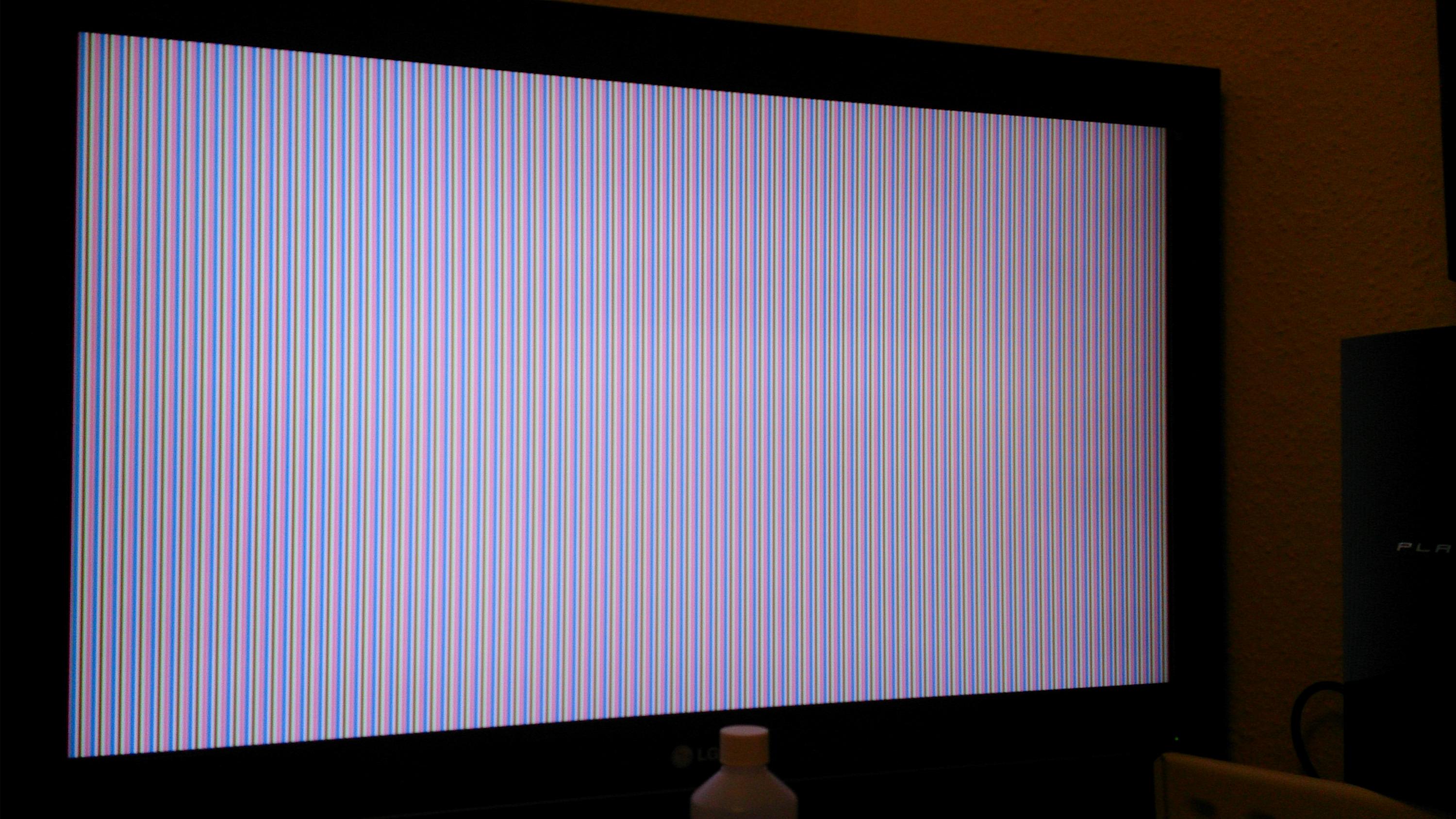

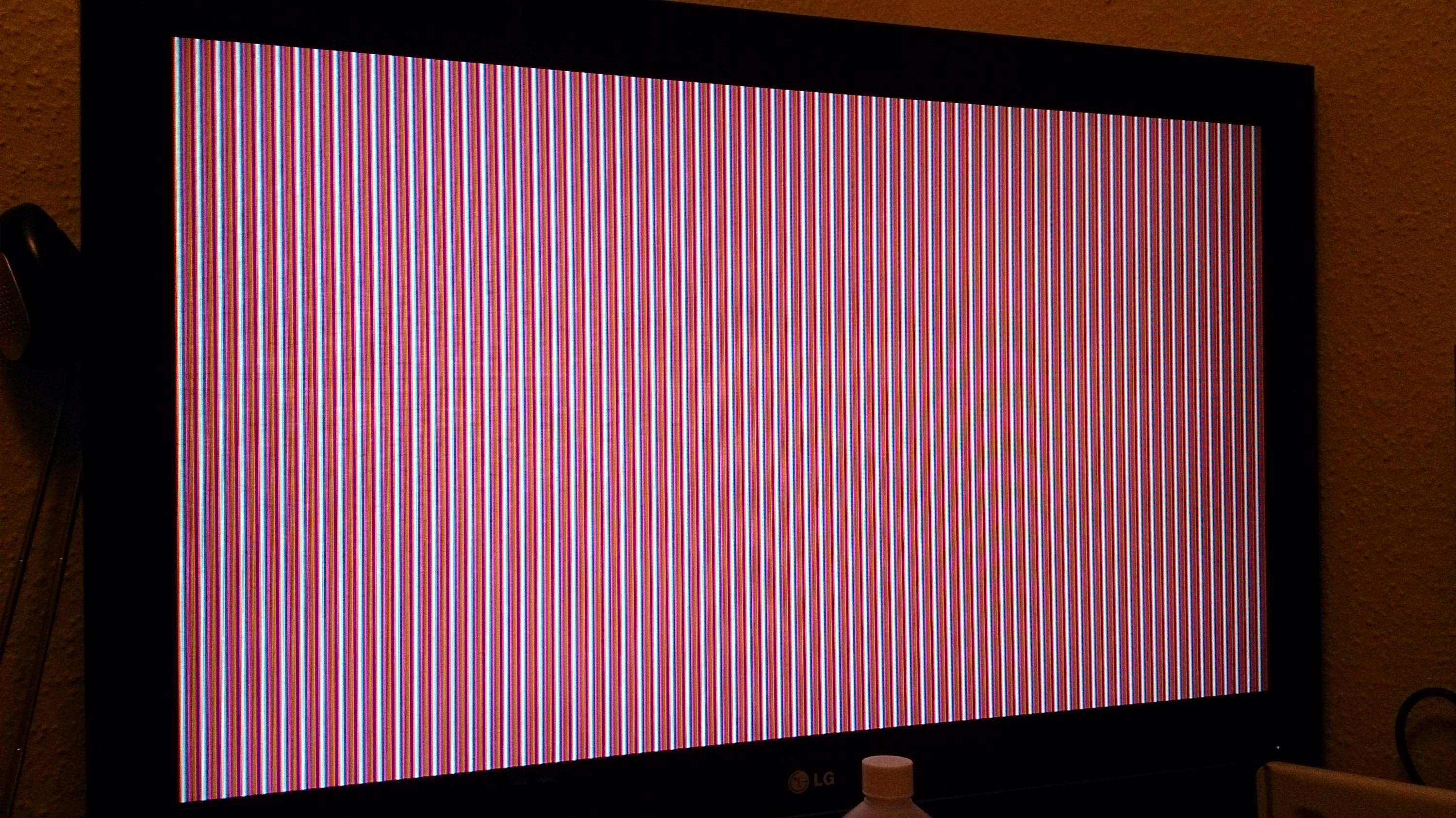

    I have an Acer Aspire 8943G that has failed and now does not show anything on the screen (no backlight too)
    I started getting problems when the memory would fluctuate between 8,12 and 16GB on every start up even though the whole 16GB were in. Then sometimes the screen would be a shade of green only and this would fluctuate too.
    Now there is no screen what so ever, I have tried all different RAM and even a different CPU with no difference.
    I have tried to reflow the graphics chip which didn't do anything (may not have done it for long enough)
    I have tried output on HDMI and VGA. HDMI has nothing, but VGA will show hundreds of vertical coloured lines on my TV (quite pretty!). Every time the colours are different too.
    Sometimes the laptop will turn off after a few seconds, sometimes it will stay on fine. Sometimes the caps/num lock lights are response and sometimes not.
    Hope this information is helpful and someone can help me!
    Thanks in advance
    Graham
  • grahamw01
    • Jan 2013
    • 256
    Re: Acer Aspire 8943G Blank Screen
    The attached pictures are the outputs from VGA.

      This seems to be a GPU problem, not positive, the fact that your screen comes out like that on an external source says GPU problem. Try getting all dust out of the fans, heat sinks, ect. You will need a heat gun to reflow the GPU for about 50 seconeds to 5 mins. After reflow allow GPU to fully cool then apply new thermal paste to the GPU chip and CPU chip to be save. Hope it works.
      More info: http://hackaday.com/2011/02/24/heat-...-fixes-laptop/

        Thanks for your reply, my work place has a proper heat gun for reflow work, I put lots of rework flux under the chip and heated at 500C for about 1 minute and it did not resolve the problem. In every GPU reflow work I have done this has always worked and so far has been a permanent fix. (although the dam air con was blowing directly at me/the chip this time!)
