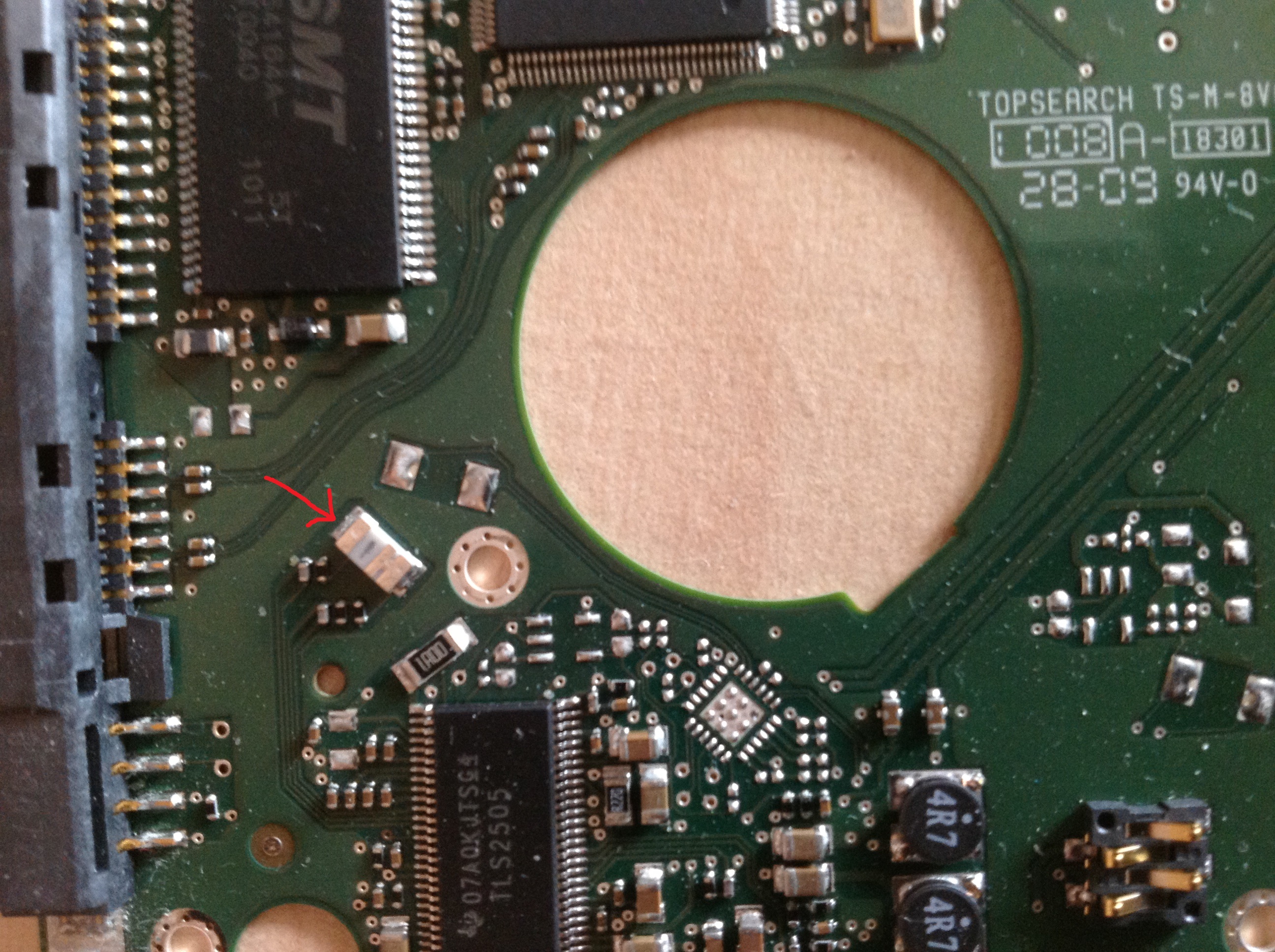

    Hi folks this board is from a 500gb 2.5" sata hdd it just stopped working windows wont even see it when plugged in through external caddy. Does anybody know what kind of component this is as marked in pic ?.

    it looks like a fuse.

      Yeah I was thinking the same its either OC or resistance Waaay off the scales. Do schematics for Hdd pcb exist out there?.

        Re: Help identifying component
        It should read short.

          post full board model number maybe i have same hdd so that we might compare.... it may be led?

            Shock sensor
            Appearance like
            http://search.murata.co.jp/Ceramy/Ca...apt=Appearance
            http://www.murata.com/search/index.html?q=PKGS
            Maybe it's a another company's product.
            http://www.digikey.com/product-searc...ensors/1966686
            http://tw.mouser.com/Search/Refine.a...d=shock+sensor
            application
            https://cdn.badcaps-static.com/pdfs/...5a98747377.pdf
