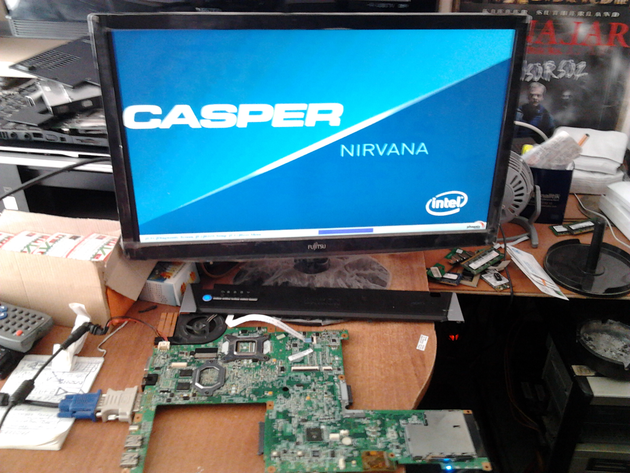

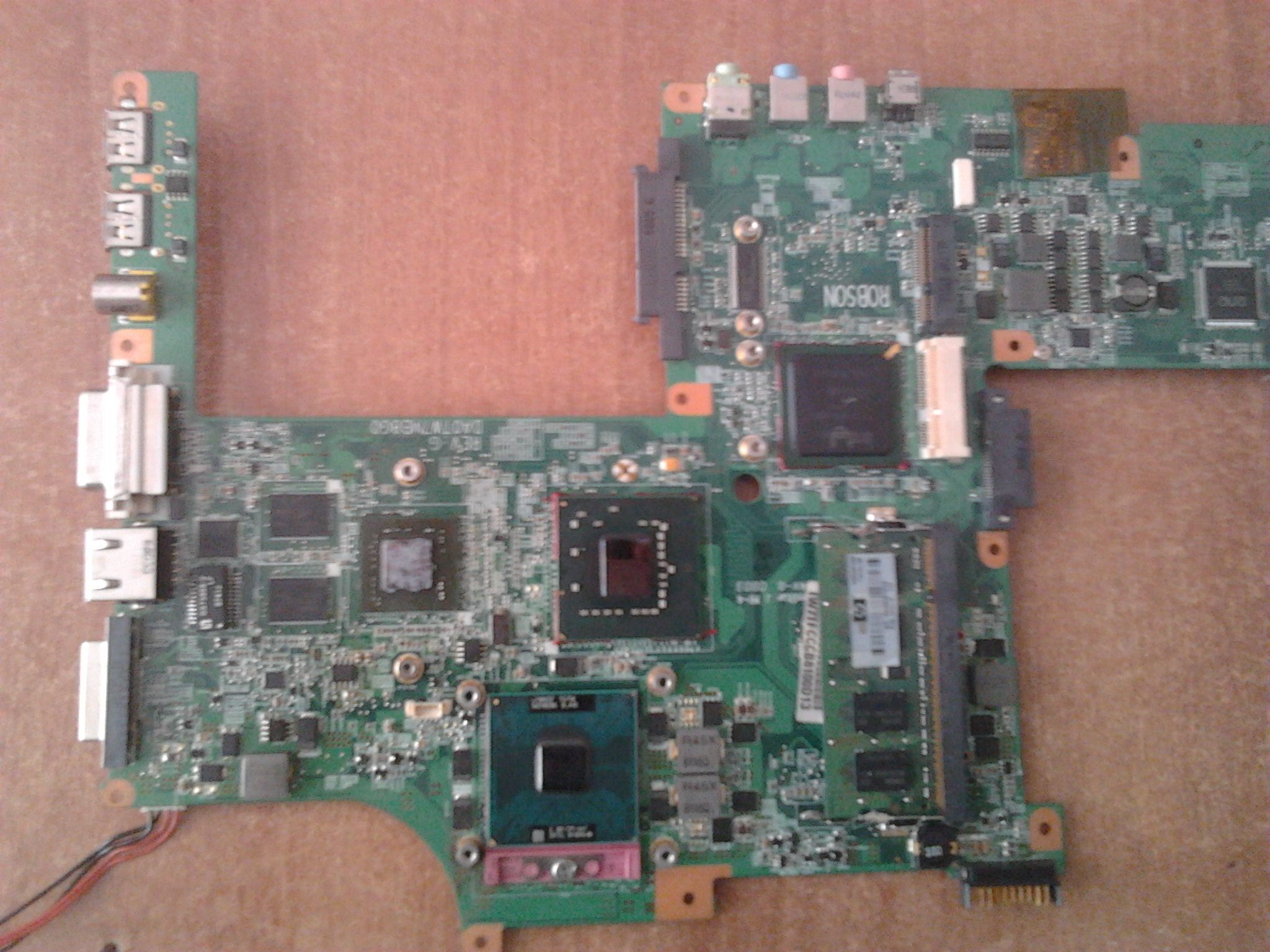

    My computer normal is working but
    wga working but panel don't work. ( Black images )

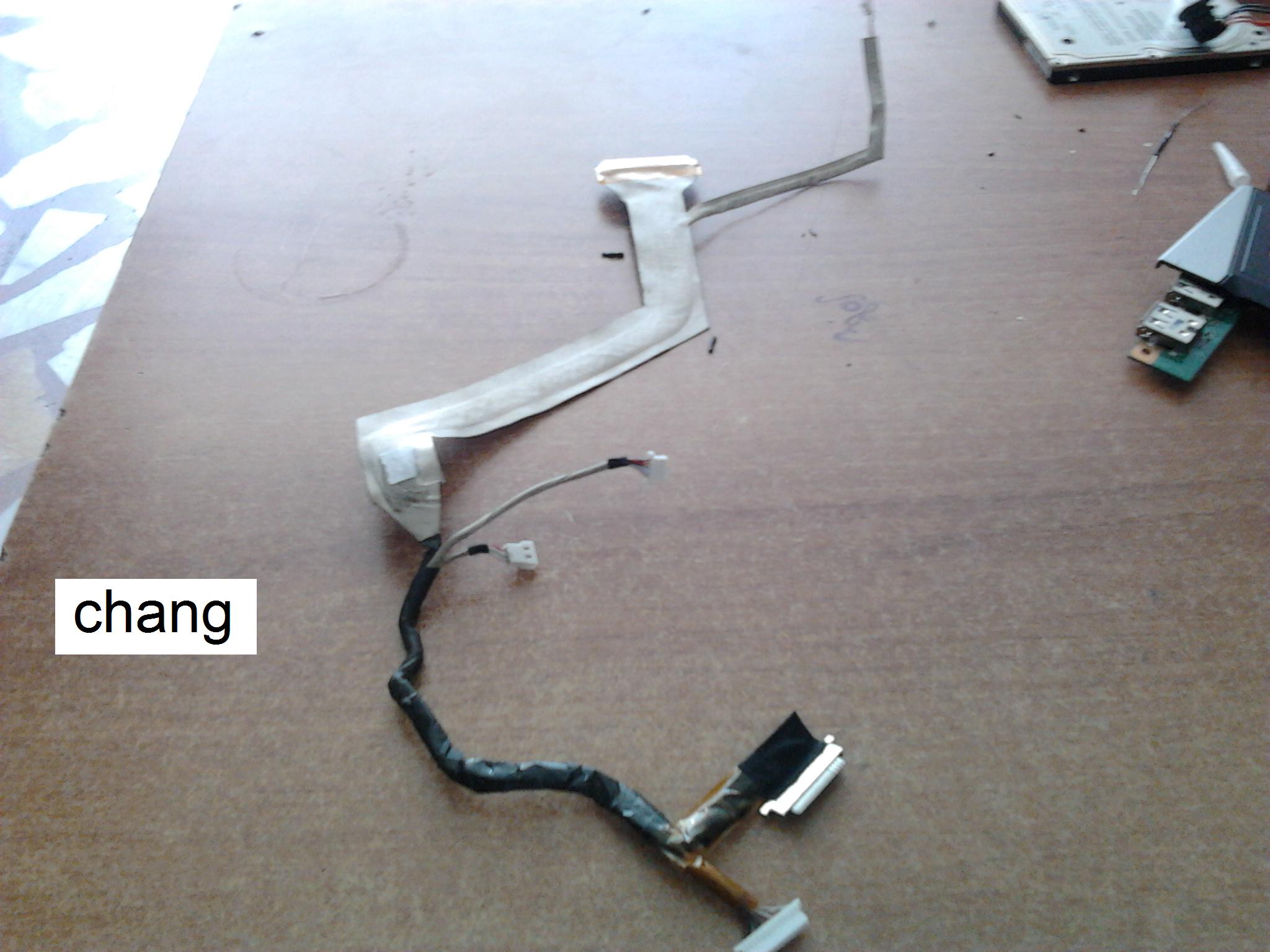

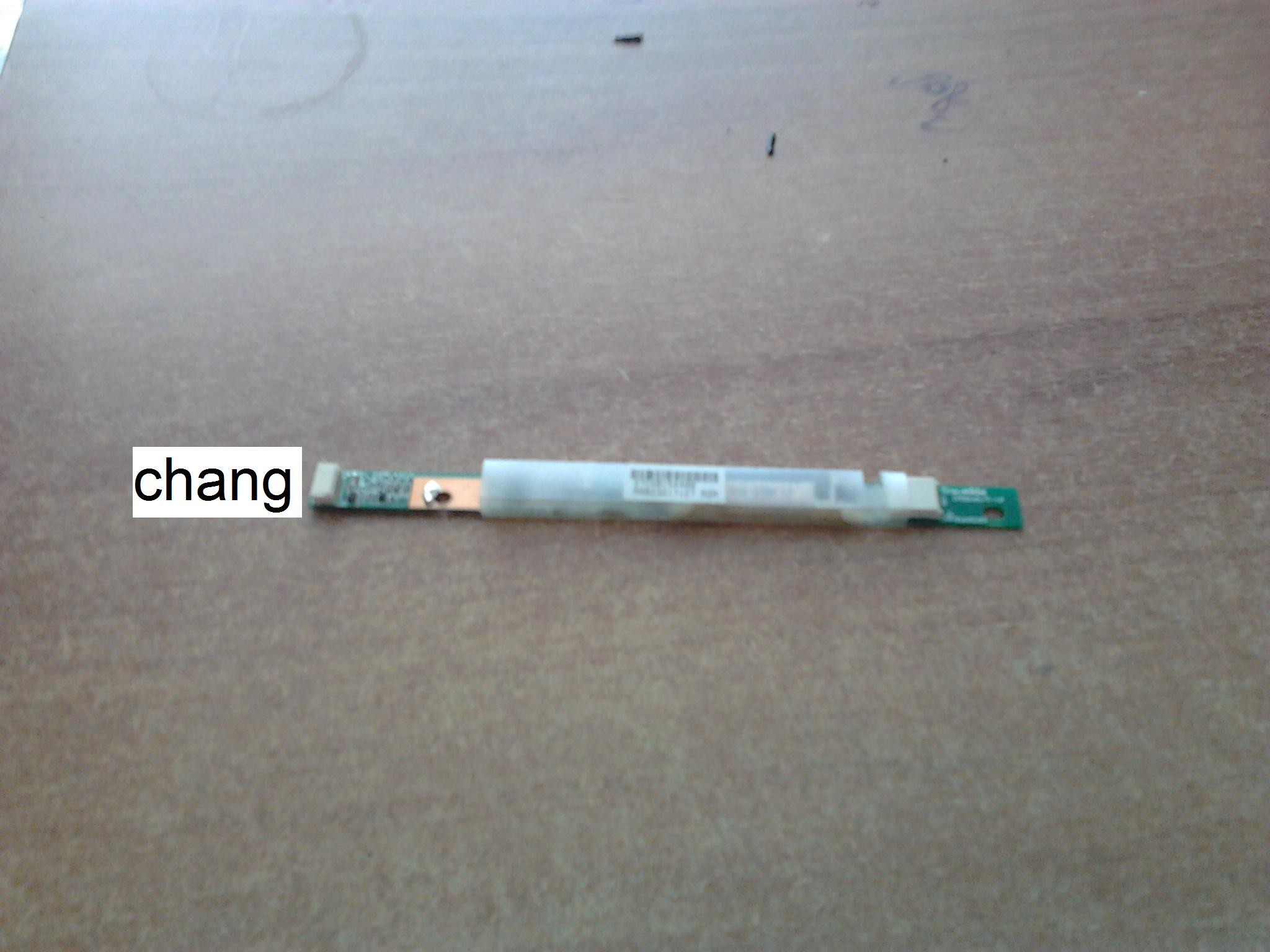

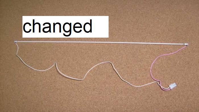

    Note : I'm Florasan changed and invector changed, patch cable changed but not image... ( Black image )
    Please help me
    Sorry my english bad

    Re: casper tw7 problem
    station bga chipset refresh the screen with my friend feet
    not. NVIDIA video card
      me and my friend still has not changed, but there is no picture on the NVIDIA video card black image
        Do you have an external monitor display my friend

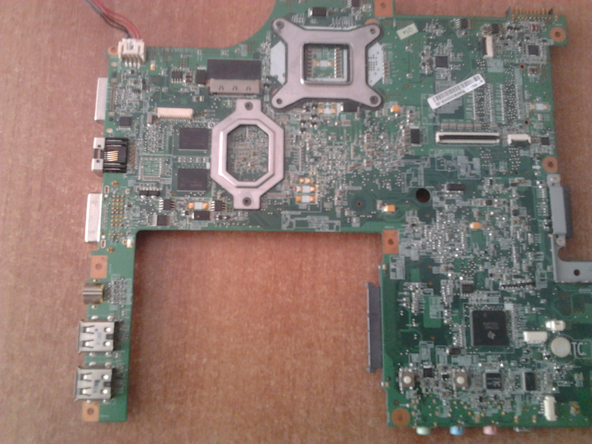

          VGA chip bad or cold joints.Needs a reflow/reball or a replacement
