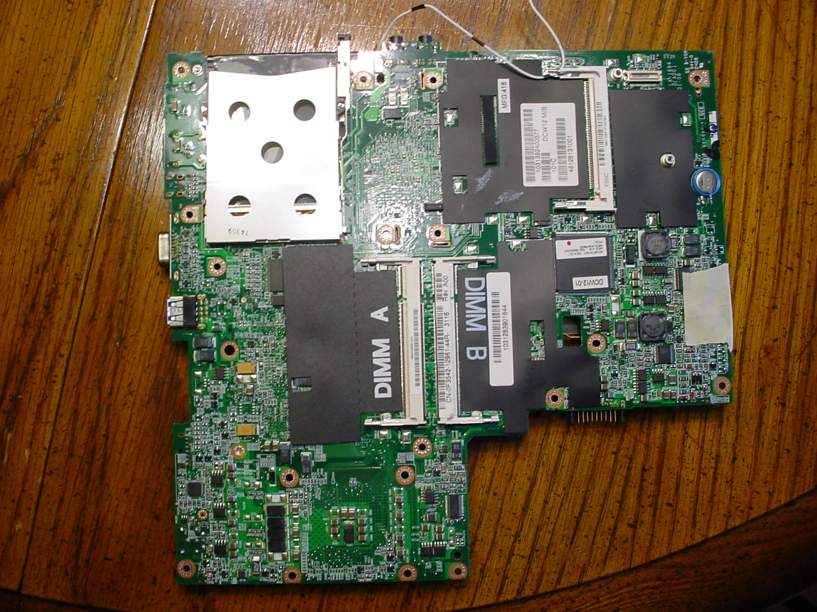

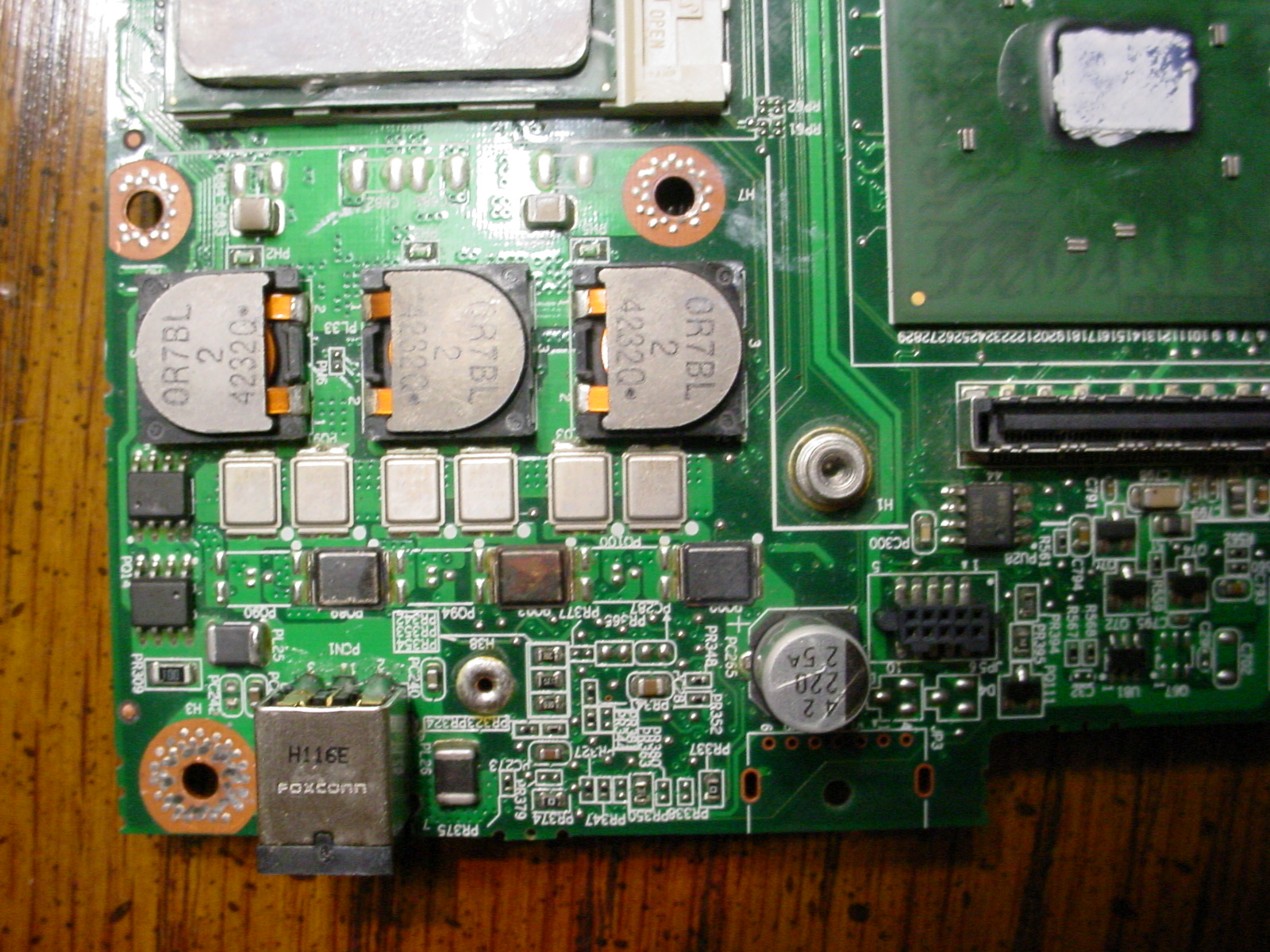

    Had this laptop given to me, they said it had a battery problem. Plugged it in, battery and charge light blinked like crazy, hit start button, nothing happened. I jammed the DC connector in with some force, no blinking lights. Hit start, power light came on and computer started to boot. Got the Dell logo and 3 seconds of boot process, and then nothing. After reading a lot, found that the DC jack is a problem on these boards. Got a jack and replaced it, put it back together, plugged it in, no lights, hit the then power button, power light came on for 2 seconds, then off, dead after that, boot never started. Got it back apart now, checking voltage. I've got 19.5v at both outside DC jack pins, 16v at center pin (data pin I think). Checking around the board, I find voltage at ribbon connectors and components, but it's all 16v stuff. This isn't right is it? Don't know what to check next.

    Update, since I didn't get any advice, I decided to remove the DC jack again. That's the only thing that's been worked on. I didn't see anything wrong with the solder job, but I had voltage (16v) at the 4 mounting pins, part of the metal wrap around on that jack. According to a schematic I found, they are suppose to be grounds. With the jack off the board, those pins are isolated from everything, no power, no ground. I got 2 of these new jacks, so installed the second one. After soldering it to the boards, those mounting pins have 16v on them again. Must be a screw up board. I found one at Amazon, used, but like new they said, $30. I'll see what happens when it gets here.

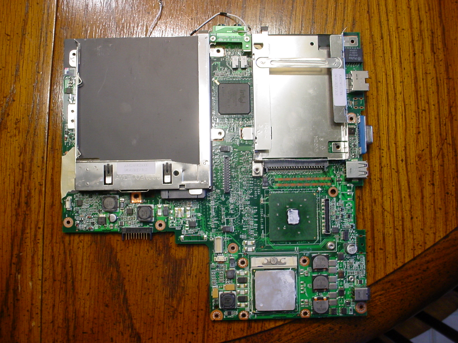

      OK, got my motherboard in today. Put my old CPU, hard drive, and memory sticks on it, connected the cooler fan and start button. With just power adapter connected, I hit the start button, Battery light flashes 1 time, then nothing. With battery installed (it won't charge up), I hit start, the power and battery light flash once every 5 seconds, But the hard drive, fan, nothing seems to try to start. Should't this laptop run on the power adapter alone, without the battery even being installed?

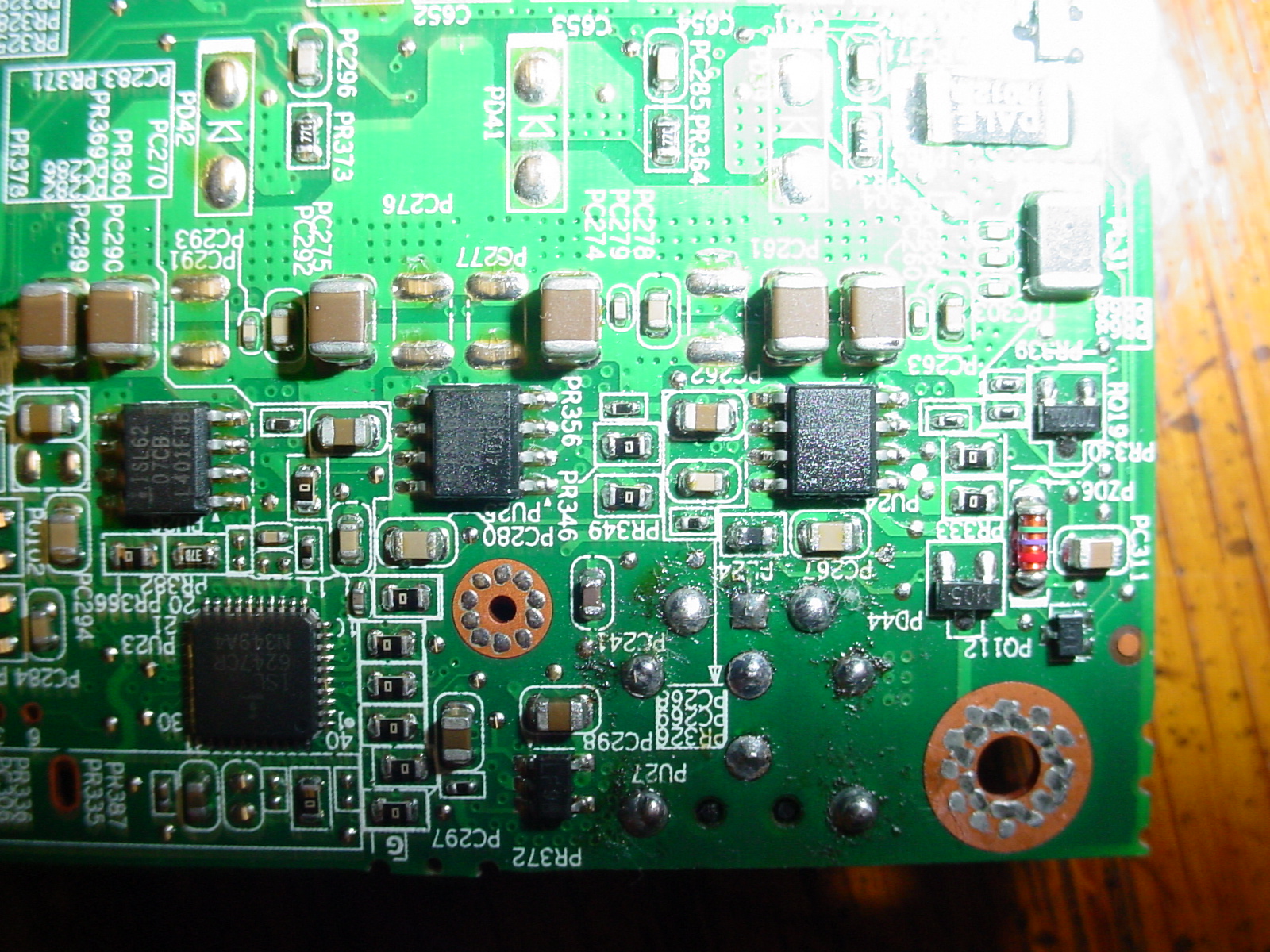

                Try reballing the ISL6247 chip

                  I see that chip ther close to dc power connector. Are you talking about reballing my old board or the "like new" one I bought? Because this one I bought has a 30 day warranty, don't want to heat it up any.

                    What is the voltage given you by the power supply? When its disconnected it should be 19.5, 16 is not acceptable. You sholud have 19-19.5 in your lines after the power jack, before power chips.
                    Power jack centre pin should be 19.5, outside metal shield 0v-ground. Your black multimetter probe is attached there.

                      The 16v is on the data pin.
                      I think maybe you should try replacing the BIOS battery.
                      If that doesn't help, there might be a short on a voltage rail somewhere.

                        I've got a different motherboard now. This one has 2.9v on that data pin. Would that BIOS battery cause problens other than date memory loss or something. The voltage on it is 1.7v. The battery is maked 3v.

                          Seems almost like the chip on the motherboard that reads the data pin has been zapped.
