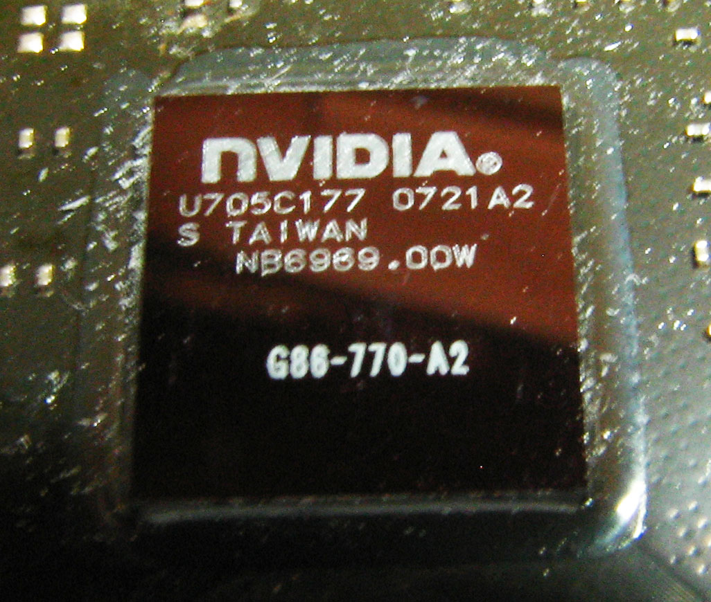

    On two laptop hp pavilion dv9000 i gor same problem, after reball wont show any picture, befroe show white or change white to gray to black colors on screen and not work on external monitor.
    So i Suspect to bad series BGA chip, is someone familiar what marks on chip has bad seria ?

    Sounds like you got the nvidia underfill problem.
    http://www.theinquirer.net/inquirer/...hips-underfill
    http://semiaccurate.com/2010/07/11/n...fill-problems/
    Your only option is to replace the chip with another one, then place copper shim on it before adding the heatsink back on.
    Any series between 8x00 to GTX 5x0 series.

      Hi. So must get new chips, but what series is OK. If I buy new from this series is possible to die again after few month and then repeat whole thing

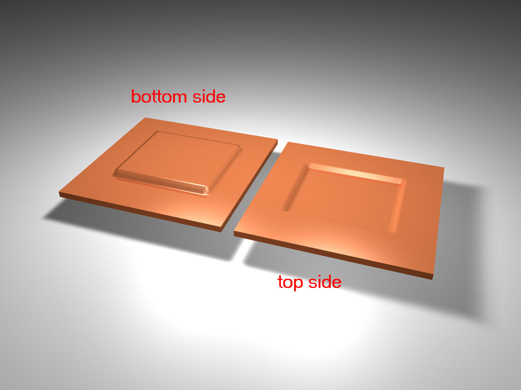

        How does the shim improve the reliability?

          I got bad expirience with this copper shim, I not say that is total useless but in most cases wont help, or help if heatsink dont seat enough on chip core, otherwise I dont see benefits of them.

            Copper shims are fine so long as they are the right thickness so that the heat sink lays flat. Too thin and the heat sink has too little contact and the shim may fall out. Same with too thick except that the chip is at risk of damage from clearance and spring pressure.
            A feeler gauge will let you zero in on the right shim thickness for your application.

                And yes, I'd recommend a copper shim. DONT use a penny. The correct thickness is paramount.

                  Don't shim it. From my experience the shims aren't that much better and not worth your time.
                  The problem is that there is a certain tolerance in the dimensions of the cooling HW that the pads are meant to take up. A shim is rigid and doesn't allow for such compensation.
                  In addition, often times the chips with pads have the HS mounted only on one side of that chip. Such configurations work best with pads, as in order to get the flush level of contact needed by a rigid system, you need the pressure holding down the heatsink on both sides.
                  What I DO suggest (after replacing the blown chip) is upgrading pad materials. I fogot the brand/product but they do make a silver pad material that can be cut with a knife to size and has thermal adhesive on one side. It's also good for GPUs and the like with those white pads that often go bad... My stash was part of a trade so I don't know where it can be bought.

                    you're right, thickness of copper or aluminium plate is important, but in previous post I got phonecall an forget say that, I spend 3 minutes to modeled shim in my favorite 3D program and then forgot complete why I do this
