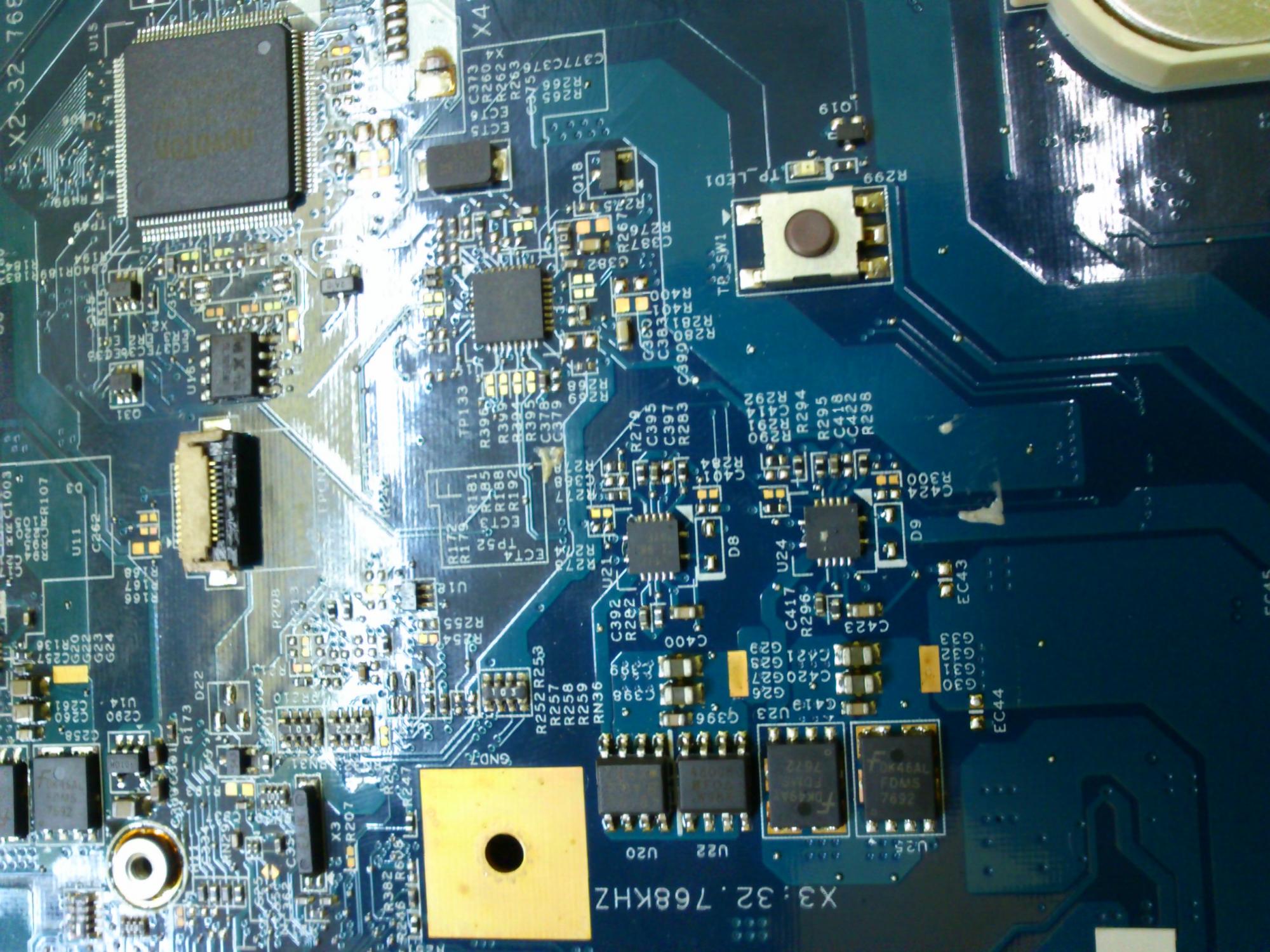

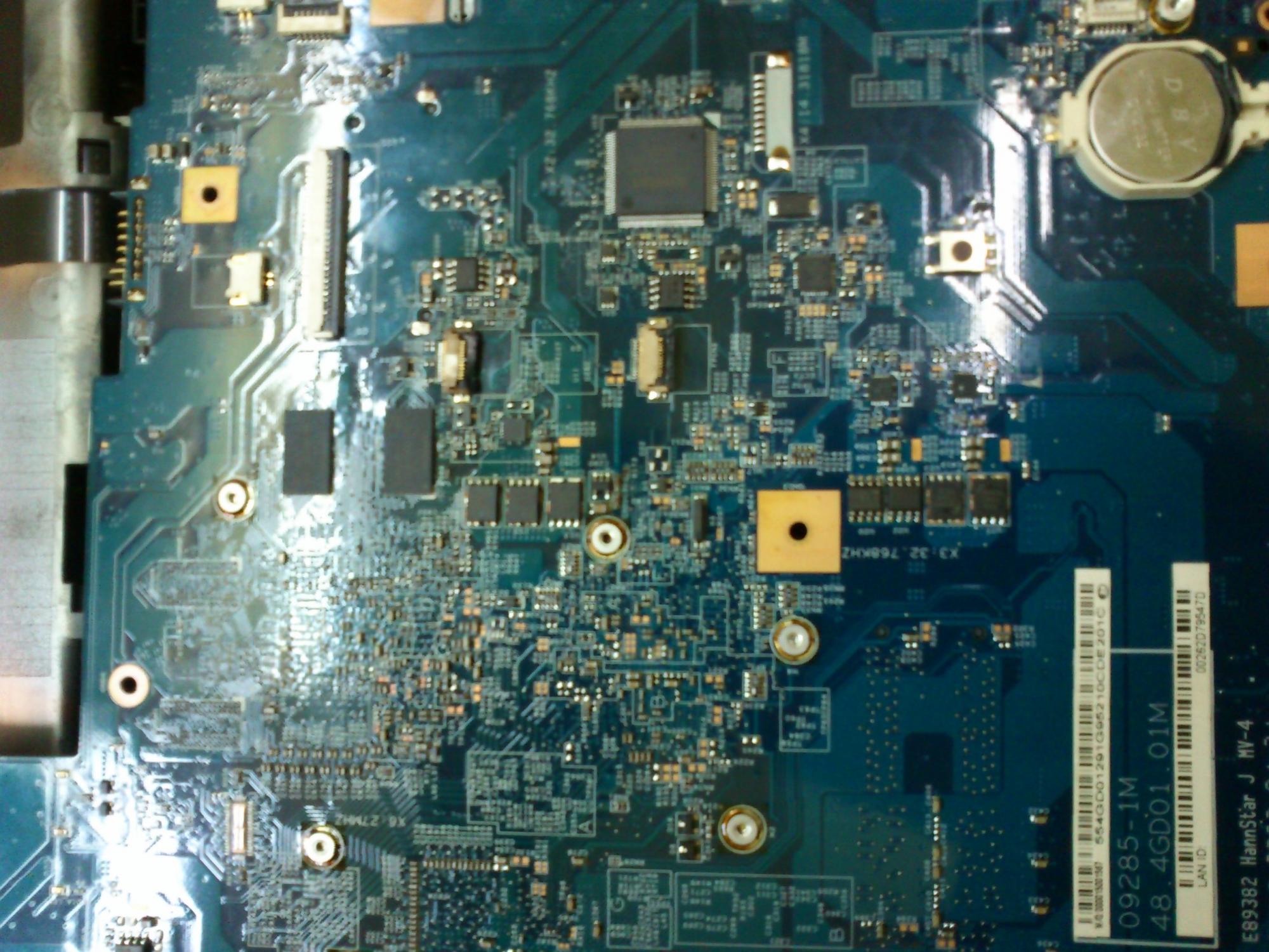

        My Acer 5740g has the same problem. I measured the DCIN1, it got 19V; but none of the LEDs lit. Thanks xose_mania, I downloaded the schematics, it is helpful, but does not seem to match my motherboard because I could not find the components I was interested in. I have attached the image of the board, could someone verify whether I have the correct schematics? If not, where can I find them? Thanks!

          xose maria put link to laptop schematics site where you can search and find the right scheme for your device.
          Good luck!

            Thanks! The schematics were actually the correct ones. I was able to trace down to TPS51123 the power regulator, it got 19V input but no 5/3.3V outputs, can I assume this part is dead? Are there any other possibilities that could cause it not to generate outputs?
              Re: Acer Aspire 5740g dead (no power - no lights)
              Yes,first check on pin 13 if you have enable signal.
              If you have,open G151 and G129 then check pin 8(3V) and pin 17(5V)
              Check mosfets(u73,u67,u74,u69)
                Pin 13 is 5V, pin 8 is 3V, pin 17 is 5V, but pin 18 is 0. Traced S5_ENABLE to Q18, and found 1D05V_VTT is 0. Any idea? Am I on the right track?
                Thanks!
