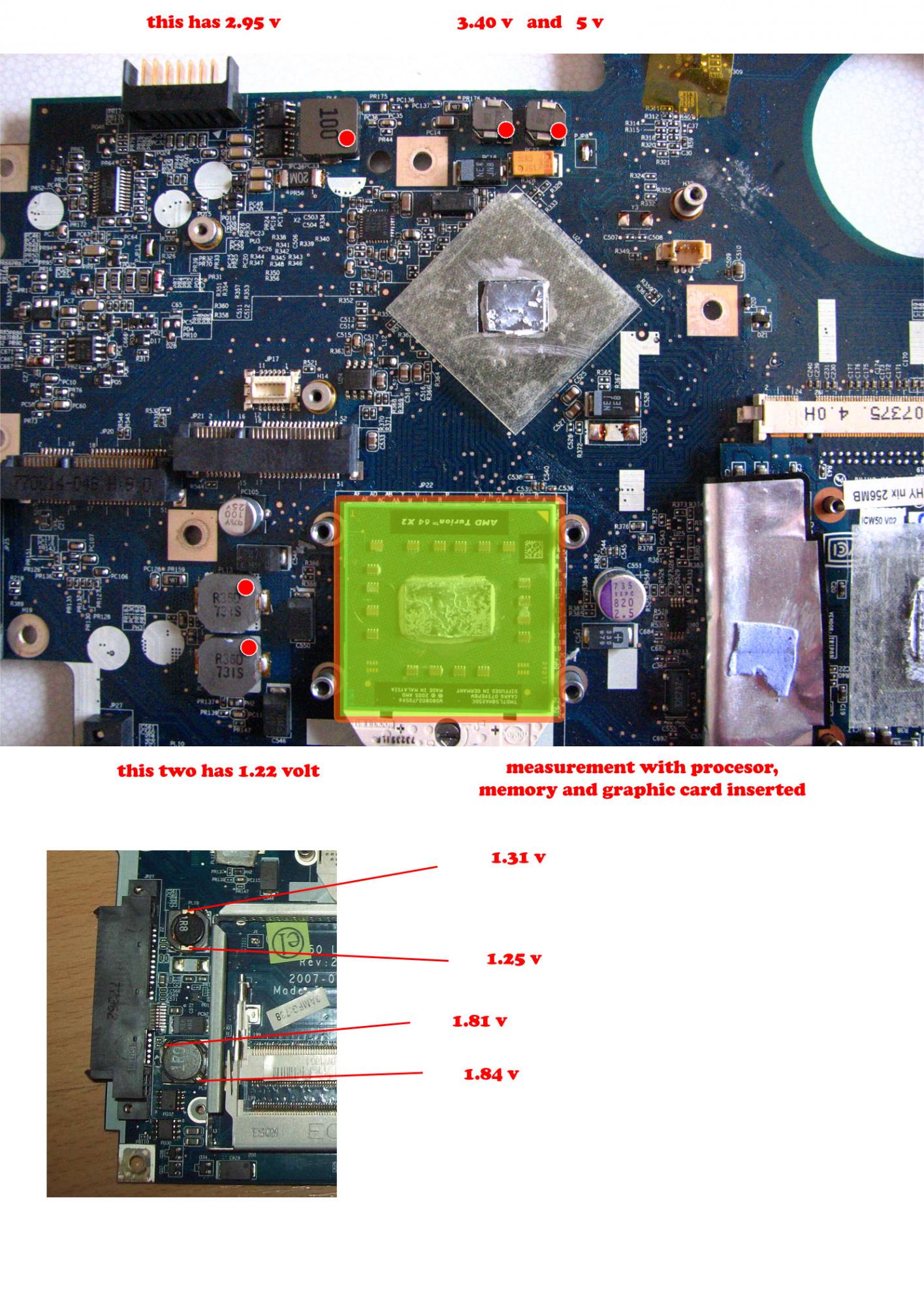

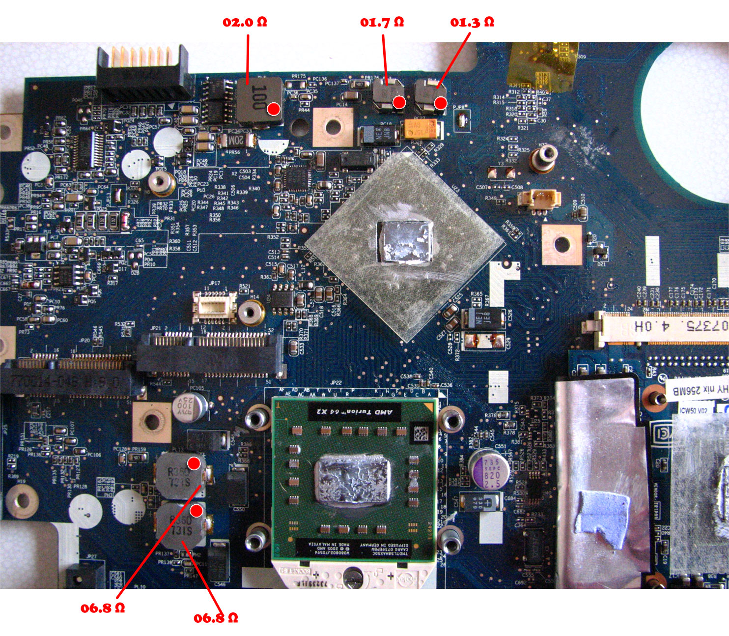

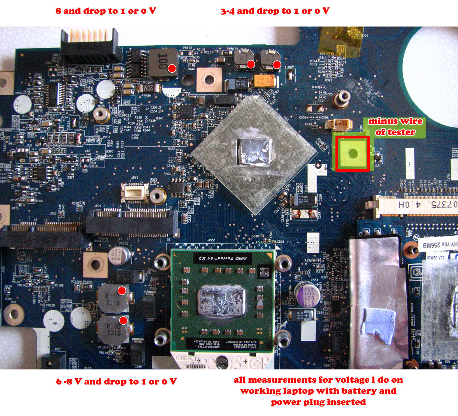

                          Re: Acer aspire 7520 power problem
                          Hi I hope Im measure correct elements (cube coils)
                          I must say first I try ohm conductivity for each coil , then I connect battery and power plug and turn on motherboard, and check voltage of coils, black wire tester I put on minus like on pictures, and rapid lost voltage on this coils.
                          I try first with battery and then remowe battery and result is the same.

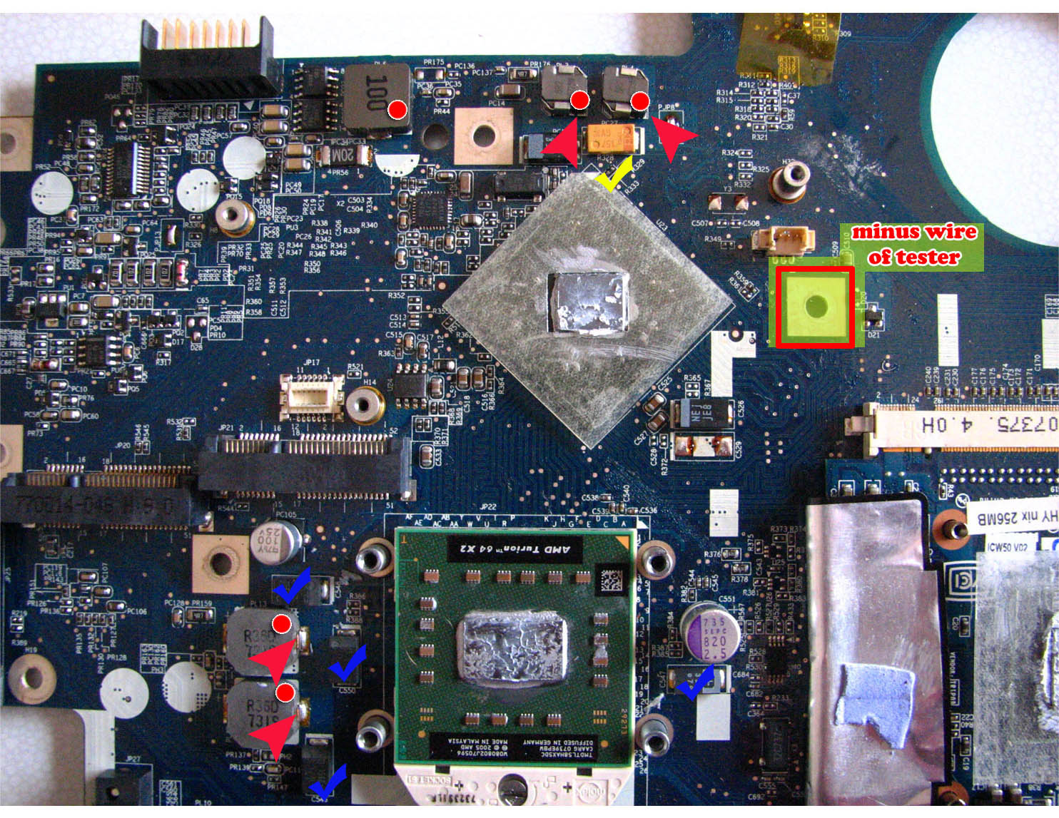

                            measure it with and with-out processor, and always write it down....
                            check voltage on red-pointer, especially the coil nearest processor.
                            it its lower than 1v, replace the blue-checklist with 2.5v 470uf caps.
                            the yellow-checklist will not be replace if the above 4caps 470uf has solve the problem

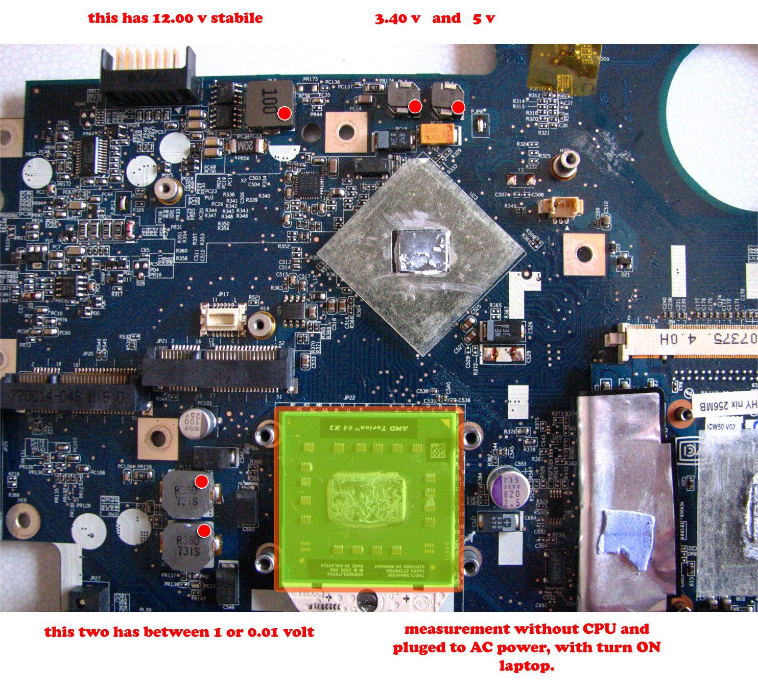

                              Hi I check again without CPU and get this values.
                              I search this 470 uf capacitors.
                              • xaviero1412
                                • Apr 2009
                                • 56
                                so, positive 100% the problem is at cpu_core/vccore.... just replace the 4caps....

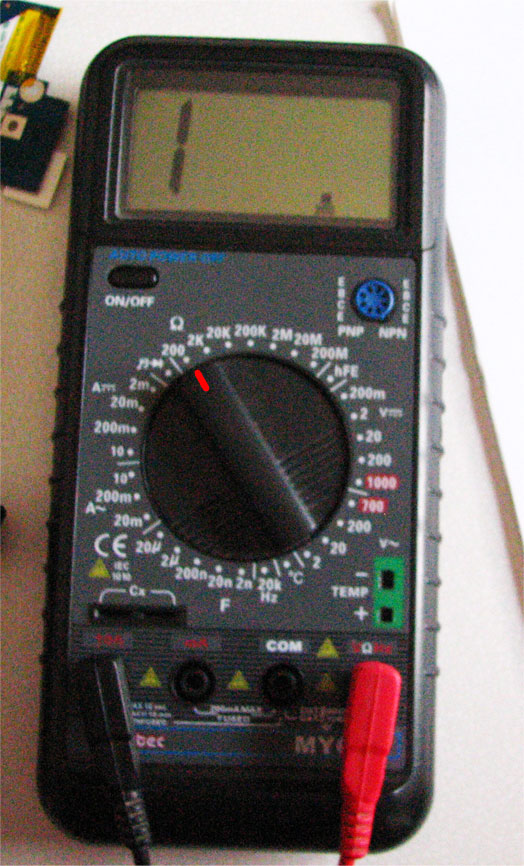

                                • 12ax7a
                                  • Oct 2009
                                  • 21
                                  your black dvm lead may be in the wrong hole for measuring ohms & voltage... although some voltages do seem legit.. that 10A hole is usually for current only. normally you'd use the COM hole for those measurements. too fuzzy to read the meter writing from here. just something to check.
