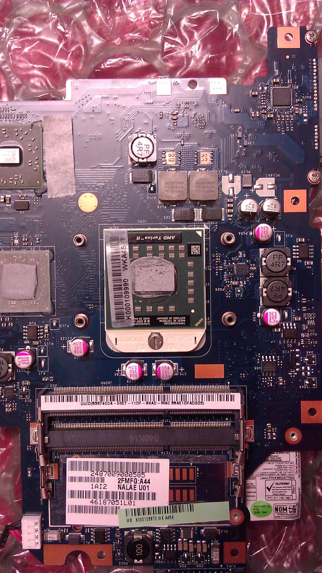

    Can someone please offer some detailed guidance
    Toshiba L675D-S7049 laptop works perfectly fine on battery. However, once plugged in, either immediately or after a bit of time, laptop completely freezes and only hard power shutdown does anything. Warranty is finished and Toshiba is not helping whatsoever.

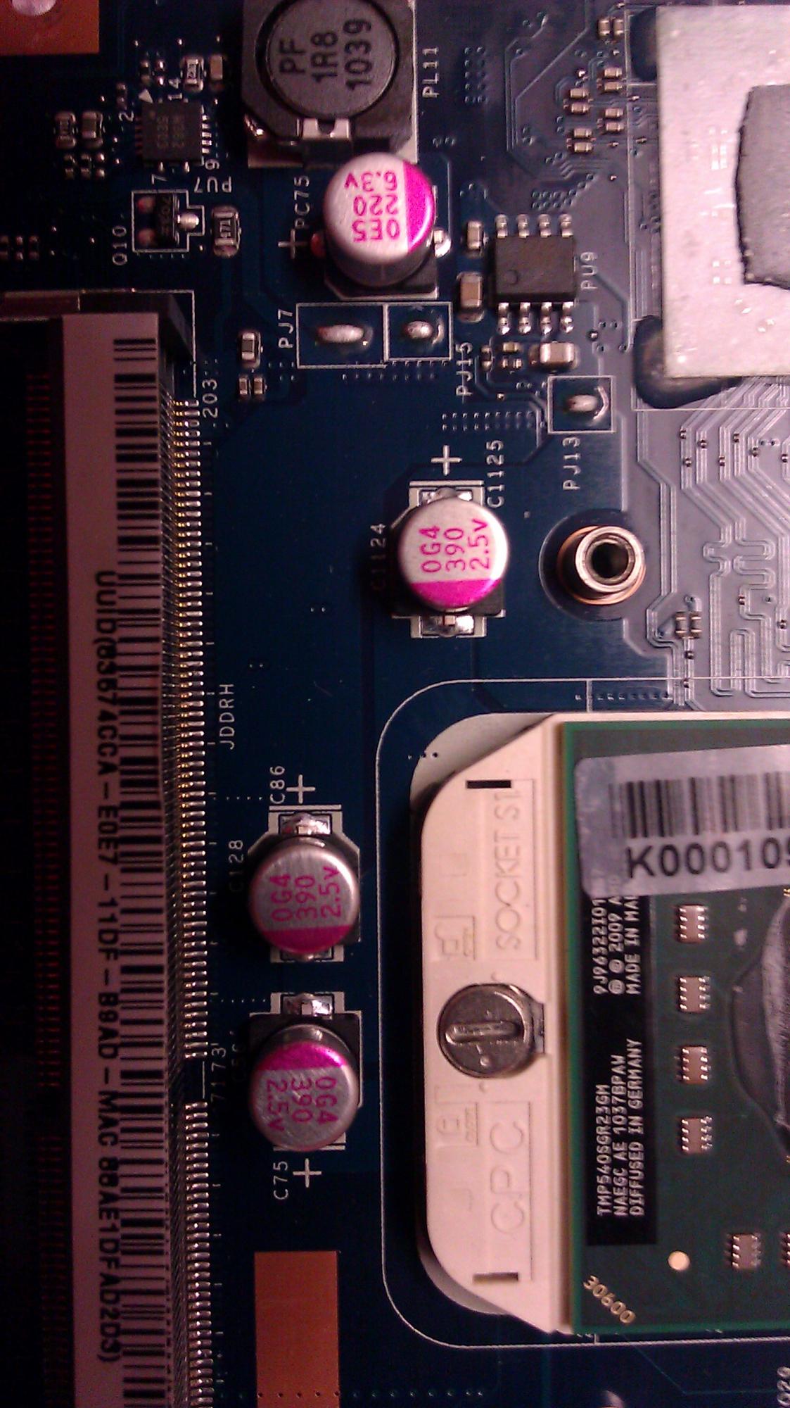

    I have looked everywhere online & I have tried countless remedies to no avail. I opened up laptop & attachments R pics of mobo. It does NOT have da NEC/TOKIN caps, however, there are:
    Mobo: NALAE LA-6053P
    Rev: 1A
    3 0E5 220 6.3V
    3 0G4 390 2.5V
    3 0J4 VLPS 330 2.5V
    (the little round metallic partially purple items in the picture attachments)
    If I am focusing on da wrong items, please let me know. Otherwise, which ones should I change and with what??? Please help, your assistance would be greatly appreciated!!

    Re: EXPERTS PLEASE HELP: Toshiba L675D-S7049 Freezes
    Freezing usually indicate bad caps , but if you don't measure voltages around the board you can't say what's wrong . Maybe cpu, northbridge , southbridge , vga failing ...

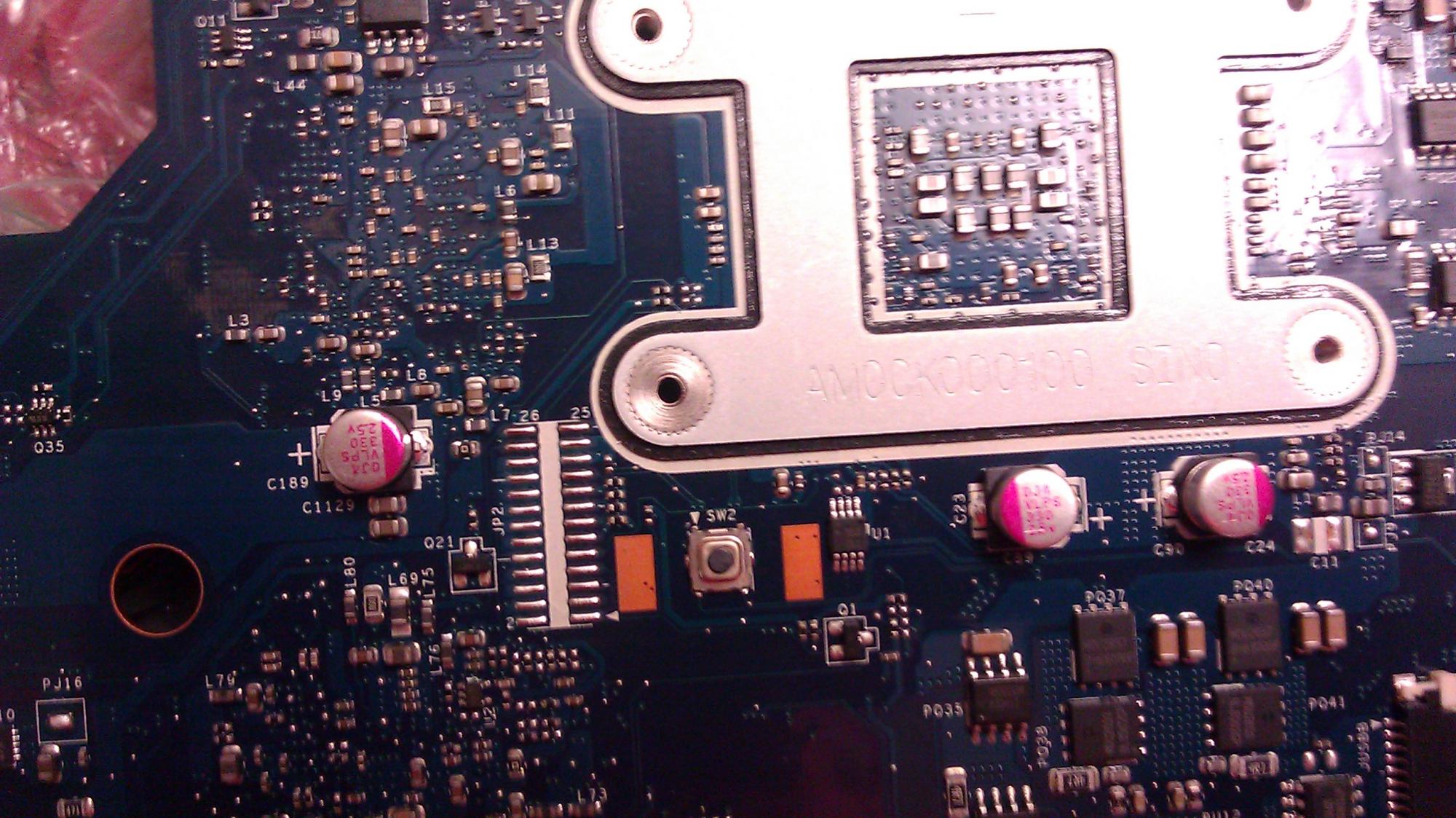

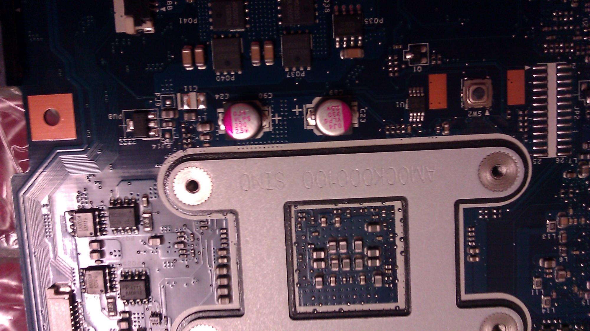

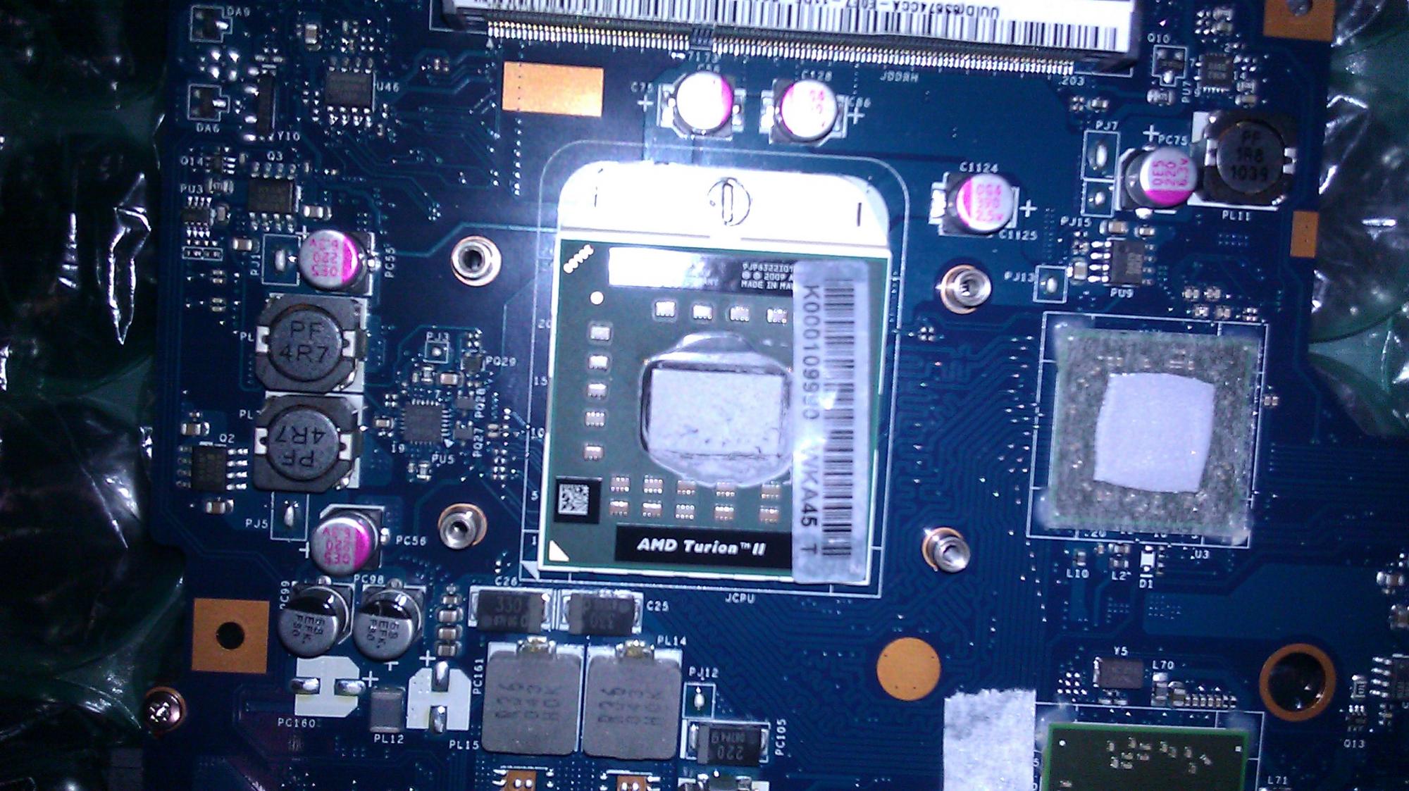

          Attached you will find two pictures of the opposite side of the motherboard. For your reference, I have also attached a pdf that has the board layout pages and schematic for the motherboard.
          I have a multimeter to measure and I have decent soldering, electronics skills except this particular area is a weakpoint for me. If you could guide me as to what to measure and what to realize is the issue, and any possible solutions, I would tremendously appreciate it.

              I think you could try to remove the solid caps (purple) behind cpu they are C23 ,C24, next to CPU ,C75, C86 and the two tantalum 330uf C25 ,C26.
              hope this helps.
                  Yes replace with identical caps (new if possible) same uf and voltage.
