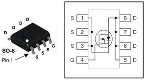

    I had the same problem and I was able to fix it by grounding pin 4 (In your picture it is the top left pin) directly. Initially I measured 19.4V at that pin but the IC does not function unless it is grounded and the other three pins are at 19.4V. Hope that helps solve your problem.

        Re: Sony vaio VPC-EB mbx223/ no start,no power no led
        can you describe pin 4 in more detail. Are you talking about the first ground wire (according to the pic) from the power jack. I interested in this repair because I have a MBX223 motherboard no longer showing any signs of life after three months of usage. I change the power jack and the power board, but still nothing. I've attempted to try your grounding method, but i was unsuccessful at it as i'm not sure if i'm grounding the correct pin. What is pin 4?

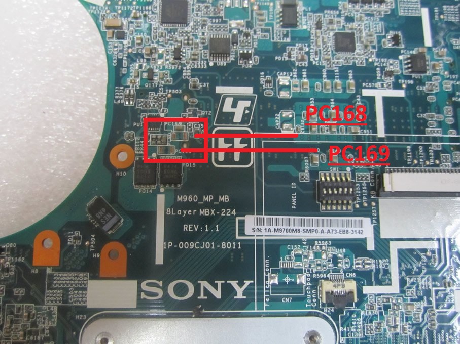

                        I had the same Problem but with MBX-224 but its the same structure check the PQ1,PQ2, and the most important the are the Capacitators PC168 and PC169.
                        I have upload a picture witch you can find the parts.
                        The failure is NO LEDS NO START NOTHING!!
                          Thanks for the input buddy! but those 2 caps are ok,but i found that something is shorted to ground in the line of PL18(+1_05V_VTT), i removed all PC206,PC208 and PC212 but still same thing, even with PU16 removed i still have the short. Also PQ2 and PQ1 seem to be ok, except that im able to switch them on/off while in circuit...is that normal??
                            unsolder the PQ CHIPS AO4433 and check it up!!
                            Dont unsolder the BQ QFN CHIPS if there is higher voltage...
