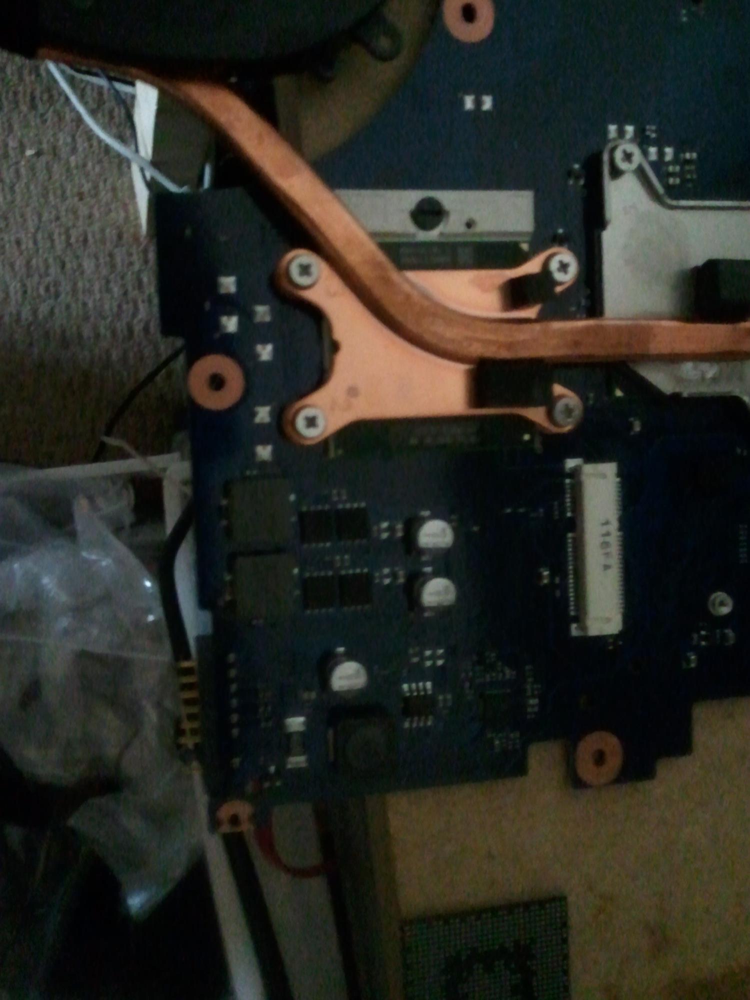

    Hi I have a customers samsung s3510 how has been using a universal maplins charger and has now no power. Now with an original charger their is a short on the mobo. I have tried 2 Chargers and the same things happen the led blinks on the charger and you can hear a pinking noise in the charger. It obviously has a short on the motherboard but I cannot find it.
    It has the power ic circuit near the battery, which is at the other end on the pcb and 1 power regulator gets red hot. I have changed that but still have th e same problem. Any help please.
    What can test and how.

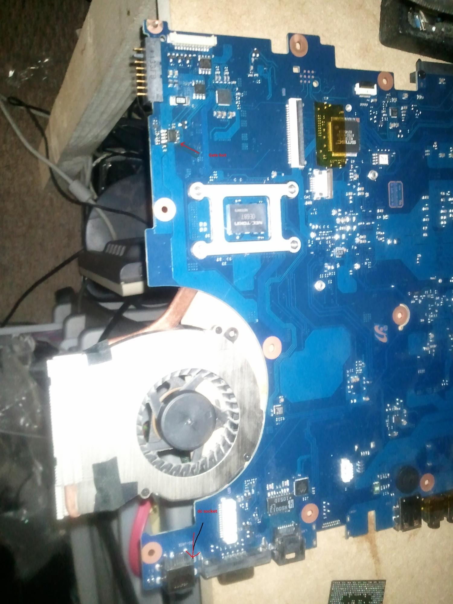

        Re: samsung s3510
        There is a short and ic get very hot. marked.

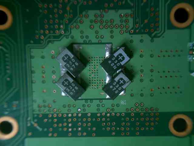

          Re: samsung s3510
          the big cap is the problem below the processor on the other side of the board.
          you must replace it with 4 tantalum cap ( 2x470 ,2x330)

            Re: samsung s3510
            the big cap (nec tokin oe687)

                Re: samsung s3510
                do something like that(attached file) . hope this help

                  Re: samsung s3510
                  you can find these caps on dead board if it is not possible for you to buy it

                    Re: samsung s3510
                    arrangement with the capacitor:
                    (4x330e)or (4x330d) or (2x470e , 2x330e) or (2x470d , 2x330d) or (4x220e) or (4x220d)
                    e=2.5v d=4v you can also mix voltage values

                      Re: samsung s3510
                      I Get it now. In other words do not replace with nec tokin oe687, but use the 4 seperate ones in stead. Thanks Will give it ago. Got hundreds of old mobos. laying around,.

                        Re: samsung s3510
                        Hi I have completed the process by removing the oe687 and using 4 x 220d's but I am still get short circuit causing the chargers to blink. I am sure it was caused by a universal charger have you any other things ican try.

                            Re: samsung s3510
                            There is nothing near the dc socket. It has 1 tiny capasitor then just tracking all the way to the battery/ power area i the other end of the board.
