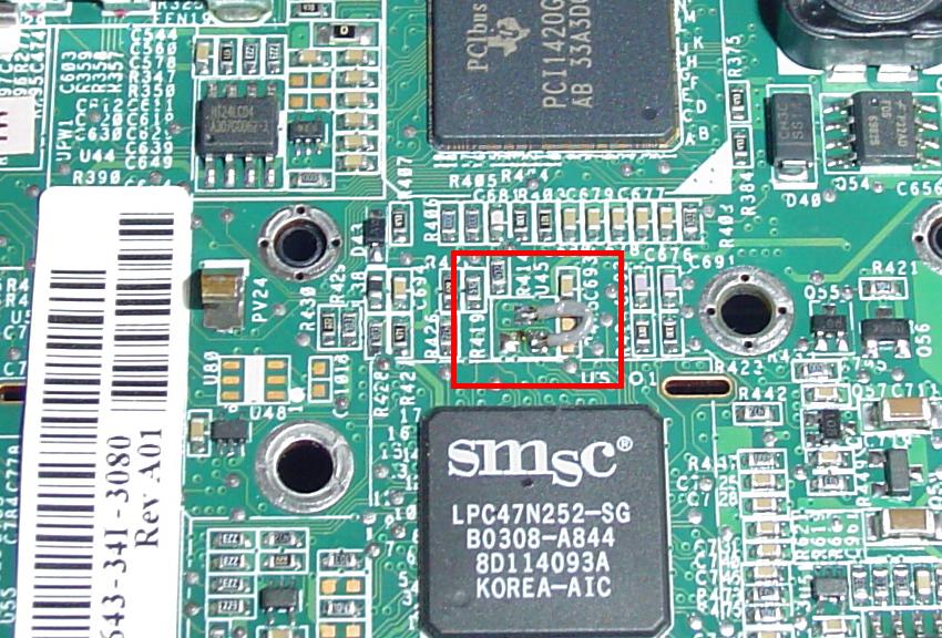

    hello. please help me on this. I have dead dell latitude C640. when i power on it, it is power on just for only 2 seconds. then is gos off. please tel me what can i do.. what i have to check. please response me please.........

        Common problem in that series. Remove laptop apart , find U45 (MAX6326 - 3pin - looks like transistor) that is located near BIOS chip and RAM slots. Unsolder and discard this IC. Short pin 2 and 3 like on the picture attached. Put everything together.

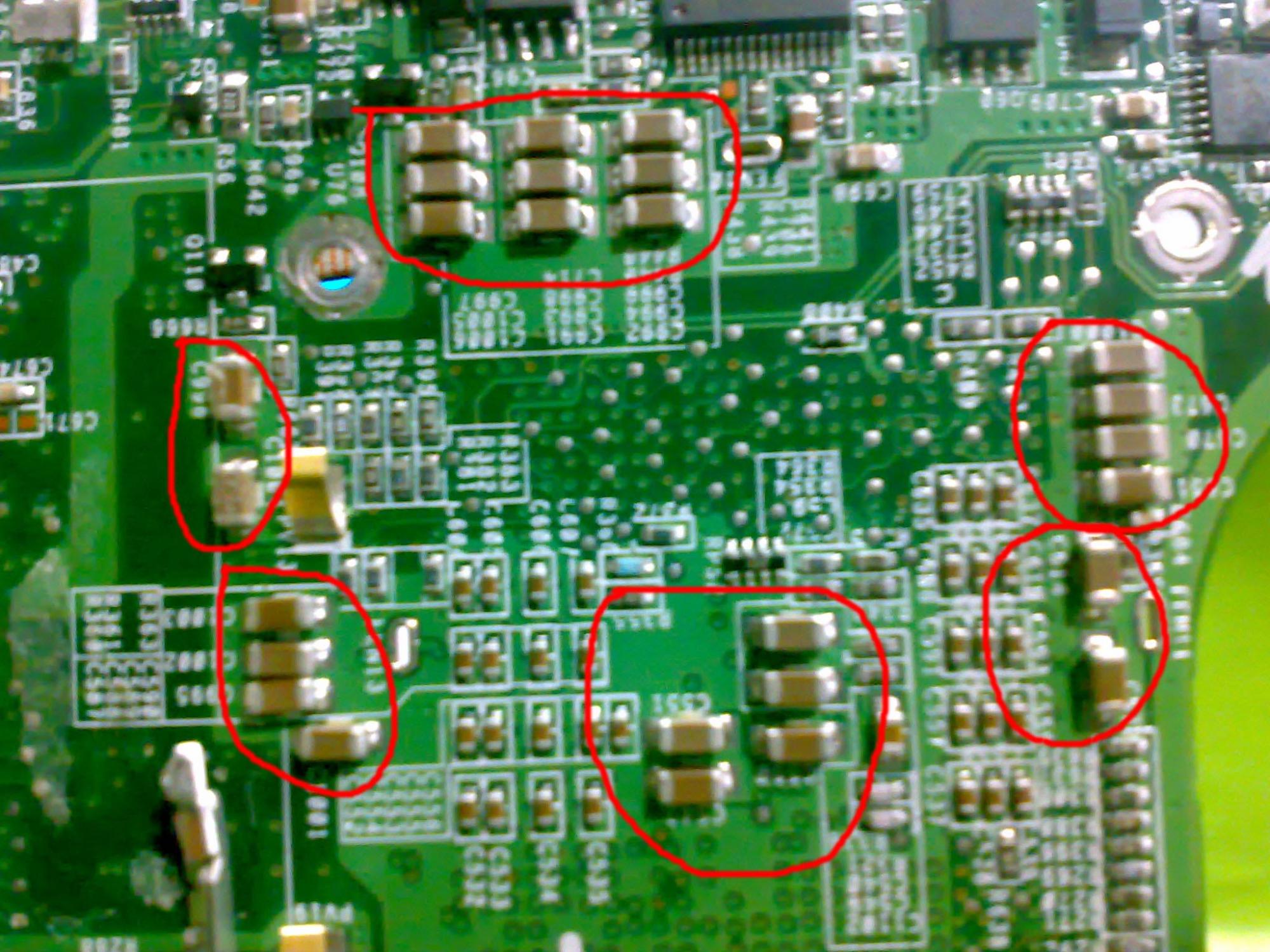

              But it is not working after i have done your method. I have attached a image. All the marked items are showing short circuit when i checked using multimeter.
              What can i do sir? Please reply me soon.

                It's normal for some caps to show short circuit - it depends what they're attached to. If you lift them you'll see that they are fine. If those are the caps in the CPU area, removing the CPU will clear the short. This is normal behavior and the CPU is fine.
                Check the mosfets in all power supplies. CPU, chipset, and so on.
                        Stand up so i can hug you!!! i have a dell c640 p4 laptop also with the same problem and did what u suggested only i didnt use the wire as pictured i only jumped the connection with solder at it is now working!! cant believe that removing a part makes something work?? any idea what that ic does and why it would disable the laptop and removed from board enables it??

                          If you had read the datasheet of MAX6326 you would have understood why. That little IC is responsible for keeping the system powered down if the supply voltage isn't correct. Supposedly, to reduce the likelihood of smoke pouring out. It just sounds like planned obsolescence to me, especially since i've seen several reports of those ICs failing without anything else being wrong.

                              Originally posted by nbanti
                              Thank you for the reply..
                              i found a dell with the same issue , short in ceramic capacitors, all caps are shorted, this is very difficult to find the right one , but just one are bad making the mobo fail to everything , i fix this removing one by one starting from the power plug , after 4 caps i found one shorted and test the mobo without it and it work's perfectly , but weeks later another one cap shorted again , i change all caps and now it's ok

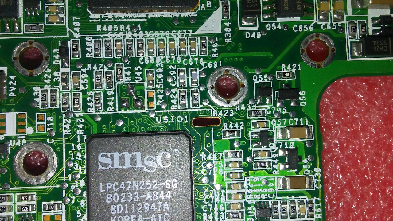

                                  I replaced U45 in my Dell C640 and it worked quite well for a couple of years. Then died again. I presume that U45 is bad once more. What, if any, are the potential negative consequences of shorting the pins (I presume that U45 serves a useful purpose)?
                                    Very old thread, but for anyone else looking at why their C640 has died, this is it! I removed U45 and placed a jumper across it as per instructions and my once dead C640 is running great again. Thanks to original poster for this info!
