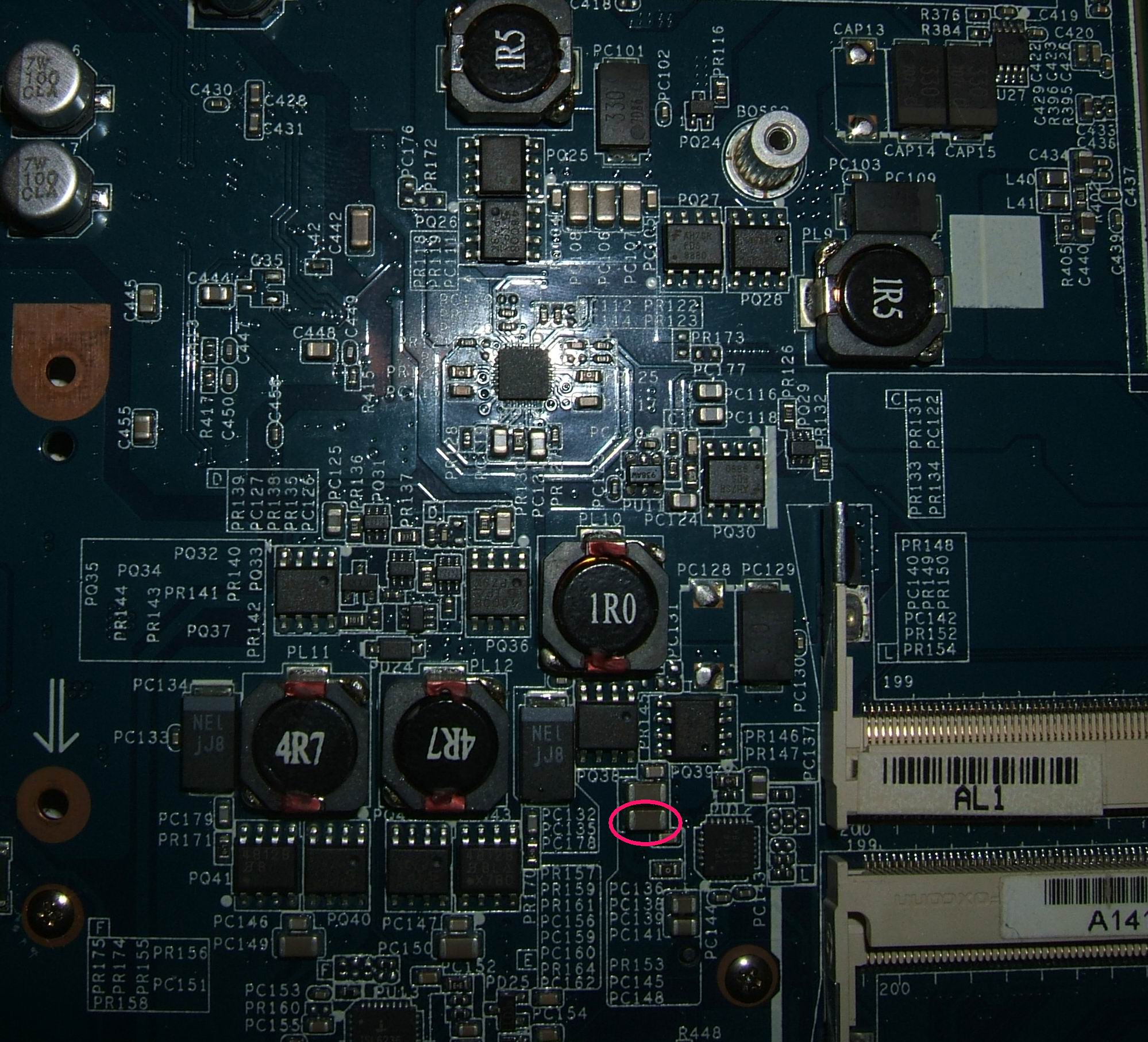

    Got this laptop in for service. It won't show a charge light or turn on. PQ2,PQ3 AO4433 are part of the power on circuit. I see:
    PF1: 19.1v
    PQ3-Drain 19.1v
    PQ3-Source 19v
    PQ3-Gate 19v
    PQ2-Source 19v
    PQ2-Gate 19v
    PQ2-Drain 0v to board power

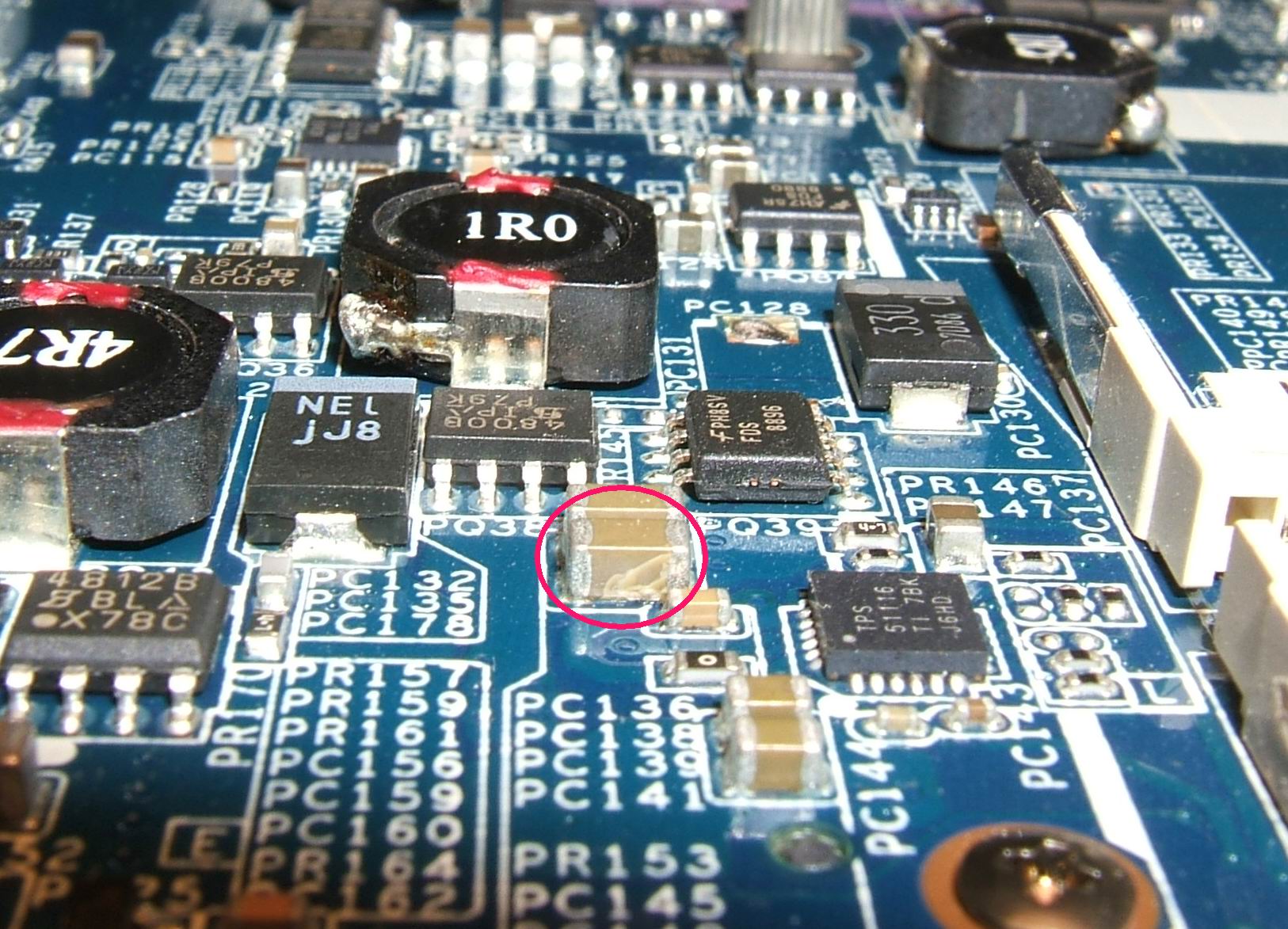

    Power is passing through PQ3 just fine. Power is not passing through PQ2. So I attach my bench supply to PR2. At about 1v PR2 draws about 1.5 amps. Something is shorted. Off goes the bench supply and I remove the CPU since it can look like a short then start to test capacitors. Some tantalums around CAP15 appear to be shorted but the diode voltage drop of 0.025 to 0.050 is is too high so it's probably the supply to the Northbridge U28. Many ceramic caps near and including (but not limited to) PC108, PC138, PC146, PC150 appear shorted with the same diode voltage drop of 0.005 as PR2. Mosfets PQ27 and PQ28 have the same 0.025 voltage drop as the nearby caps so are probably not shorted.
    These shorted parts must be part of the same power plane. So I attach the bench power supply to one of the shorted caps and turn up the power until about 1.2 amps is drawn. I feel around to all the caps I remember to show shorted and any close semiconductor and notice that PC139 is burning hot. PC139 has a visible flaw which looks like a scratch from my probes. I probed many caps and none of them have scratches so the flaw must be internal. Off PC139 comes and now the short is gone.
    The board still won't power up. Adapter connected and the board does nothing when power is pressed. 0.68v is supplied to the many MOSFETS waiting to operate. 5v and 3.3v supplies from PU13 are not powered. 12v to the battery terminals makes the LEDs blink twice green orange when power is pressed. 12v is supplied to many MOSFETS waiting to operate. 5v and 3.3v supplies from PU13 are powered.

    I plug in the adapter and I see that PQ3-gate and PQ2-gate are high so both are turned off. SYSTEM is 0.68v which is unexpected power leaking through some component. If I ground PQ2-gate SYSTEM power at PR2 jumps to 18v so PQ2 works. The BQ24751 has turned PQ2 off/high and it needs to be on/low because the adapter is connected. With PQ2 shorted the laptop refuses to power up and just blinks LED1-Power-Green LED2-Battery-Yellow. This means it knows there's something wrong and is refusing the power SYSTEM through PQ2.
    PVCC 19v from the power adapter shows up several places in the vicinity of PQ4 but no component stands out as defective when comparing voltages with the adapter to voltages with the bench supply hooked to the battery terminals. I don't see any other component that could be damaged by a shorted capacitor in SYSTEM so I'm giving up.
    For no good reason I happened to leave the CMOS battery unplugged all day. Plug it in. Up it powers. Laptop works fine. I didn't see that one coming.

      PC139 was the defective part I removed to fix the board though there's no reason to believe the same cap will be bad on your board. Capacitor failures are random. After the board was fixed the CMOS had stored a fault condition and refused to start up. Pulling the battery erased that.
      Check around the board for shorted tantalum or ceramic capacitors. Tantalum don't show any physical damage. Ceramic do but the one bad one is pretty hard to find in the hundreds of good ones without some hints from shorts on the meter on where to look and verification from the bench supply that it is definitely bad. The largest are the most expensive and the most likely to be an off brand to save money so I start with the largest and work down.
