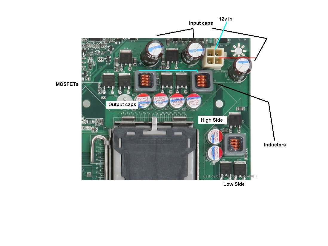

          VRM- Voltage Regulator Module
          Your CPU does not run right from the 12 or 5v from the PS. The VRM is in fact a small buck converter, a switching power supply, that takes the 12 or 5v and converts it to the voltage the CPU requires- 1 to 1.3v for current CPUs.
          On anything remotely recent, the VRM is that group of inductors, MOSFETS, and electrolytic capacitors for this purpose in the immediate vicinity of the CPU. Not all caps by the CPU skt are for it though. Sometimes there's a small cap, like 100u/16 or 25v for the fan. Or even several 1000u/6.3 or 10v for the keyboard, mouse and USB connectors.
          On something like a Pentium MMX 233 or older, the VRM is diminutive. One high side MOSFET, sometimes just a large schottky diode in lieu of a low side MOSFET for synchronous rectification, one toroidal inductor for the buckverter proper, and a little ferrite bead-on-a-lead for the isolation choke. Only three or four caps.

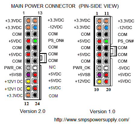

          Ohming out the various pins on the power connector can be misleading- you may have several tens to several thousands of ohms from various power pins to various ground pins on a functioning system. Things like pullup and biasing resistors can give you a false indication of a fault. What I suggest is checking all supply pins on your board's ATX connector to a ground on the board- be it the mouse/kb shield or the ground pins on the ATX connector.
          What you'd do is stick the black probe to one of the commons in the diagram, then touch the red probe to all others except common/gnd.
          In other words (20 pin as example) test from:
          Use 'continuity check'
          Black: 3
          Red (move from):1, 2, 4, 6, 8, 9, 10, 11, 12, 14, 18, 19, 20
          You are only looking for a dead short- 0 ohms. Touch your test leads together, the reading should be very close to 0. If you get something like 2.4 ohms with test leads shorted and the reading varies when you flex the leads, they may be starting to break inside their insulation. Sometimes, just the jacks get dirty- a shot of DeOxIt or CRC's 2-26 will take care of that.
          Once you have determined that your meter will read 0 or even .2-.3 ohms with leads shorted, go ahead and test those pins as in my example.
          Be aware that if anything was shorted to ground, the power supply will shut down if it's a good one or blow up if it's not so good.
