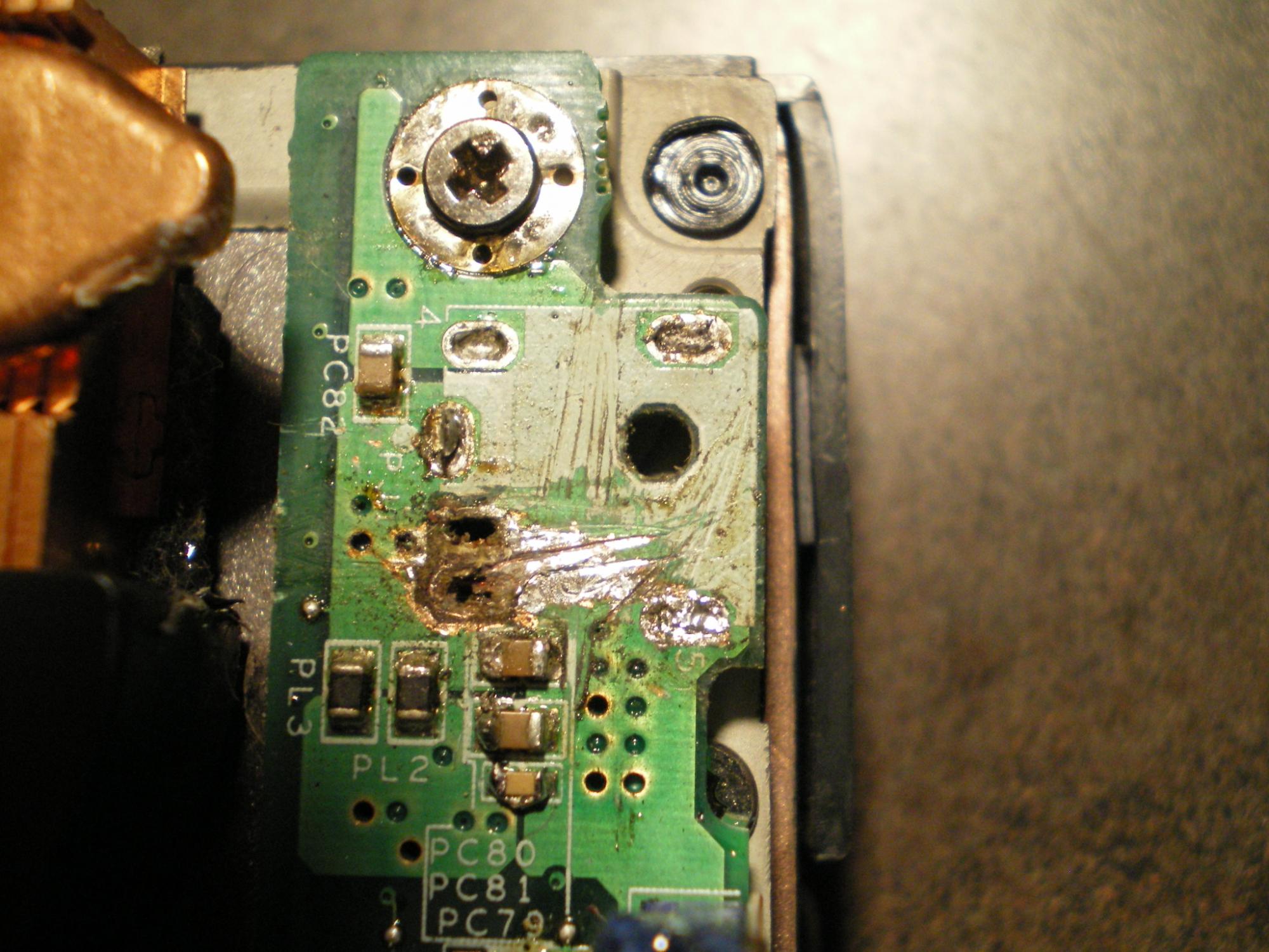

Acer aspire 3000 broken power jack
  • hpaca509
    • Aug 2010
    • 76
    Acer aspire 3000 broken power jack
    I was working on getting a new power jack on my laptop no problem. When I got to soldering my pins and finished my ac power cord makes a whinning noise like the positive and negative are touch. I bought some solder remover at radio shack. The pics show how much I was able to take off. I also tried grounding to one of the screws on the board and still makes the sound. Will I need a new board or is the still fixable?
    Thank you.
  • hpaca509
    • Aug 2010
    • 76
    Re: Acer aspire 3000 broken power jack
    sorry forgot the picture. It's a nasty one.
    • Toasty
      • Jul 2007
      • 4171
      Re: Acer aspire 3000 broken power jack
      You have a solder bridge across PC79. The bottom little cap.
      veritas odium parit
      • jetadm123
        • 2169
        Re: Acer aspire 3000 broken power jack
        Wow, it looks pretty bad! These circuit boards are multi-layered, which means there are copper traces running between the layers. You may have shorted it out while trying to pull the old socket out. One way to check for shorts is with your Digital Multi Meter (DMM). Set the meter to resistance. Touch red probe to the positive pad on the circuit board and the black probe to the negative (ground) pad. If it shows less than 0.5 ohms, you have a short. If it is shorted, you will probably have to buy another board.
        • Toasty
          • Jul 2007
          • 4171
          Re: Acer aspire 3000 broken power jack
          Yes, it looks well butchered, but fix the -obvious- problem and see.
          veritas odium parit
          • jetadm123
            • 2169
            Re: Acer aspire 3000 broken power jack
            Sorry Toasty, but I didn't see your earlier post (guess I was too shocked by the photo!). Yes, definately fix that solder bridge first before going on.
            • romansroad
              • 123
              Re: Acer aspire 3000 broken power jack
              to the OP, I just learned that not everyone here has the right tools sometimes. This board looks like you had to rock the DC jack out. Perhaps your iron doesn't have enough heat? This part and the PCB it attaches to are pretty good heatsinks.....make sure you've got an iron that gets hot enough. Just sayin'.....
              • hpaca509
                • Aug 2010
                • 76
                Re: Acer aspire 3000 broken power jack
                Thanks for the input. I was focusing to much on the jack. I replace the little cap 79 and turned right on. i was able to but a soldering gun. station for 30 bucks. Which works better then the 7.00 soldering iron from fred meyer. lol
                • hpaca509
                  • Aug 2010
                  • 76
                  Re: Acer aspire 3000 broken power jack
                  Ok so now I got the thing to turn on. Now I am at the login page. How can I bypass the administrator password. I've tried contol+alt+delete and it still asks for passwork even when left blank. Safe mode doesnt work either.
                  • Toasty
                    • Jul 2007
                    • 4171
                    Re: Acer aspire 3000 broken power jack
                    Worked for me on a Win 7 lockout:
                    http://www.pogostick.net/~pnh/ntpasswd/
                    in thread:
                    https://www.badcaps.net/forum/showthread.php?t=11912
                    Toast
                    veritas odium parit
                    • hpaca509
                      • Aug 2010
                      • 76
                      Re: Acer aspire 3000 broken power jack
                      oh tried that and didnt work. now the keyboard and sensor mouse doesnt work. please help.
                      • Toasty
                        • Jul 2007
                        • 4171
                        Re: Acer aspire 3000 broken power jack
                        ?? What happened between the 2 posts? It was working now it's not? You might have a loose cable connection.
                        You're not following the instructions on that program. Step by step and there is a guide out there too for it.
                        veritas odium parit
                        • hpaca509
                          • Aug 2010
                          • 76
                          Re: Acer aspire 3000 broken power jack
                          the computer is fine. In the website for the file it state on FAQ that when you install cd it can make mouse and keyboard not work. It also states that there is no fix for it.
                          When I downloaded the file into my working computer I unzipped the file and then burned onto a disc then set the bios to load cd rom firs then hdd. It should load it up from there correct. However it doesn't load the disk.
                          • hpaca509
                            • Aug 2010
                            • 76
                            Re: Acer aspire 3000 broken power jack
                            I can still control mouse sensor and key board unitll I get to the log on screen. That when it all freezes. I can still get to the f2 menu and control all of those things. If this doesn't workd is there anyway to just do a system restore without the recovery discs. I know on my dell you push ctrl and f10 I think and it gives you the restore menu
                            • Th3_uN1Qu3
                              Believe in
                              • Jul 2010
                              • 6031
                              • Romania
                              Re: Acer aspire 3000 broken power jack
                              Well, you have a CD? I'd just reinstall the whole thing. Take out the drive, put it in your desktop computer (buy an adapter if it's IDE, if it's SATA it'll work without one), back up all data, then reinstall Windows.
                              A working TV? How boring!
                              • Toasty
                                • Jul 2007
                                • 4171
                                Re: Acer aspire 3000 broken power jack
                                None of the other accounts on the machine work?
                                Try the other software that was mentioned in the thread, PC Login Now :
                                Guide: http://pcsupport.about.com/od/toolso...pcloginnow.htm
                                Sourceforge Site: http://sourceforge.net/projects/pcloginnow/
                                Also another is Ophcrack:
                                Guide: http://pcsupport.about.com/od/toolso...r/ophcrack.htm
                                Sourceforge Site: http://ophcrack.sourceforge.net/
                                Your Google works as well as mine. Use it.
                                Toast
                                veritas odium parit
                                • hpaca509
                                  • Aug 2010
                                  • 76
                                  Re: Acer aspire 3000 broken power jack
                                  Hello I re-read instructions and figured out the right way to copy iso. I can now access the administrator file. Thank you for your help and patience. I plan on giving this to my mother in-law. Is there any way of restoring this Acer Aspire 3000 to original settings? With out any discs. I know on my dell it's f11 or something like that.
                                  • Toasty
                                    • Jul 2007
                                    • 4171
                                    Re: Acer aspire 3000 broken power jack
                                    By "original settings" do you mean the BIOS default settings or a complete reinstall of Windows. It may be accessible via a boot option, such as the Dell, or it may be in the BIOS setup screen(s). It would need to have the "hidden" partition on the hard drive to work.
                                    Check the Acer website on this model. Instructions and support should be there. User manuals are generally available.
                                    Toast
                                    veritas odium parit
                                      ACER Aspire Aspire E560 Aspire E6400 Specification for Upgrade or Repair
                                      This specification for the ACER Aspire Aspire E560 can be useful for upgrading or repairing a desktop PC that is not working. As a community we are working through our specifications to add valuable data like the Aspire Aspire E560 boardview and Aspire Aspire E560 schematic. Our users have donated over 1 million documents which are being added to the site. This page will be updated soon with additional information. Alternatively you can request additional help from our users directly on the relevant badcaps forum. Please note that we offer no warranties that any specification, datasheet, or download...
                                      09-12-2024, 03:28 PM
                                      ACER Aspire Aspire E700 Aspire E6300 Specification for Upgrade or Repair
                                      This specification for the ACER Aspire Aspire E700 can be useful for upgrading or repairing a desktop PC that is not working. As a community we are working through our specifications to add valuable data like the Aspire Aspire E700 boardview and Aspire Aspire E700 schematic. Our users have donated over 1 million documents which are being added to the site. This page will be updated soon with additional information. Alternatively you can request additional help from our users directly on the relevant badcaps forum. Please note that we offer no warranties that any specification, datasheet, or download...
                                      09-12-2024, 02:30 PM
                                      ACER Aspire Aspire M7711 Aspire Q9300 Specification for Upgrade or Repair
                                      This specification for the ACER Aspire Aspire M7711 can be useful for upgrading or repairing a desktop PC that is not working. As a community we are working through our specifications to add valuable data like the Aspire Aspire M7711 boardview and Aspire Aspire M7711 schematic. Our users have donated over 1 million documents which are being added to the site. This page will be updated soon with additional information. Alternatively you can request additional help from our users directly on the relevant badcaps forum. Please note that we offer no warranties that any specification, datasheet, or...
                                      09-12-2024, 03:28 PM
                                      ACER Aspire Aspire G7200 Predator Defender Aspire 9750 Specification for Upgrade or Repair
                                      This specification for the ACER Aspire Aspire G7200 Predator Defender can be useful for upgrading or repairing a desktop PC that is not working. As a community we are working through our specifications to add valuable data like the Aspire Aspire G7200 Predator Defender boardview and Aspire Aspire G7200 Predator Defender schematic. Our users have donated over 1 million documents which are being added to the site. This page will be updated soon with additional information. Alternatively you can request additional help from our users directly on the relevant badcaps forum. Please note that we offer...
                                      09-12-2024, 03:28 PM
                                      ACER Aspire Aspire M7200 Aspire 805 Specification for Upgrade or Repair
                                      This specification for the ACER Aspire Aspire M7200 can be useful for upgrading or repairing a desktop PC that is not working. As a community we are working through our specifications to add valuable data like the Aspire Aspire M7200 boardview and Aspire Aspire M7200 schematic. Our users have donated over 1 million documents which are being added to the site. This page will be updated soon with additional information. Alternatively you can request additional help from our users directly on the relevant badcaps forum. Please note that we offer no warranties that any specification, datasheet, or...
                                      09-12-2024, 03:28 PM
