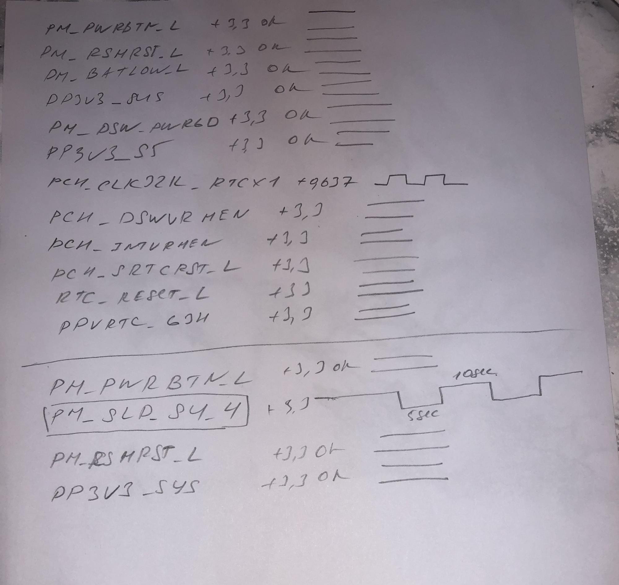

    It have had a problem with U7100 and short circuit in Q7130.
    I replaced them.
    It starts now and waiting 20 seconds and then starts to reset PM_SLP_S4_L every 10 seconds.
    Almost all voltages rising
    except U3090 and U3210 (LED) - not receives enable signal.
    U4500 is trying to rise - receives enable only 2-3 seconds
    Here is my measuring of important signals.
    What else could be the problem?
    I need to help.
    Thank you an advance.

    Re: Macbook A1466 820-00165 resets every 10 seconds
    https://repair.wiki/w/A1466_2015-201...9D_MacBook_Air
    Review the voltages to ground on the SPI flash device.
      Thank you for the link!
      I can observe SPI exchanging.
      To be sure I have put a new dump from here.
        Try with SMC bypass.
        Update:
        https://logi.wiki/index.php/820-00165_Pulsing
          Originally posted by mon2
          Yes, I have tried to start it in SMC bypass mode - nothing
          I passed step but step this guide - nothing

            Hi.
            I have manage to find the problem.
            In my case missed exchange between CPU and U7200.
            CPU_VIDSCLK
            CPU_VIDSOUT
            These lines have 1V, but without any commands from CPU.
            CPU_VR_READY was high.
            I cleaned the main in a ultrasound bath and reflowed then the processor.
            Main starts.
            However I must reball the processor.
            Thank you everyone.
