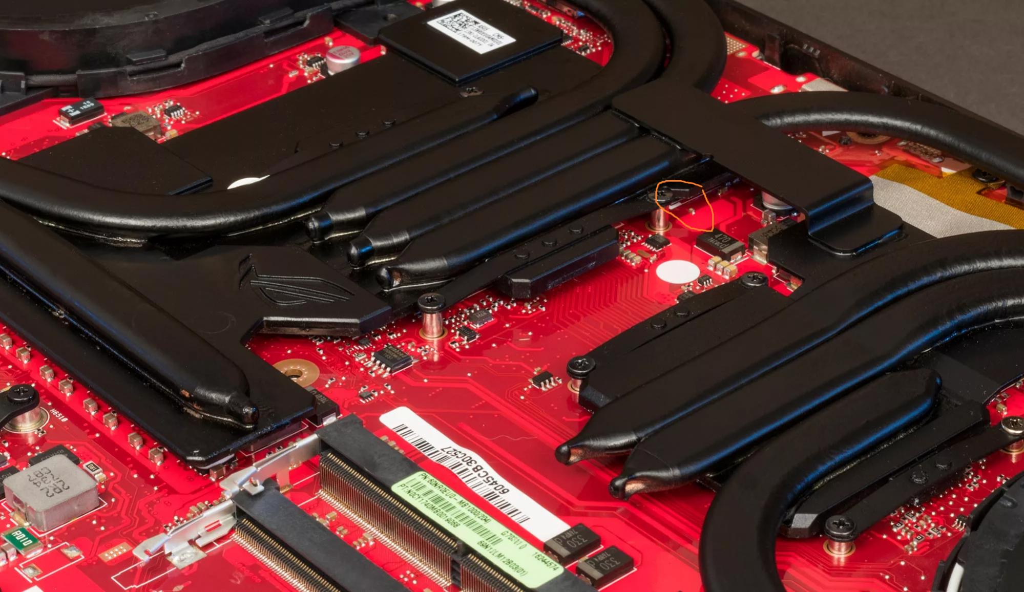

    Hello everyone!! I bought a laptop, I was hoping to fix, but it's not so easy, they have broken some different components or rather, some components are missing can someone help me identify the circled resistor on picture no. 1? Or is that a stupid question? It's probably not possible to identify from a picture?
    They have also destroyed the connector for the monitor, but I have found a new one, but as you can see in the second picture, they have broken off a few more components just below the connector as well, so it will probably be difficult to fix this motherboard?!
    Image no. 3 is as it looks on image no. 1 on my motherboard
    I can't find any boardview for this model! Or does anyone know where to find one?
    Thanks in advance!!!

    The single component looks like a capacitor. You may just leave it out. At least one of the ripped components near the LCD connector could be a inductor which connects the Main power rail with the display. You need to check with the multimeter where the bottom right track connects to. If itnis the main power rail, then we should be on the right track. For the top component in have no idea right now...
