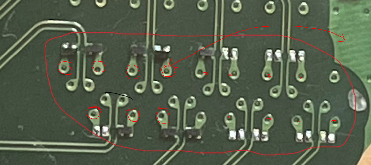

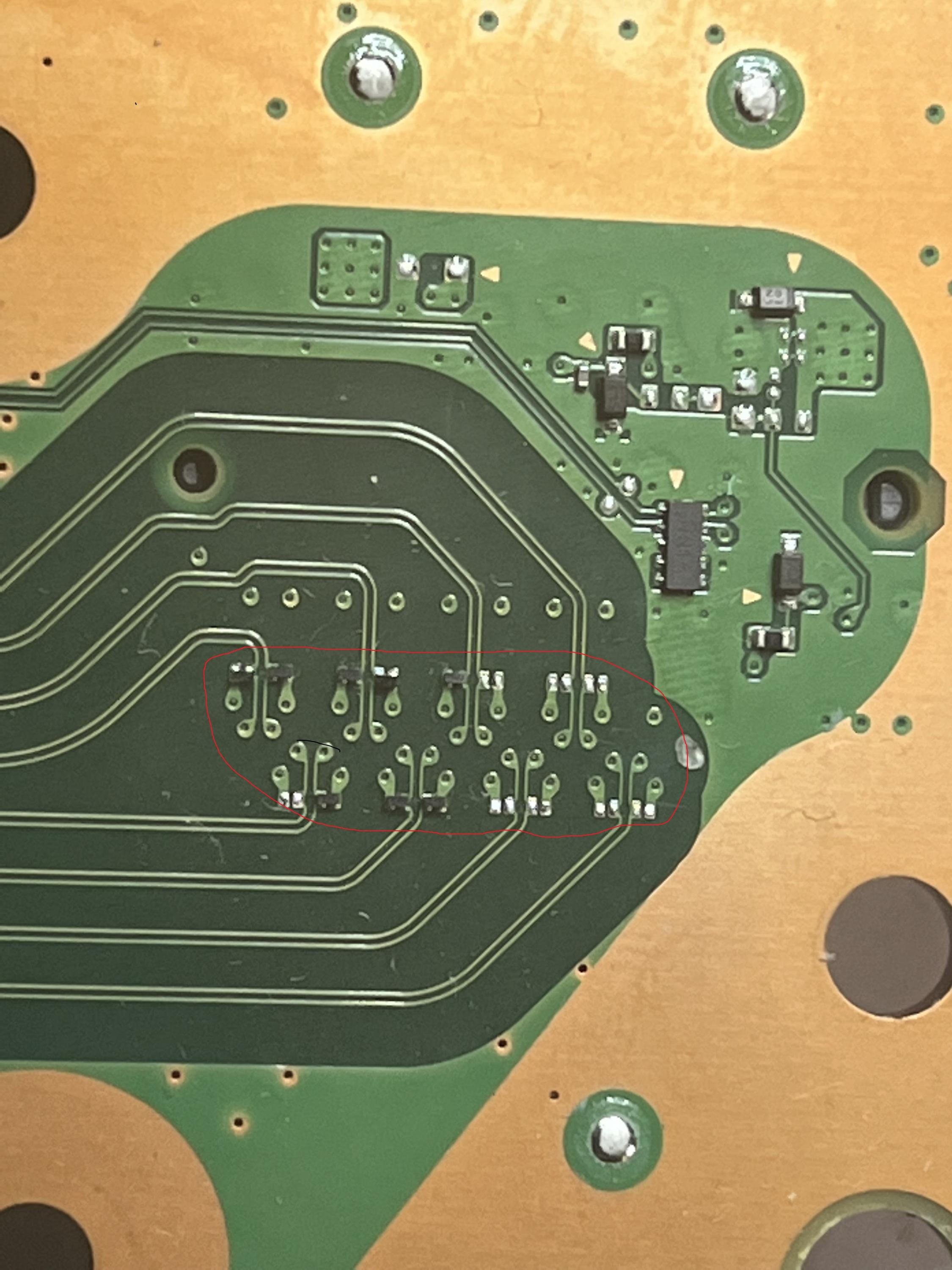

    There is a playstation 5 that i'm servicing and it was DOA until i replaced the southbridge. Now it will power on and display for a split second and then beep 3 times and shutdown. I was told that this was SSD related and I noticed some missing components in the ssd circuit but I'm not sure if they're diodes and if they may be the cause of the issue

    esd protection diodes?

      Or inductors, how do they measure with a meter ?

        If these pins are connected to GND, then these are yes esd protection diodes or zener diodes.
        It can work without them, the main thing is that the rest that remain are not in a breakdown (in a short circuit).
