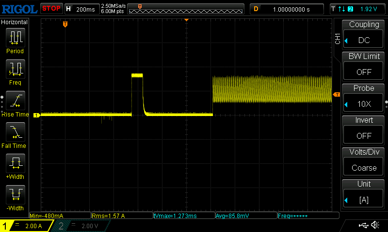

    Hello
    I have this behavior on the 3V rail (PL101 capacitors side) (See attached image and Boardview).
    -I thought it was the 3V IC and I changed it and it's still the same.(PU101)
    -I injected 3V into the 3V coil and the PCH got hot (very slightly, 170mA). I removed US4 and the 3V power rail stabilized (3.3V stable) so I changed the PCH but it's still the same after replacing PCH. (Also replaced US4)
    -The enable of the 3V rail (3VS5EN) is following that pattern to.
    -The 3V LDO (+3VPCU) is stable.
    -I measure the KBC power voltages and non of them have the same behavior.
    Any recommendation? Thanks

    Re: HP Omen 15 DAG3DBMB8D0 strange 3V power rail
    The osciloscope yellow channel shows 2A per division but its actually 2V...
